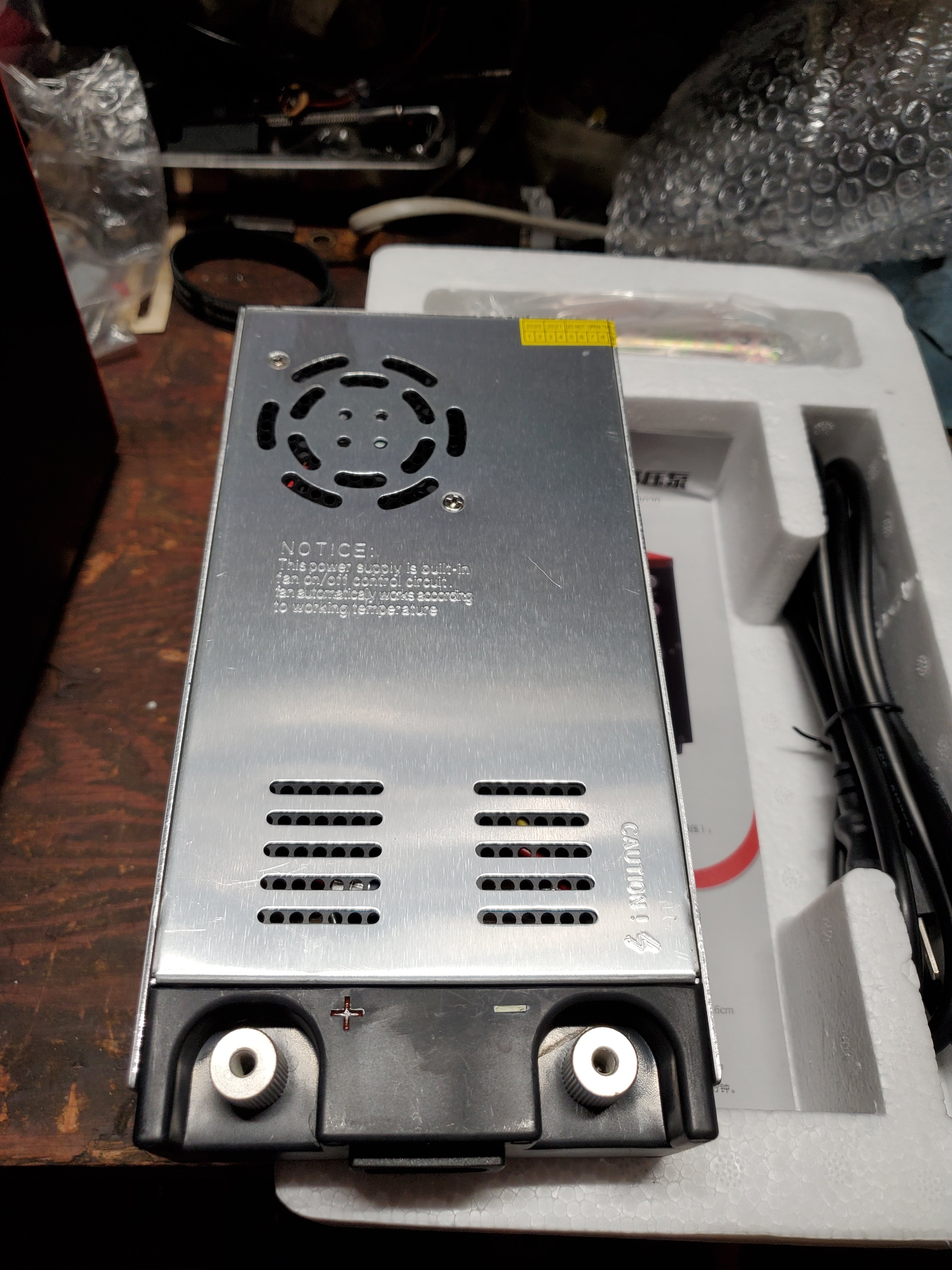

OK, that’s good to know. It just stopped working. It was plugged directly into the wall no fan know anything.
I bought this thing on Amazon Black Friday and yesterday the power inverter went out. I haven’t been super impressed with the set up anyways. Has anybody tried anything else that’s a little more convenient maybe like a battery booster for a car or something like that?
Try using a deep cycle marine battery for trolling motors
Did the outlet stop working? Troubleshoot 101.
Are the wires connected securely?
Did the power supply stop, or did the pump stop?
Is it still not working (did you unplug, turn off, switch to a different wall socket and try again?)
Did you try the pump directly off your car battery?
I plugged it in. It turned on. I had the relief valve open. I turned the compressor on. It. Ran for about three seconds and turned off. No power no fan. I unplugged. It went to a different outlet that I tested and it still didn’t work.
There is a thread somewhere here where someone found some burnt out electrical parts on the inside and was able to fix it. Just in case yours eventually dies. I actually really like the external supply setup. I look at that converter as a disposable commodity. If it dies just trash it and order another one. No tearing into the compressor. Mine has been going over two years.
Reactions: JackHughs
Home from work today and was planning on taking it apart to see if I could see a loose wire or something. Maybe check the power supply cord. And a damn thing works. I plugged it into the exact same plug in the house filled up my air gun it’s been running for about a half hour now
Many devices have thermal fuses ("polyfuses"), so once it cooled off it may have reset itself.
