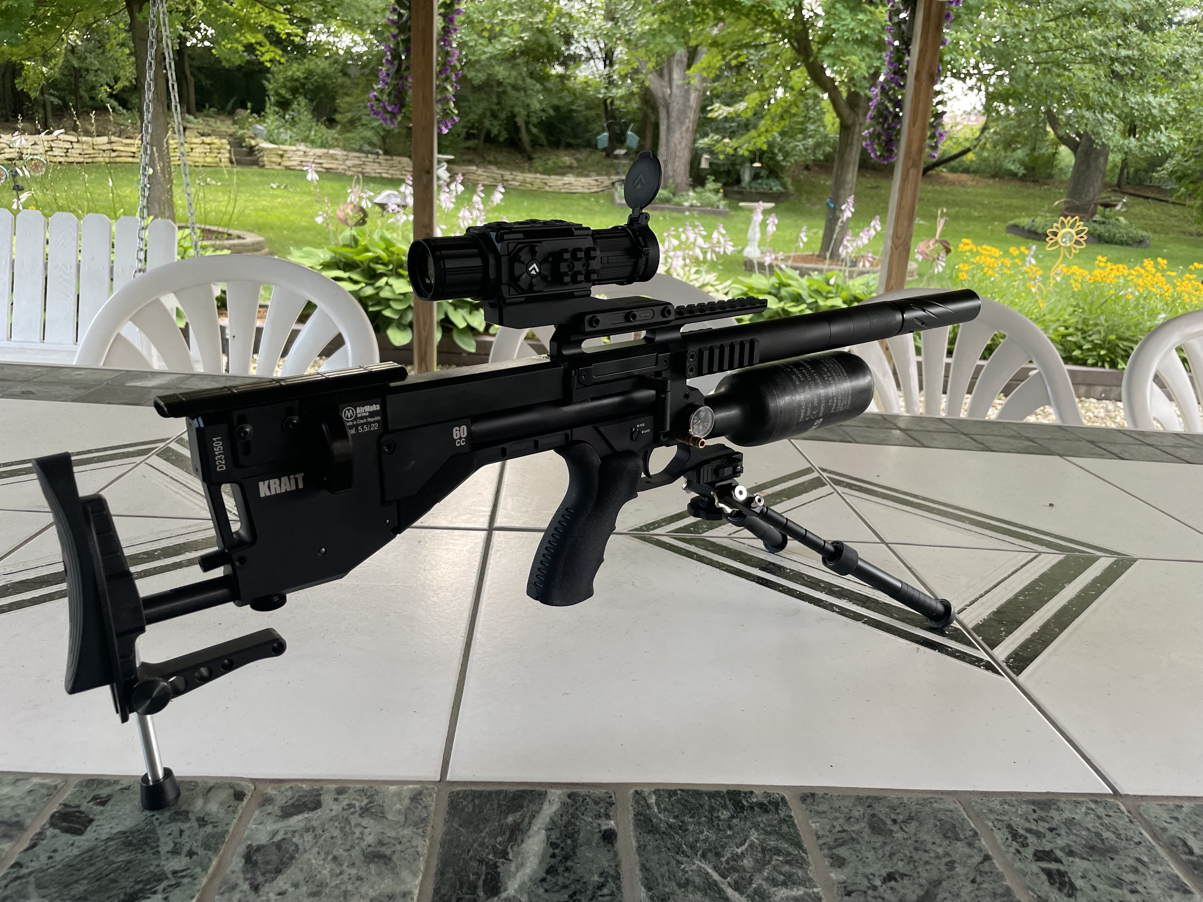

I’m just showing off my month old Krait 22.

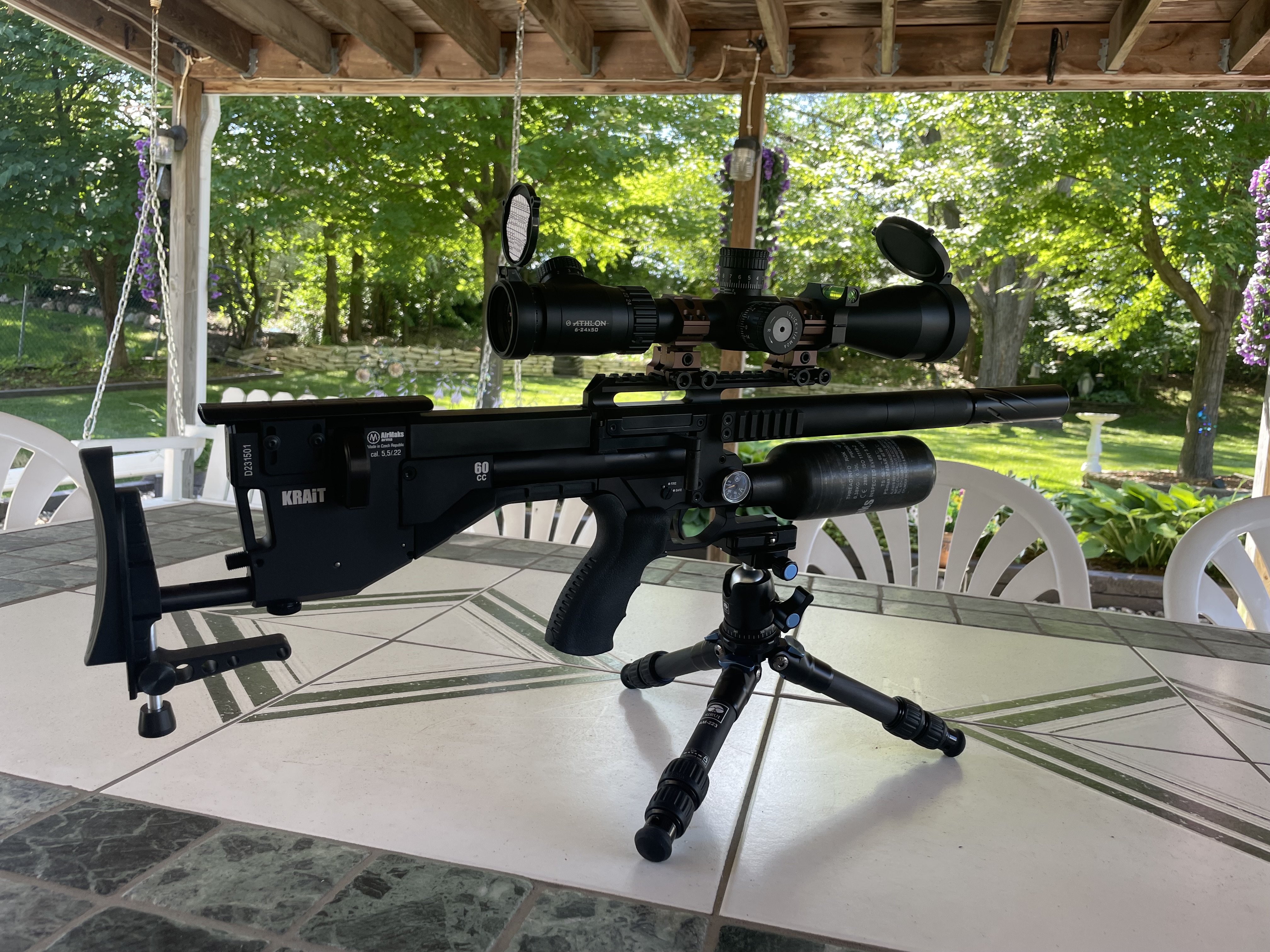

I had a cheap bipod with too much leg play on it and just remembered I had this nice little tripod.
I don’t find many threads on these. Have shot it much? we Would love a detailed review if you can.
