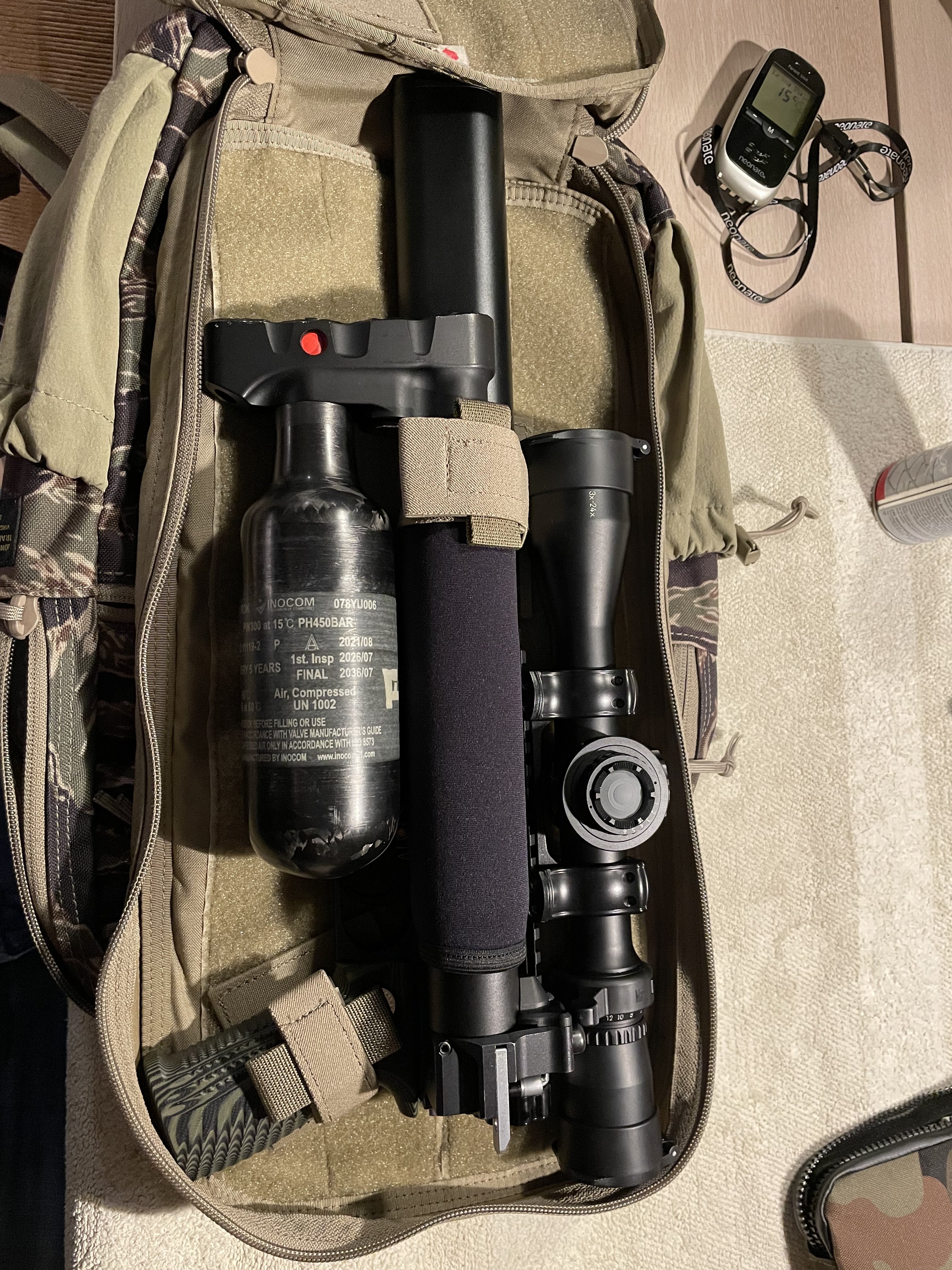

I have a Hawke Vantage 3-9×50. It's been on 4 centerfire rifles and now rests on my beeman commander. (Hopefully not for too much longer) I've shot with some wicked nice scopes before but I feel like once you start getting above a certain price point theres just too much diminishing return to warrant it, at least for me. But then again I rarely shoot distances where a super high end scope is going to make a difference.
I must confess, I got caught up in the equipment race... currently using a Sightron 10-50X, my backup is a Falcon 10-50X
For BR 50 and 100 meters my primary scope is a Falcon X50, SFP.
For variable distances 20-40-60-75-100 yards games I used the Nikko 8-32x60 Nighteater, the IQ is average the parallax is precise but the turret clicks getting aged, and I better retire this scope soon.
Now I must say I don't like the FFP at all, I hate when the reticle magnifies, but maybe this is a way to save the turret clicks.
Sightron ? or Falcon again?
or maybe get a new fixed lens for BR and re-use the Falcon for multiple distances?
