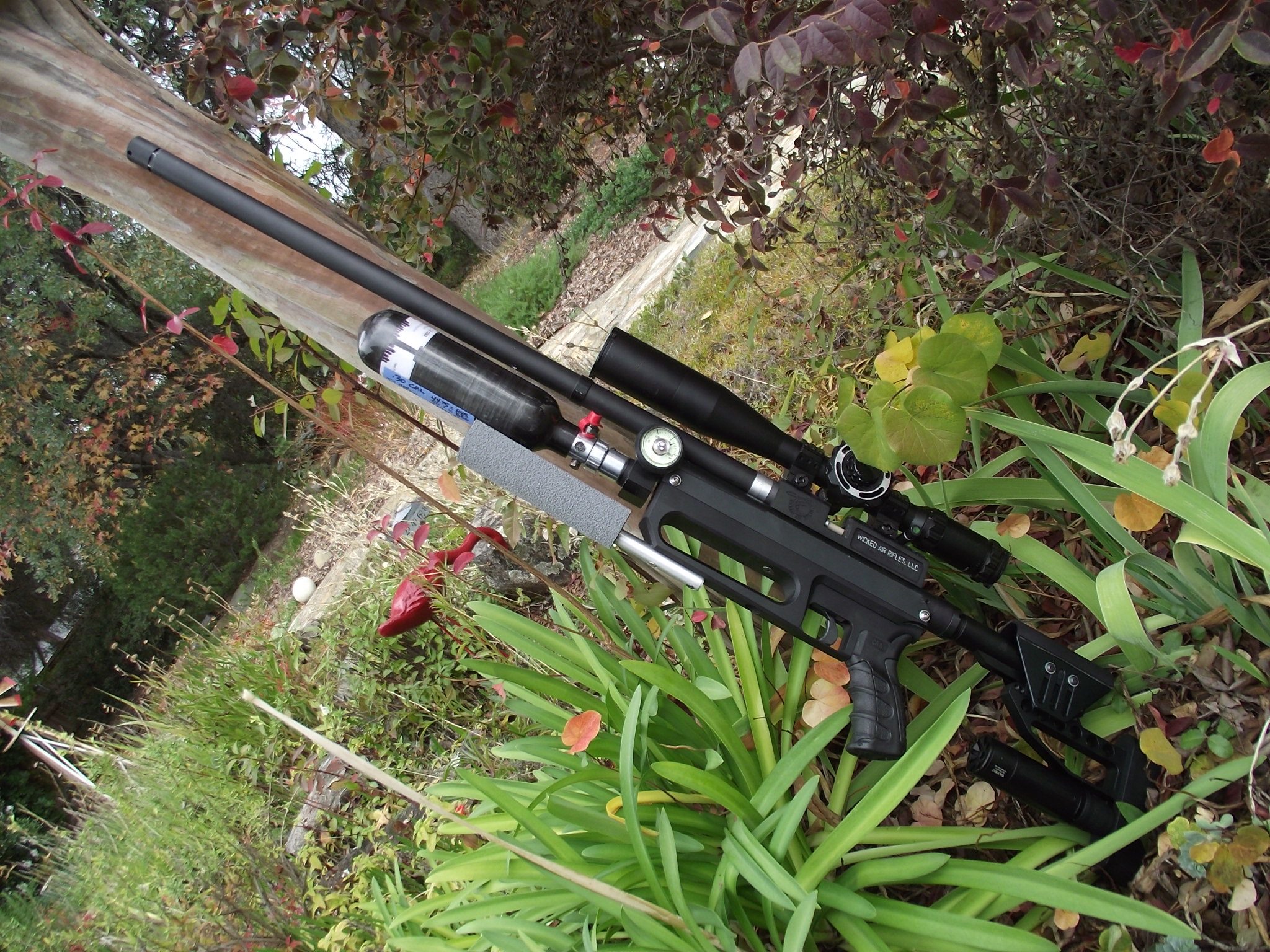

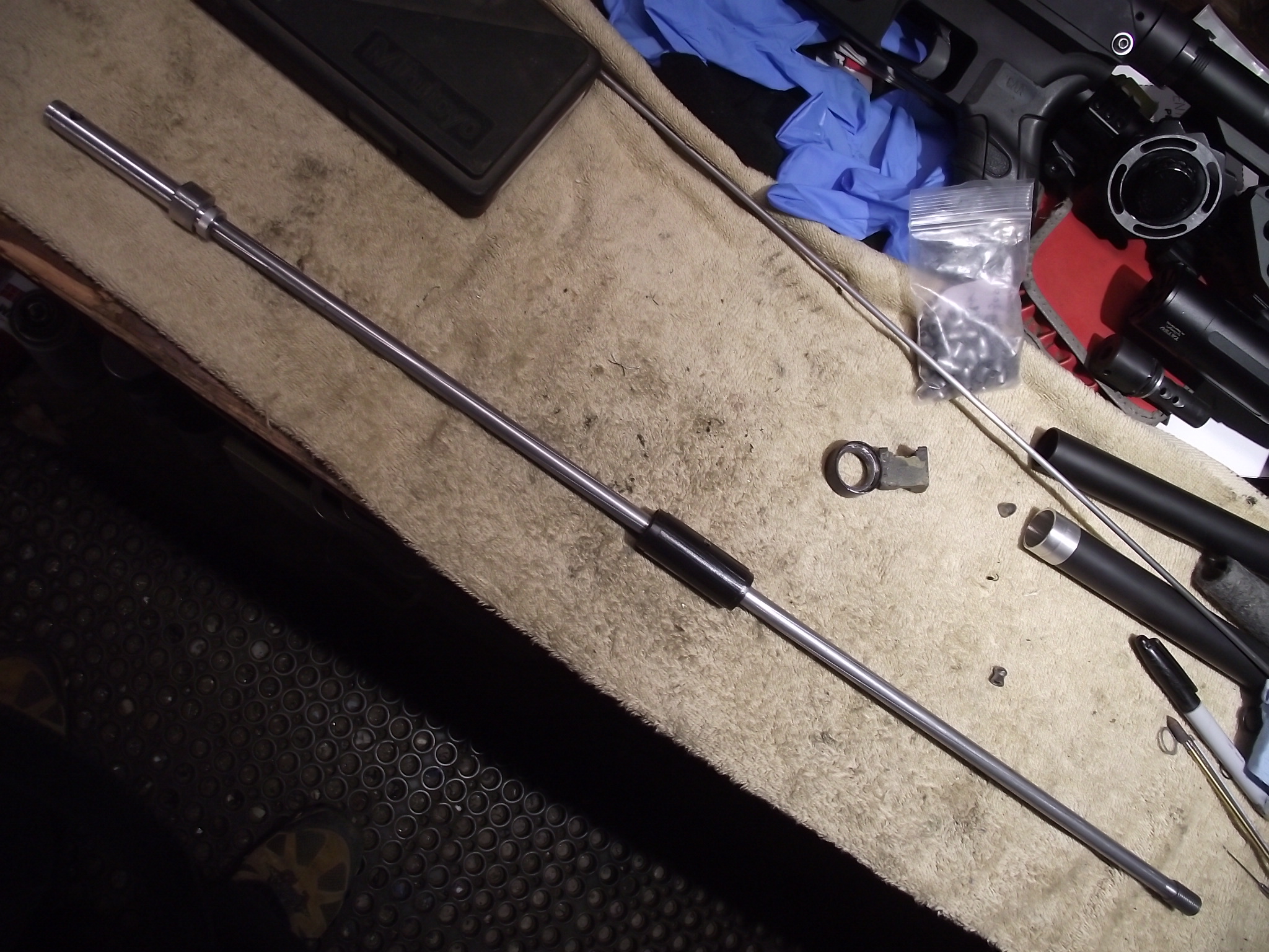

Yup ... 700mm in .30 cal into a WAR Flex. Fully stretch tensioned and damn accurate too !!
