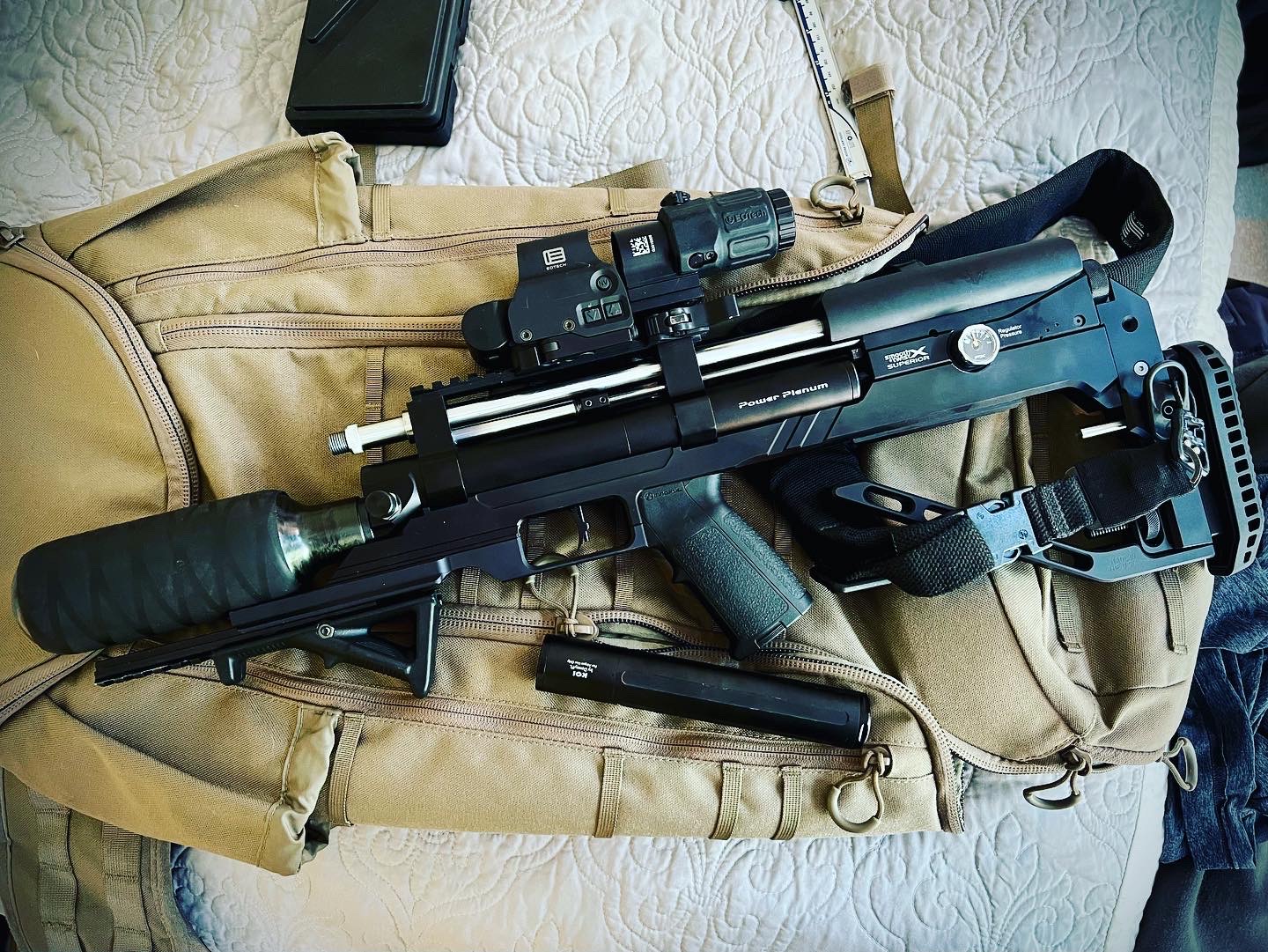

This is a very special custom rifle from my personal collection that will make someone very happy. It was a labor of love that I spent a lot of time on to perfect. My goal with this build was to make the rifle reliable, bulletproof, and as accurate as I possibly could with both pellets and heavier high BC slugs for field hunting, NRL22 / PRS, and benchrest. The results on paper speak for itself. Example 13 shot group at 50m through a scope cam:
Every part that I machined and fabricated from scratch use the highest quality materials that I could source, all of which contribute to the performance of this rifle. The build history was captured in several different posts on AGN and Instagram, but I'll try and recap some of the functional upgrades that I made for it.

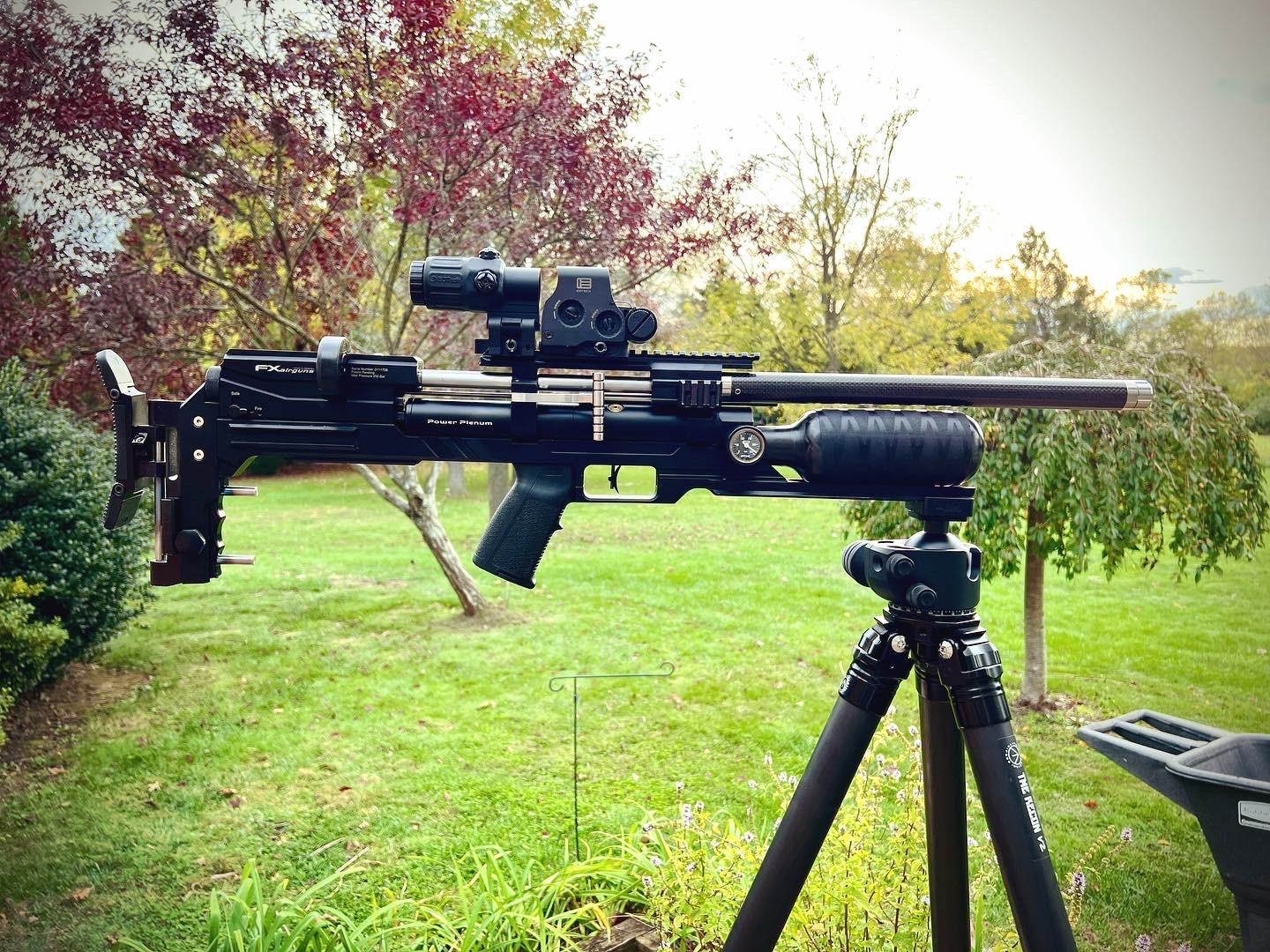

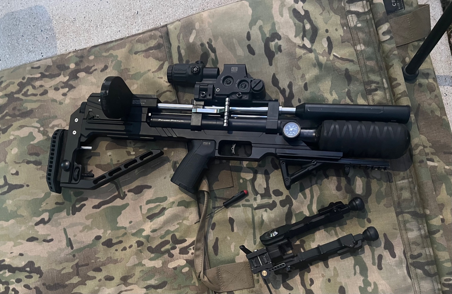

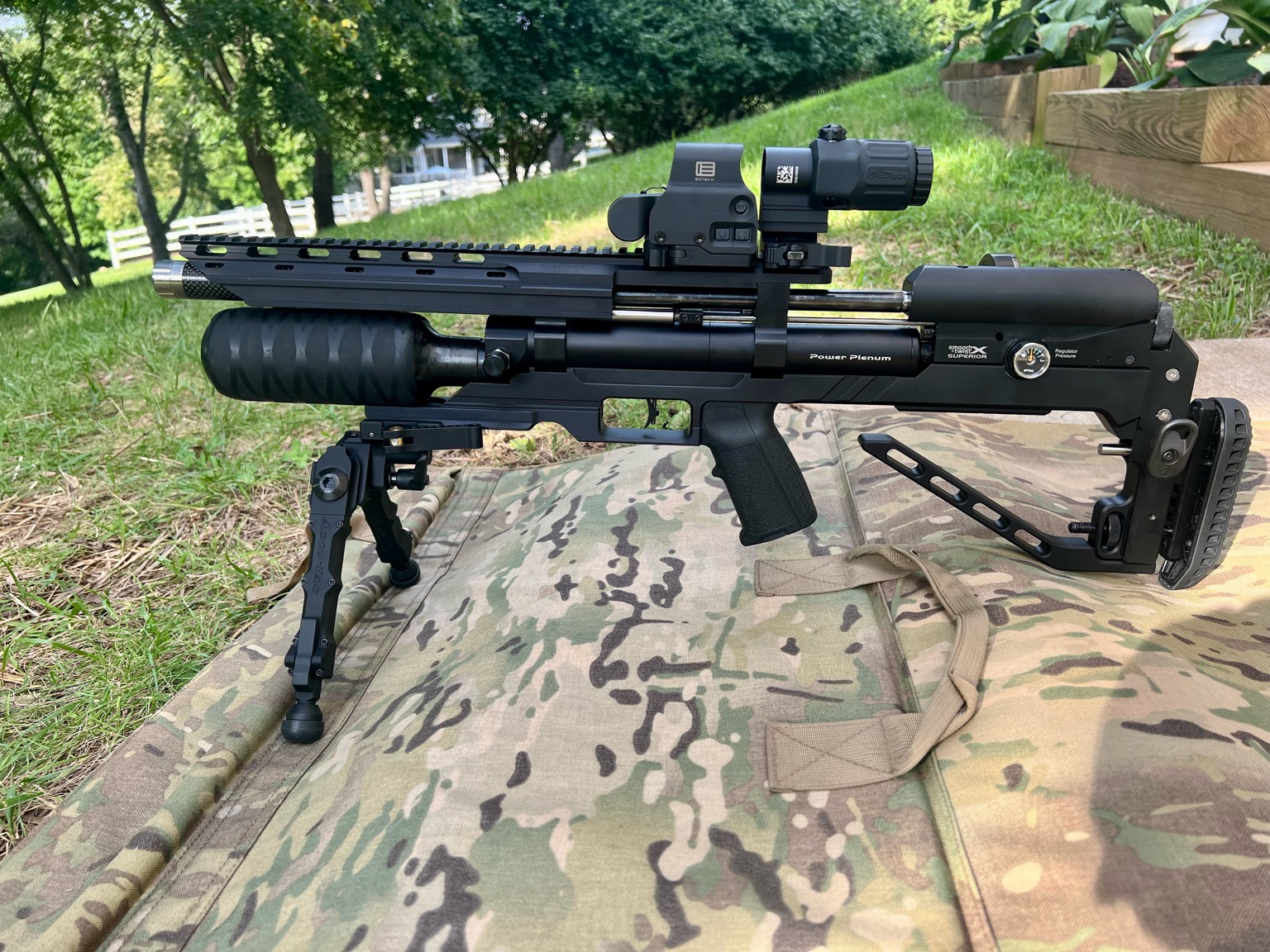

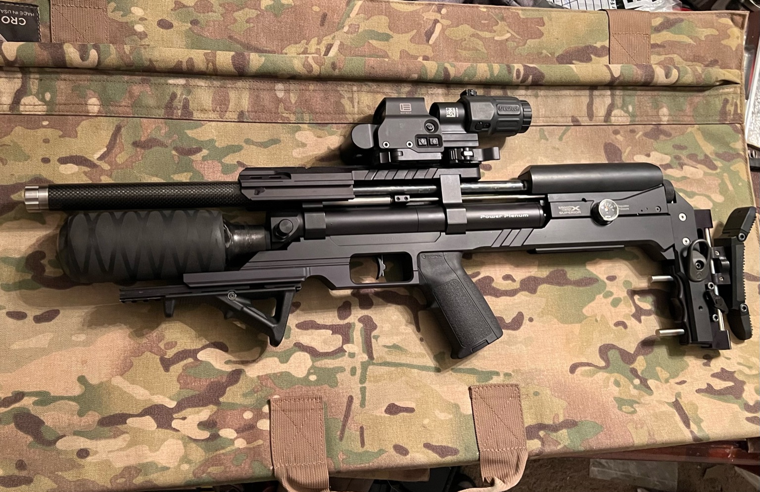

FX Maverick .30cal
- Kraford & Lypt KL-MAV chassis - Comes with both the Compact Arca Swiss rail and a longer modified Sniper Arca Swiss rail. I also have multiple long and short K&L Picatinny T-slot rail inserts for them to run Picatinny/Weaver bipods and hardware.

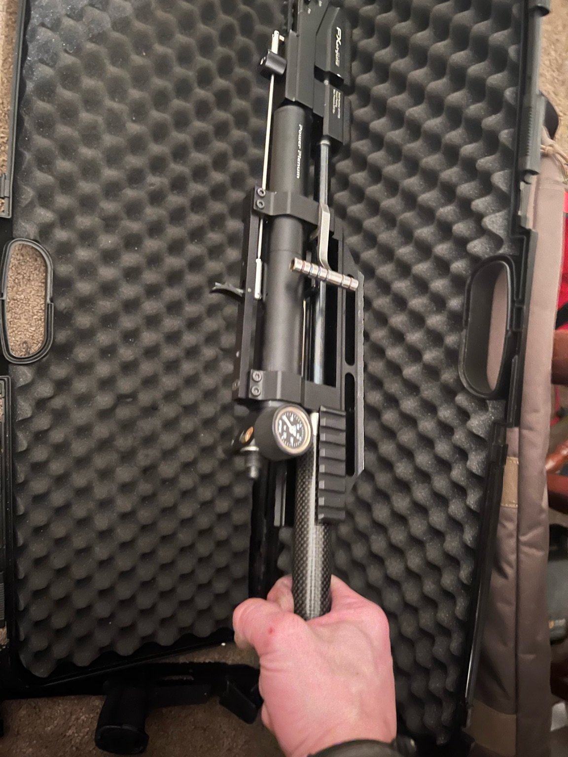

- KLS-2 stock with titanium posts - Much lighter with the 6AL-4V titanium rods. This is the best stock IME for the Maverick as it allows for the shouldering point to raise up higher and it's solid. I modified / rounded the tips of two high grade cap screws for clamping the Y adjustment axis without marring up the rods like the factory set screws tend to do

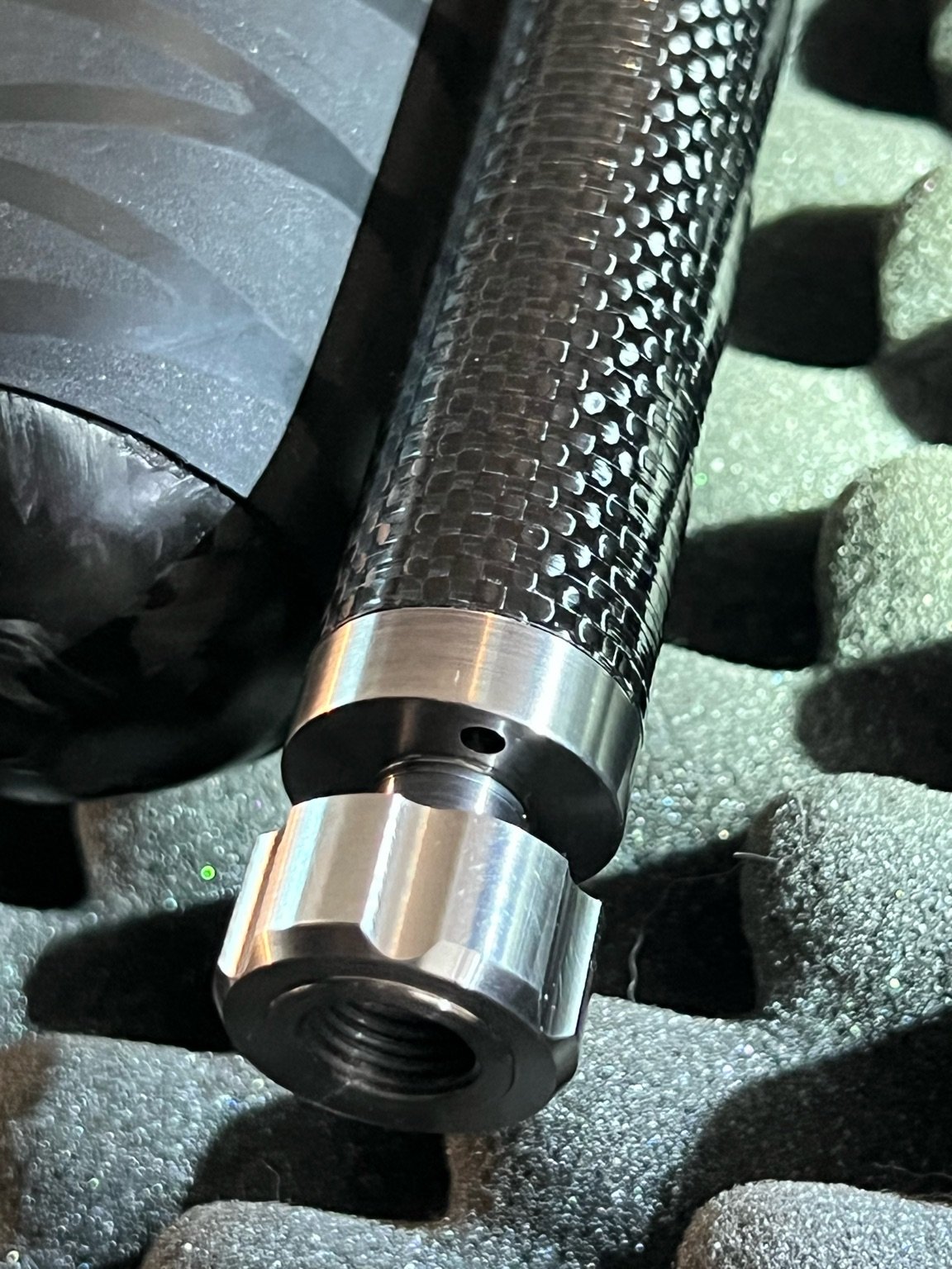

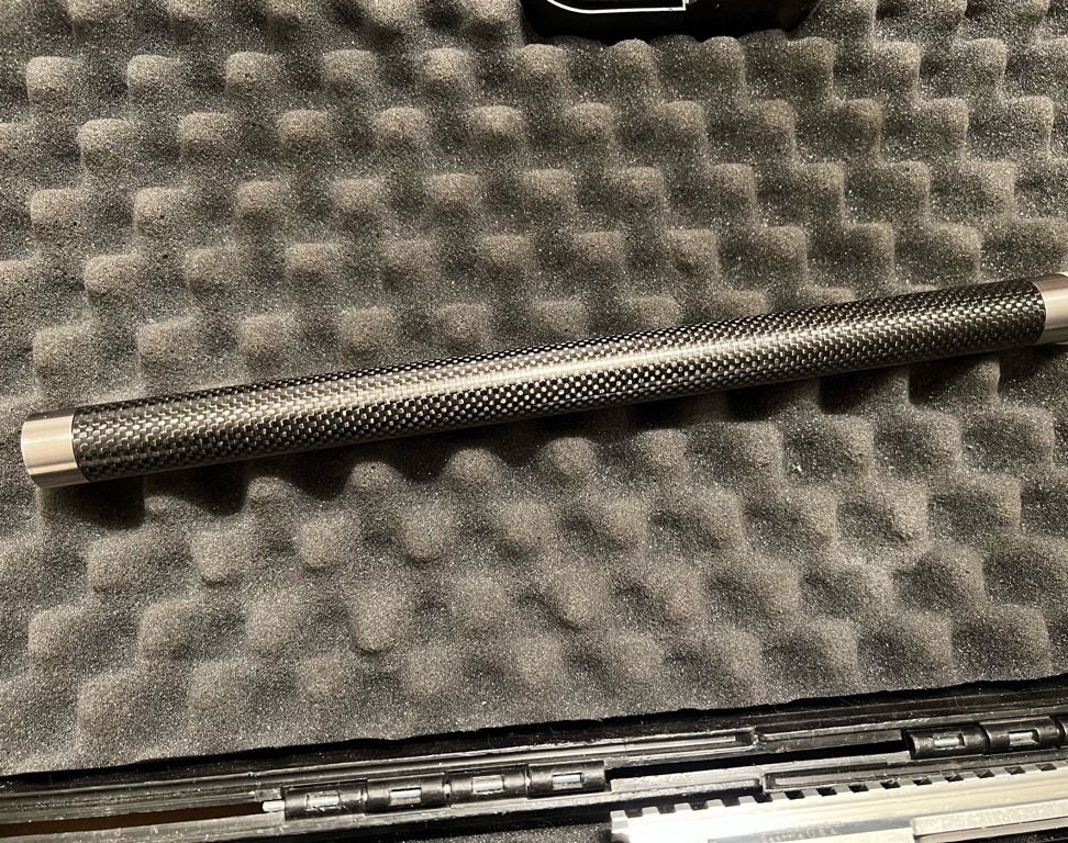

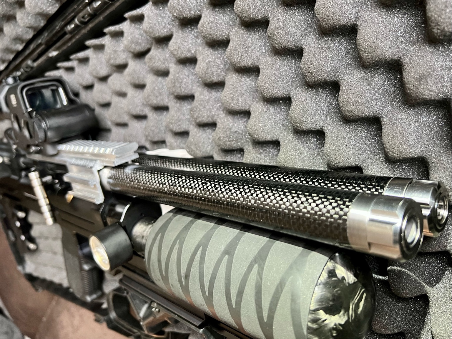

- Carbon Fiber + Titanium Barrel Shrouds & Titanium Thread Protectors - Made from very high-quality (very pricey) high modulus carbon fiber from Rockwest Composites and certified 6AL-4V titanium. I made one for 500mm and the other for 600mm barrels with a revolver style titanium end cap for each of them. The end caps were designed to work with the barrel system, but they can be run on other riles using a polymer stopper that I made and they are both VERY effective at dampening barrel harmonics!
- Custom Barrel Tensioning System - Titanium locking ring integrated with the factory barrel supports. The titanium ring seats into the forward barrel support and the titanium end caps on the shroud slides over it to seat the shroud and provide the tensioning point. Works amazingly well. You can pick up the rifle by the shroud and use it as a baseball bat and not damage the barrel (not that I recommend this, but it's that SOLID!

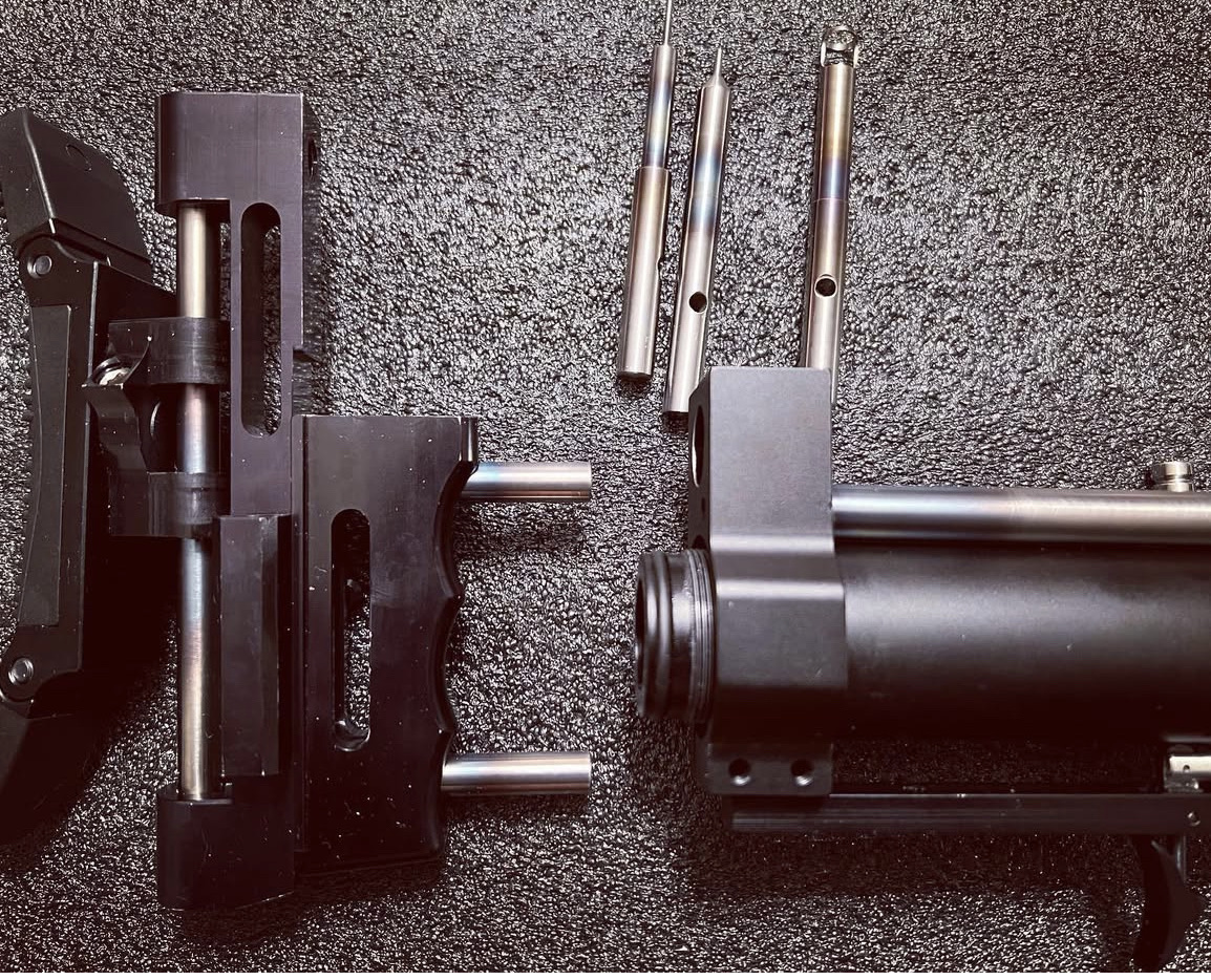

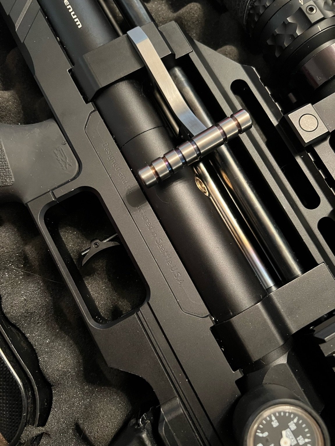

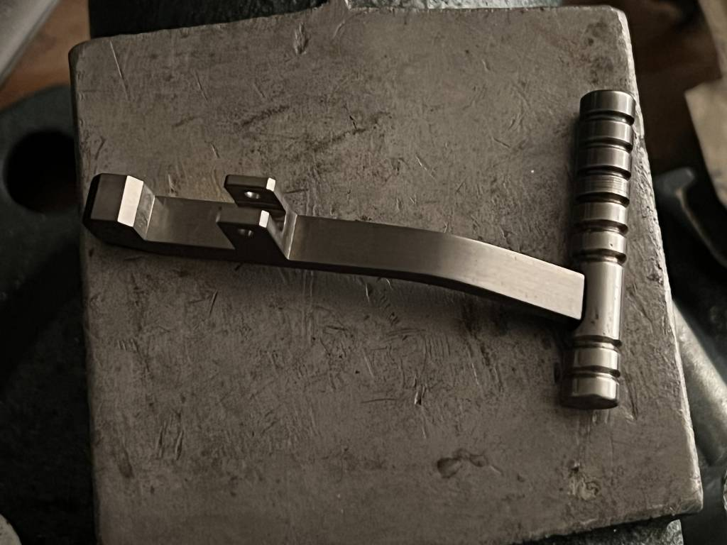

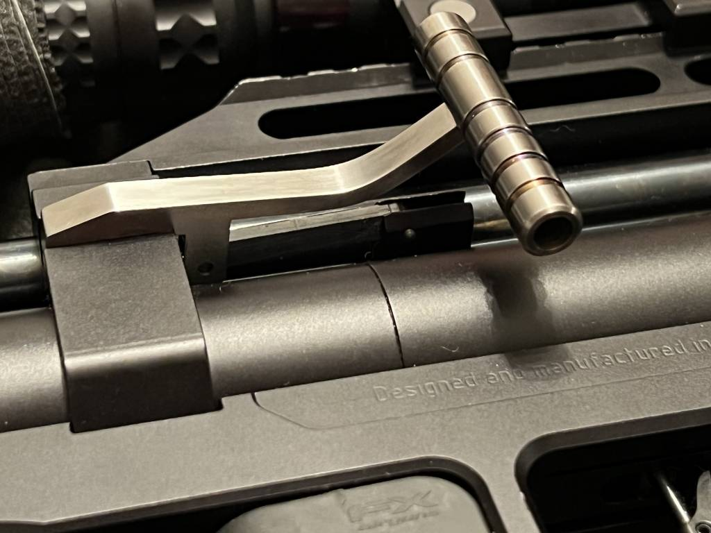

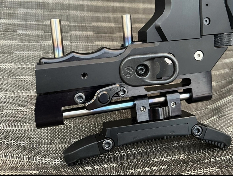

- Titanium shorter action lever system - I milled the lever from 1.25" 6AL-4V titanium rod stock and the handle with 3/8" 6AL-4V rod stock from the same material source. It took me two tries to machine the lever perfectly (screwed up the first one one of the last machining operations), but it was well worth it! Nailed the tolerances and the cocking action feels so perfect with a high-end firearm like smoothness.
Also made a precision spring that seats against the cocking rod guide on the opposite side of the lever. Combined with the leverage "over travel" snaps the lever down snugly for field use. It took a lot of trial with different sized springs to get it JUST right, but I was able to find the perfect balance of resistance for keeping the lever closed snugly and being able to cycle ammo for rapid fire.

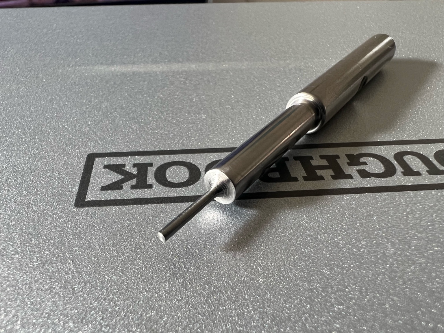

- Pellet & Slug Probes - I have the factory FX pellet probe in .30, a titanium pellet probe and slug probe in .30, and titanium slug probe in .22.

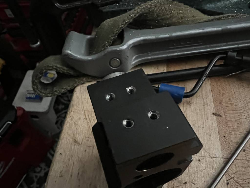

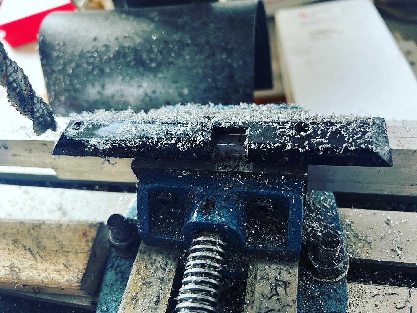

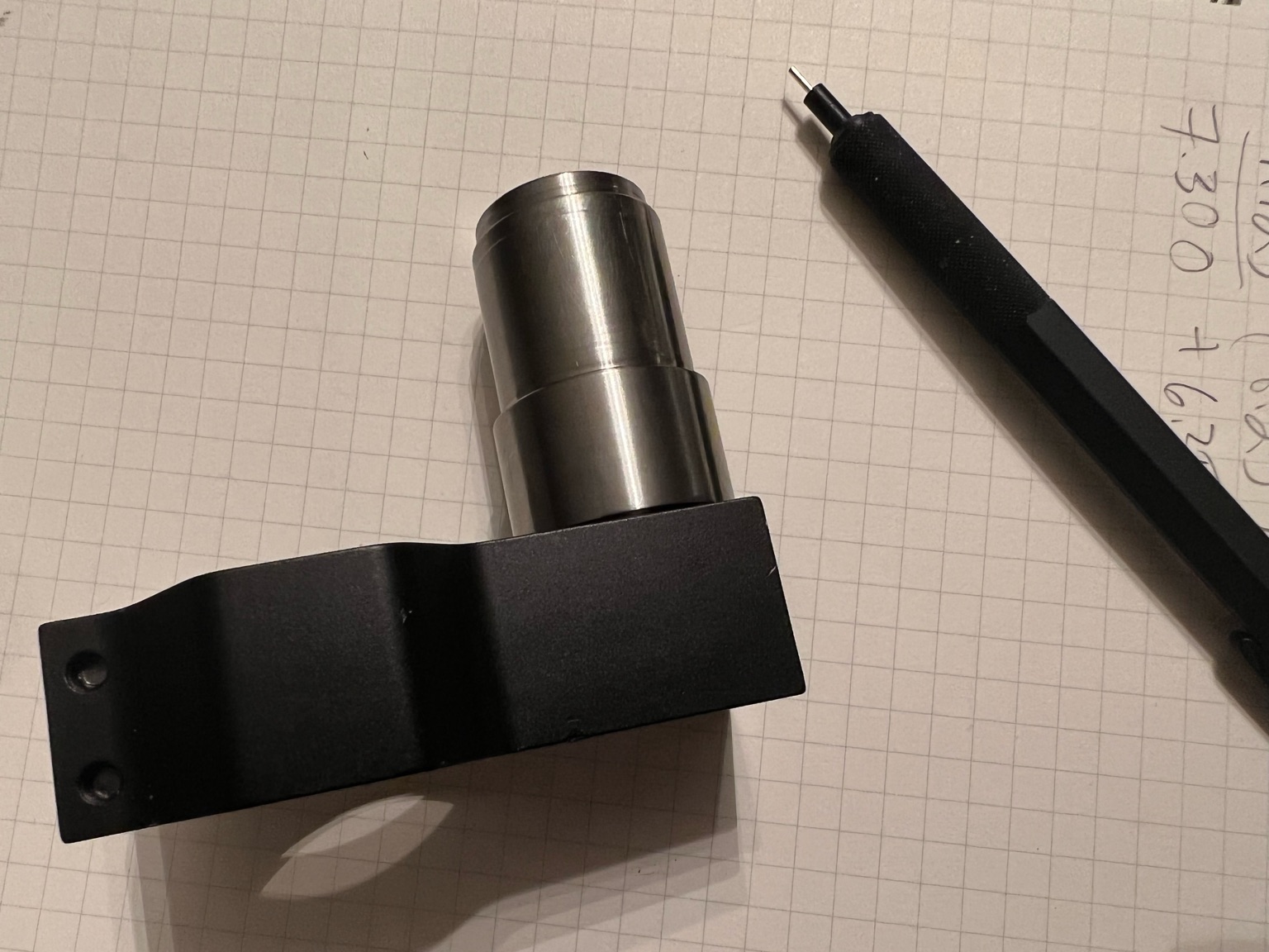

- Titanium cocking rod guide (threaded) with Delrin 150 (slippery grade, press fit inserts - there's (4) total components that I made from scratch for this piece. I broke the factory aluminum rod guide shooting from a bench, so I decided to make an indestructible replacement along with upgrading the cocking rod to eliminate slop (see below)
The first one I made was stainless. Eventually got the itch to make another one in titanium.

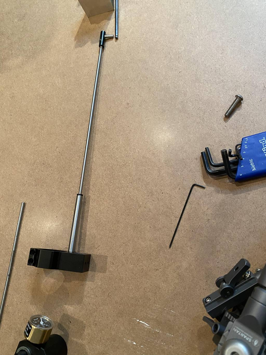

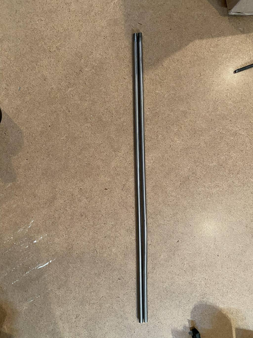

- 5/32" Music wire cocking rod - I bent the factory rod like pretty much everyone else with a Maverick / Wildcat. Went with a 5/32" music wire (C61 hardness). It's just a tiny bit larger in O.D. than the 4mm factory rod, which had way too much slop. This music wire rod was a nightmare to thread, however it has been flawless and as straight as an arrow for the duration that I have ran it. It also greatly improved the sloppy cocking action in conjunction with the titanium cocking system that I custom fabricated for this rifle.
- Modified cocking rod connector - Drilled, milled, and threaded a beefy M4 cap screw to prevent the rod / probe assembly from dislodging the (2) M3 factory set screws at high power fixing a total factory design flaw! This allows the rod connector to clamp against the rod from both sides.

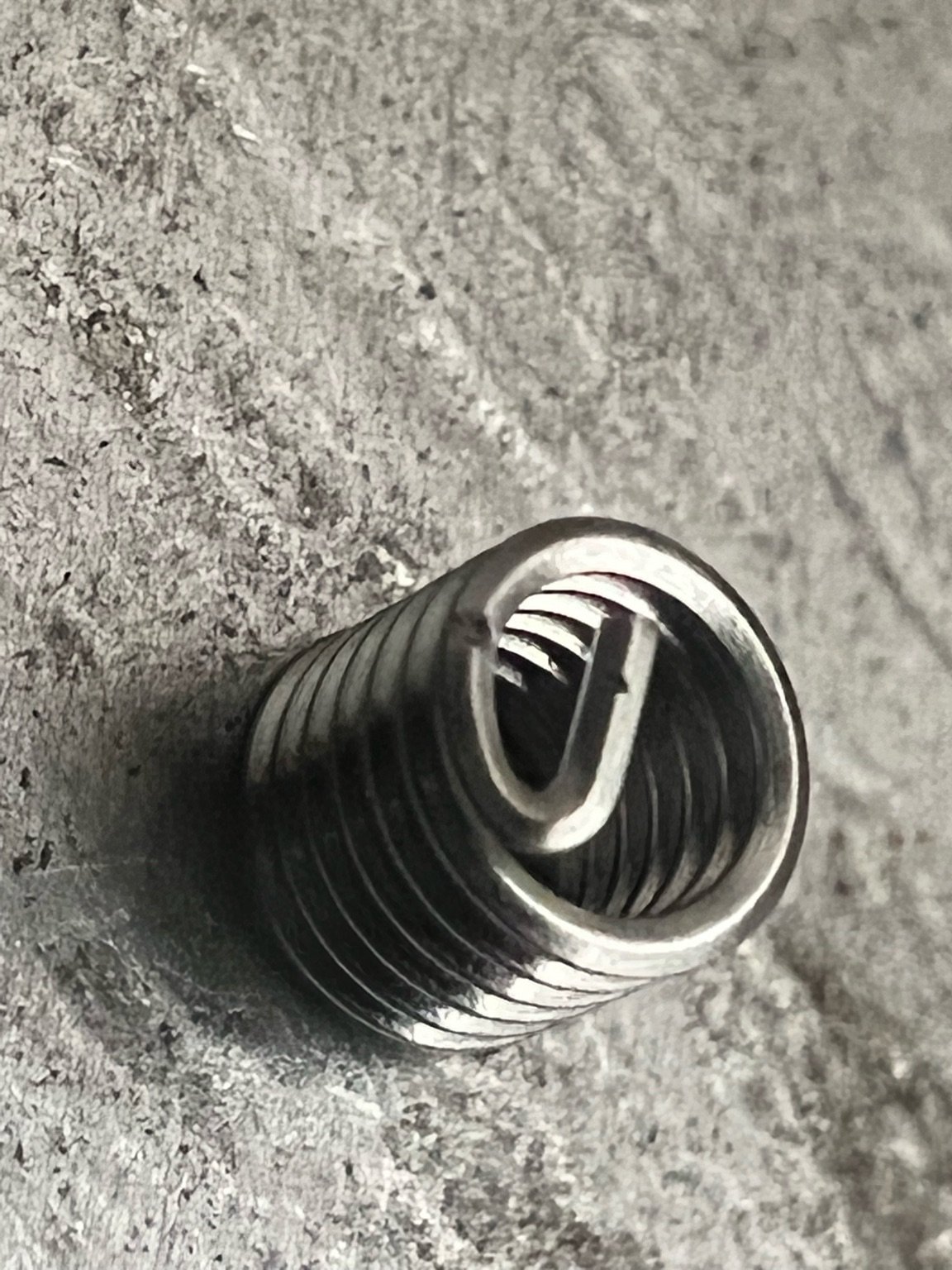

- Barrel / Rail Support Stainless Helical Thread Overhaul (18-8 stainless M3 steel Helicoil thread inserts) - The factory aluminum thread can strip out, so these completely mitigate that problem and allow for the rails to be properly torqued.
Tuning - FX Maverick Stainless Helical Thread Overhaul
Preface: if you're planning to do this modification, you'll probably want read the install details below! This was fun and expensive. I had stripped out both of the little M3x0.5 threads in my forward barrel support (the parts where the scope rail threads into). The first thread partially...

- 500mm FX Superior Liner .30cal (1:37" twist) - This is a real gem of a liner. I have a high quality precision carbon fiber sleeve bonded to it with 638 Loctite. I have only shot pellets with this barrel so I don't mess up the bore with unecessary wear and tear from leading. It's been very carefully polished and I've only used a good cleaning rod with appropriate sized patches to clean it when it needs it (it shoots lights out for a long time without needing patches run through it).
500mm Shrouds - I have a carbon fiber + titanium tensioned shroud and the original FX factory aluminum 500mm shroud. I also have a custom made black Delrin shroud extension with a 7075 aluminum threaded insert (1/2-20 UNF) that I made for the factory shroud to extend it out just far enough to run a 480cc bottle. This is what it looks like in action during an NRL22 match:
