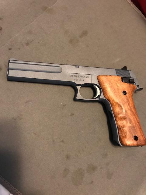

Some years back my wife gifted me this pistol...I believe for my birthday. I have done fair amount of work to it over the years, and at some point it started leaking co2 down the barrel, and sat idle for a while. Just got done putting it back together today. No more leaks, angled port to the valve, custom Maple/delrin hand grips made by me, the barrel was recrowned some years back, polished sear, and power adjuster added. Took it out in the side yard to put a few pellets through it, and get some chrony numbers this afternoon. Just as loud as I remember, and has just as much kick when fired, lol. Pushing 14.2 gr. RWS Super-H-Points out at 405 with a new co2 cartridge. This is the first pistol I have made grips for. They took what seemed like forever, and I started over a couple times with new wood trying to get everything right. Now the pistol falls right into place, and I hardly need any hand pressure to hold it comfortably. Just excited to have this 1 working again, been too long. My hat's off to the guys making grips on a regular basis, these were definitely a challenge. Probably won't be the last, but am not jumping into another set for a little while. Anyone else with an eb22?? Let's see some pics!!
