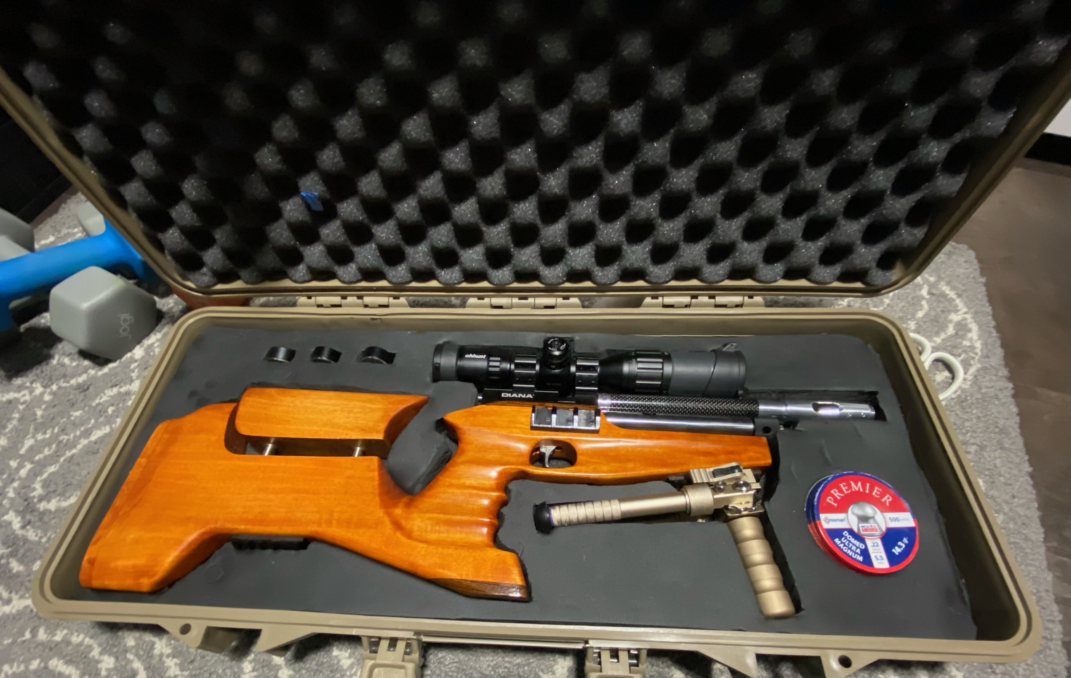

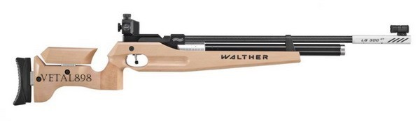

Hi here is my all DIY .22 Chaser I've been working on for some time now.

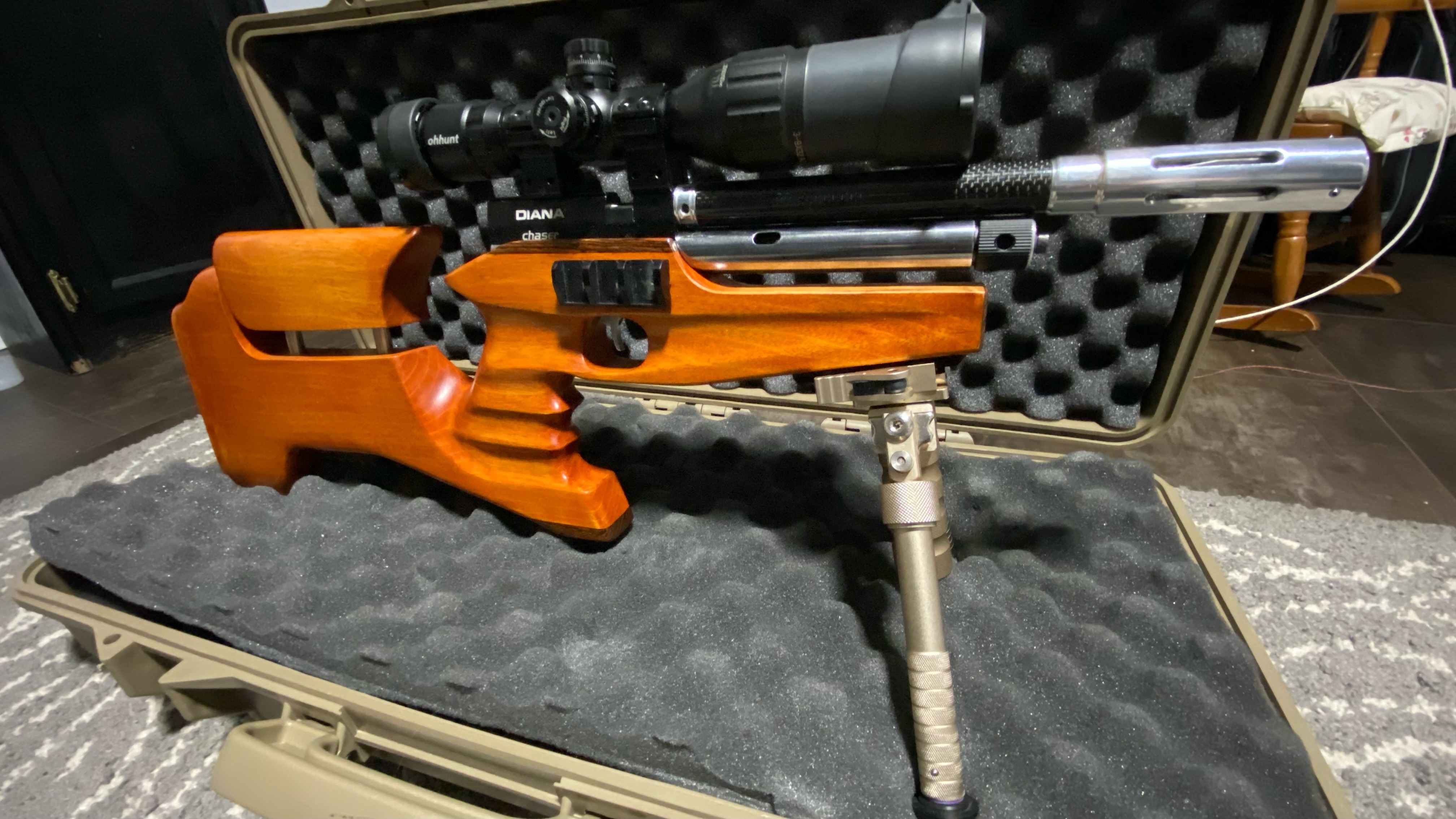

Still tweaking the stock shape a bit , been recut and sanded a few times on upper forestock.
It has the a leade and chamber &TP polished recrowned 9.5 barrel . Valve is smoothed and tuned to FPS 480 fps with 14.66 FT trophy.
3x9 bugbuster style scope with 11m med rings.

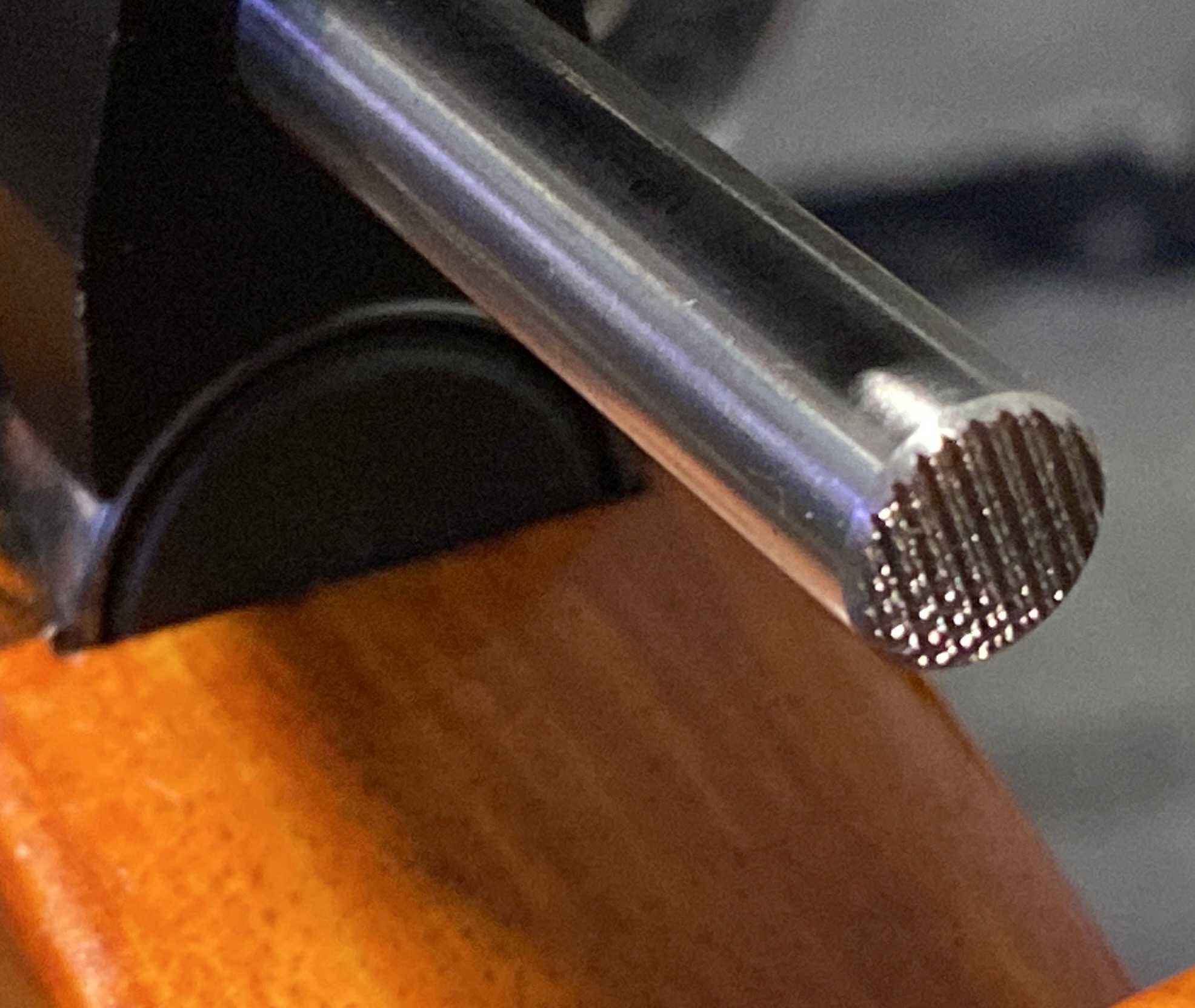

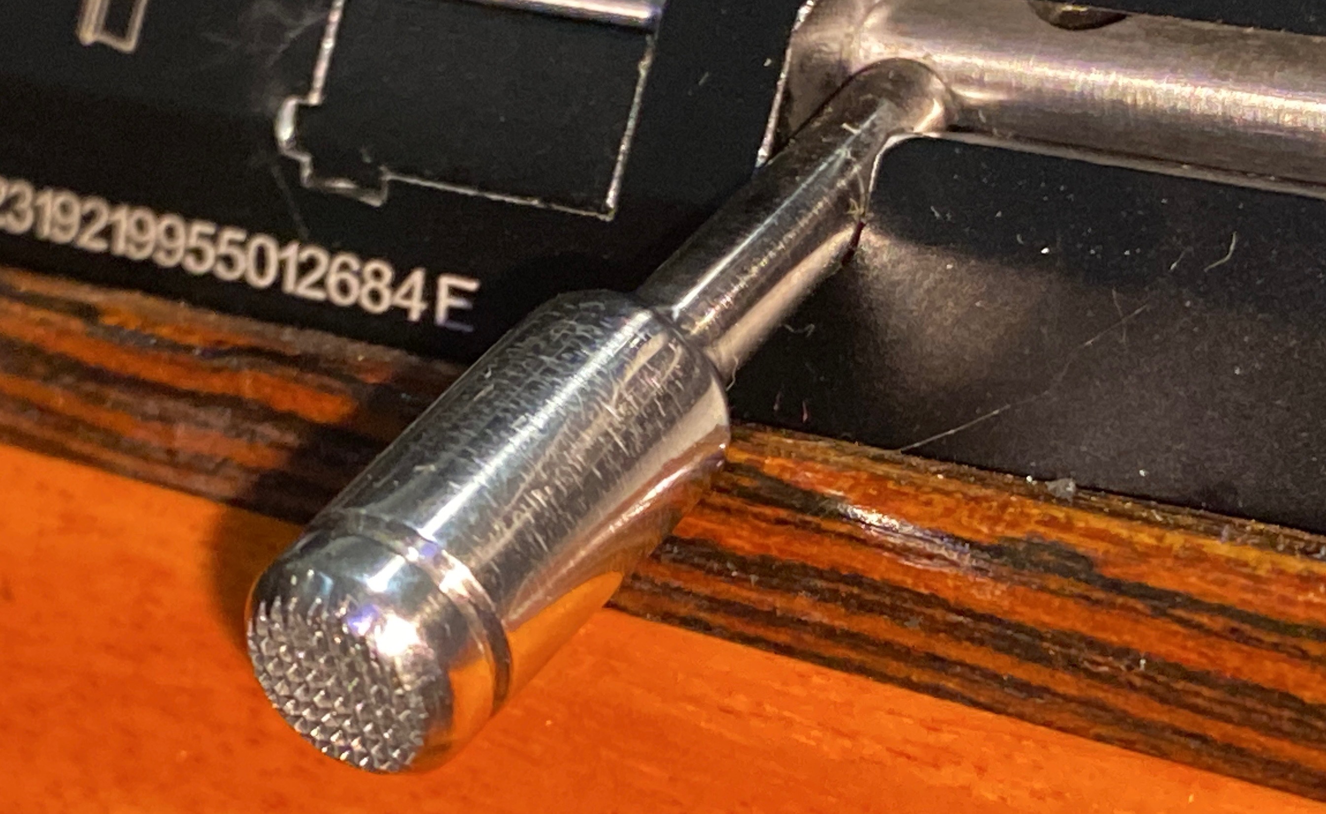

Custom machined and checkered oversized slightly 304stainless bolt.
Stock is northern california myrtle with flamed maple and cocobolo accents , cheek rest adjustable.

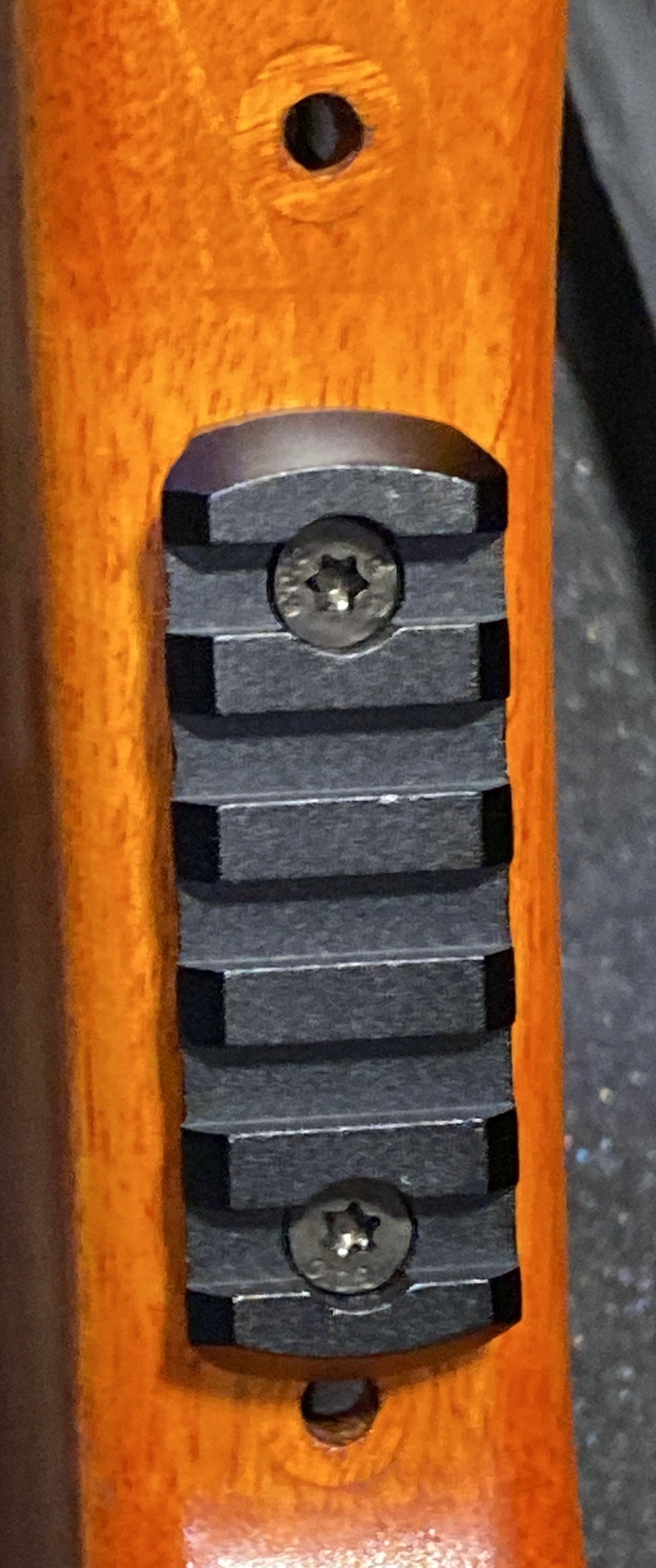

2 Stage 1.8lb trigger with working safety. 3d printed magazine holder on stock
All the chamber and TP polishing paid off the stock mags load smooth like butter.

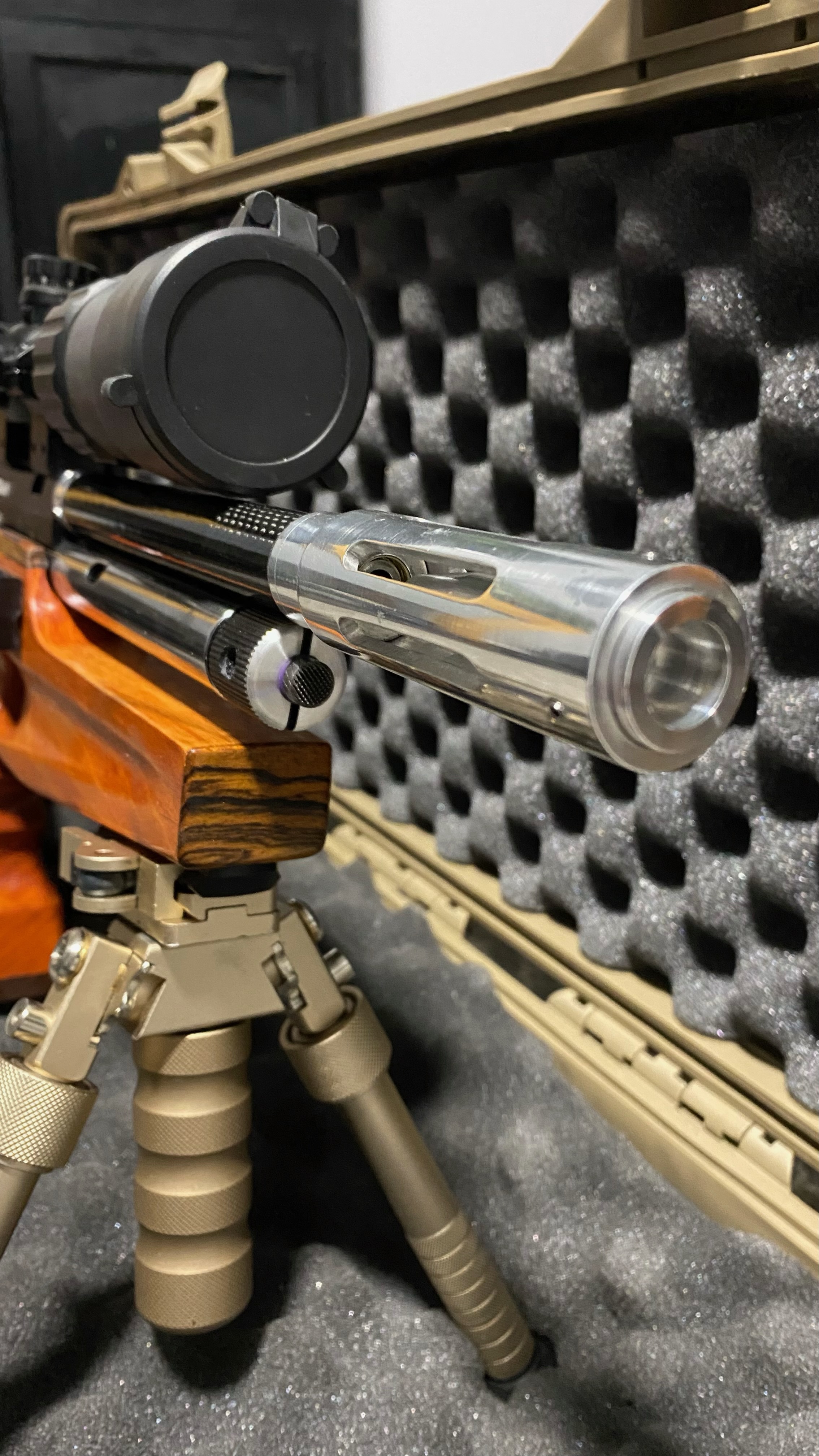

Aluminum and carbon barrel shroud with built in free float barrel support and adjustable coned air stripper.
can hit 2inch spinners at 45 yds consistently was not sure what to expect.
I based my stock design on the walther LG300XT pic below . I wanted a nano version of the LG300XT as I love that classic look.
The bipod with handgrip is an airsoft version of the atlas. fantastic little tripod. I plan on putting a mono pod on the butt for sighting in ease.
I foamed out this 28inch airsoft case for it and just fits. Phew:)
Is that about expected accuracy for that range? I don't get to shoot at that distance very often
so you used a Bandit barrel for the project
now this is my opinion
if you can find a Stormrider barrel here in the states or Canada you might want an extra few inches now long ago i made 2 pistols up from parts and stuff and cut barrels at 13 inches with carbon fiber barrel covers
but just my opinion
Its actually an airbug barrel 8.3inch . A bandit barrel at 9.5 would be an improvement. I plane on getting a stormrider barrel to cut down. I want to keep it under 11 inches so it still fits in my case. At 10fps per inch that should get me just shy of 500 where I want to be .
