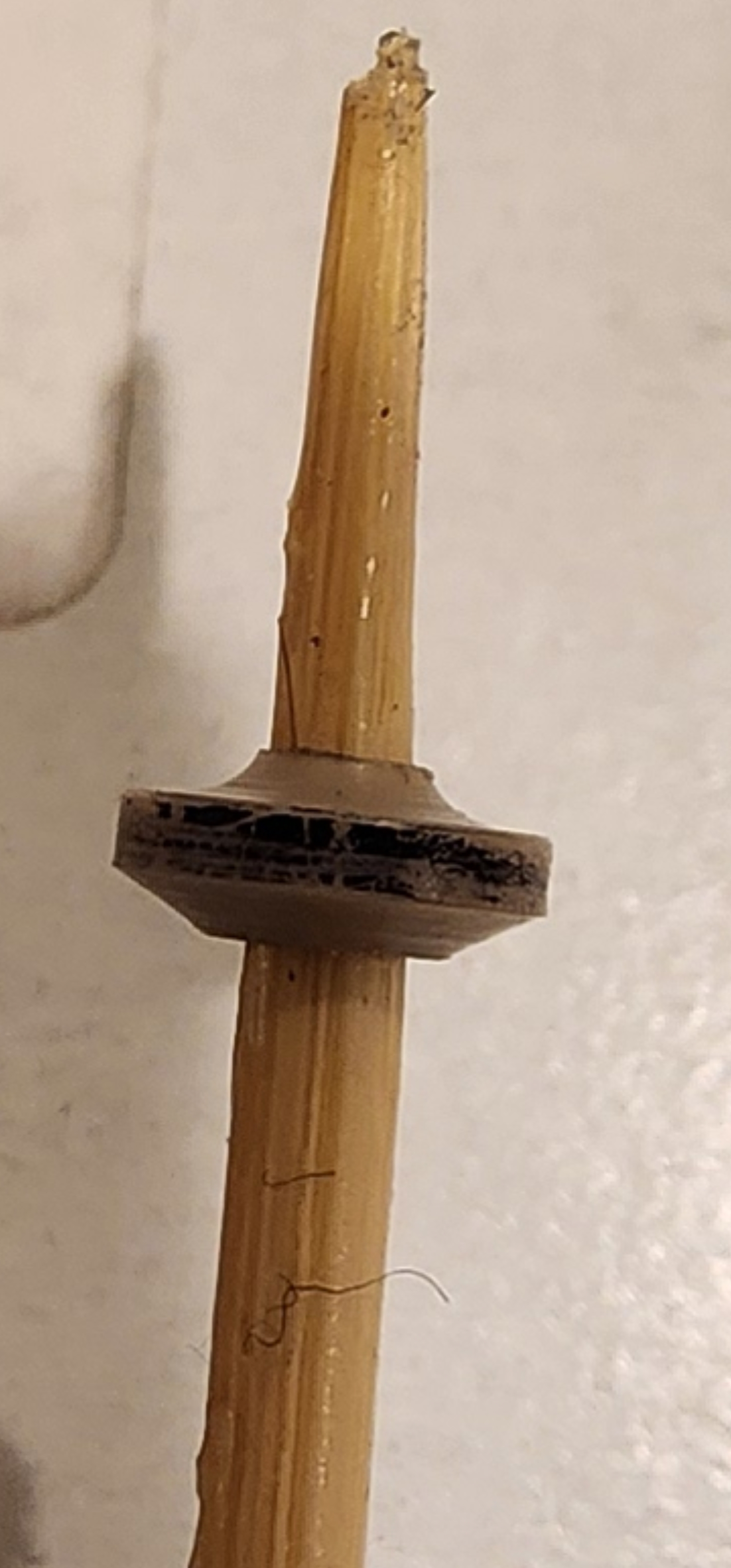

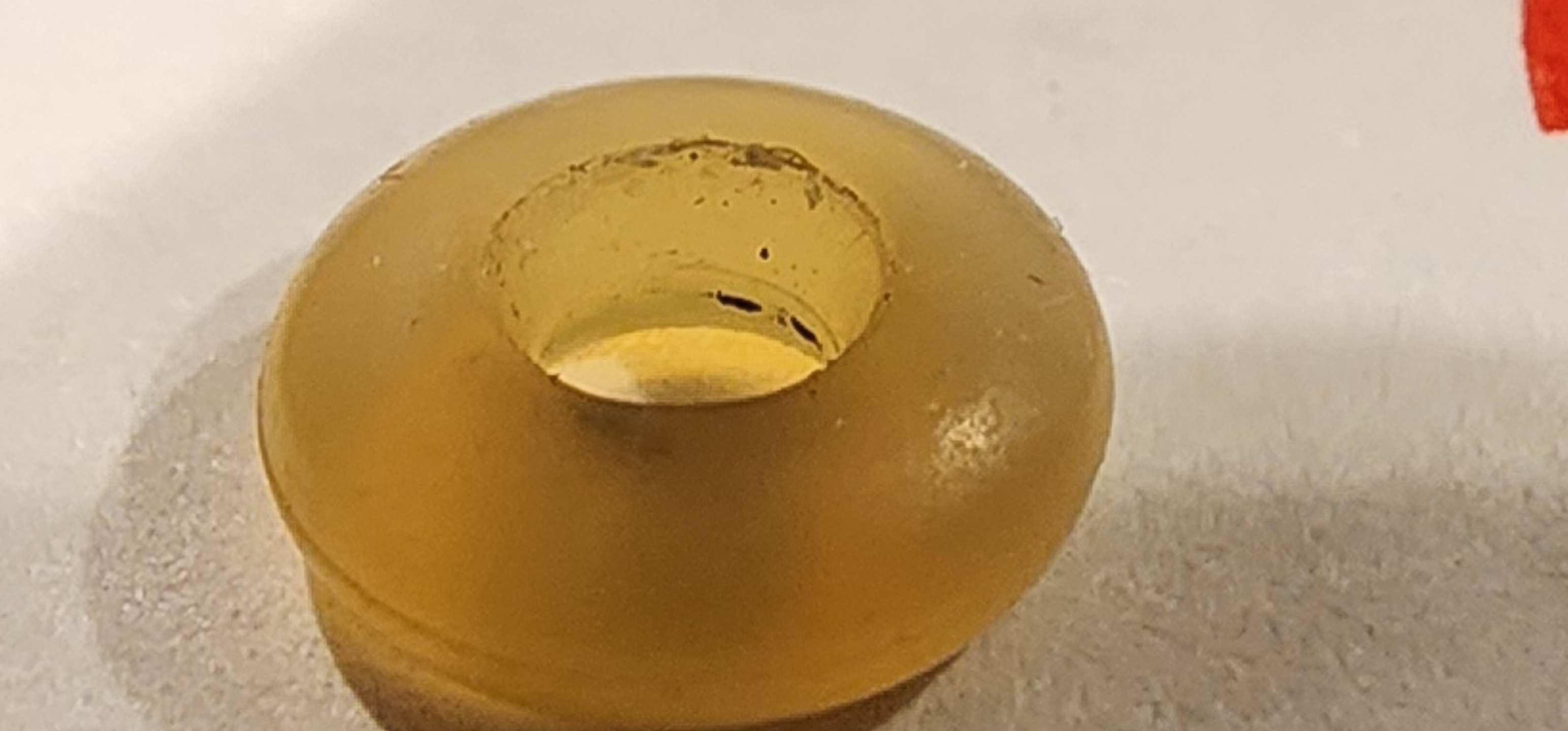

I came across this thread as i was having issues with the first 5-7 shots on my M3 being slow. Evaluation of the polyurithane oring showed extrusion.

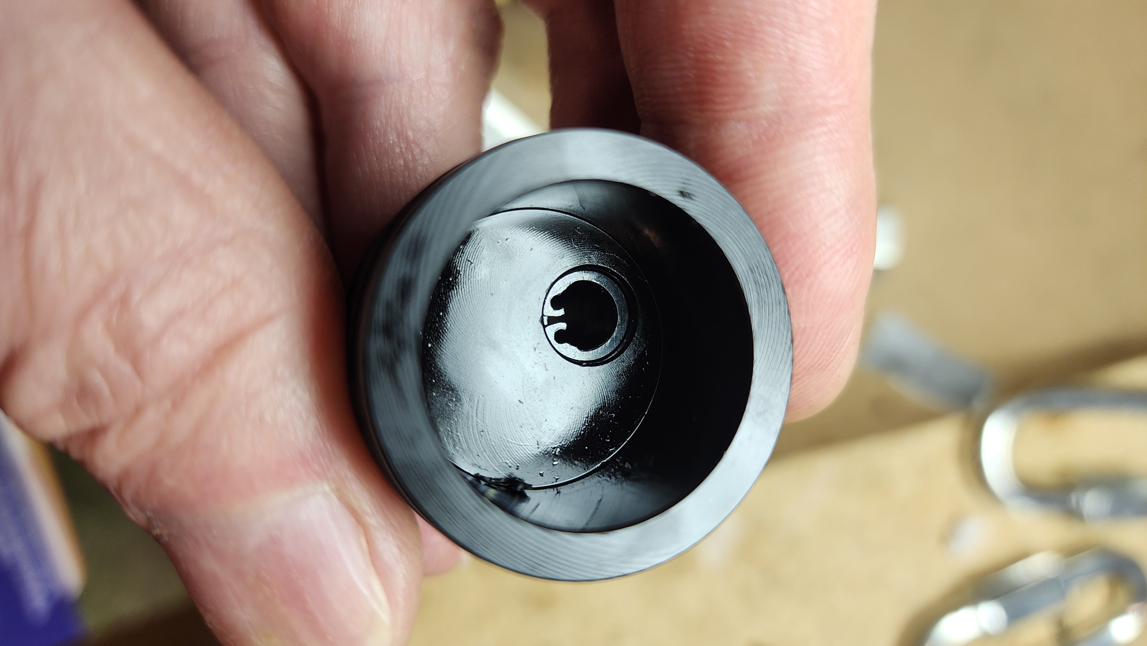

I fabricated the peek washer described in this thread with one modification. I incorporated a portion of the radius of the oring in the otherwise flat surface. The purpose was to provide support for the oring while under compression in order to prevent extrusion.
I also fabricated a 1 mm walled delron tube to secure in place the peek washer and two orings as I never liked how FX just secured them with grease. The delron tube is retained with a c clip.
I have a couple hundred shots through the gun now and slow first shots seem to be eliminated. Also, the valve system seems to operate more freely and easily now. Possibly the support from the radius I incorporated in the peek washer eliminated unnecessary drag on the valve rod allowing it to cycle with less force from the hammer. All fabrication was performed on a South Bend Heavy 10 lathe.
