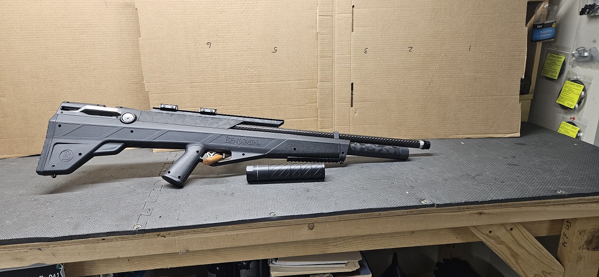

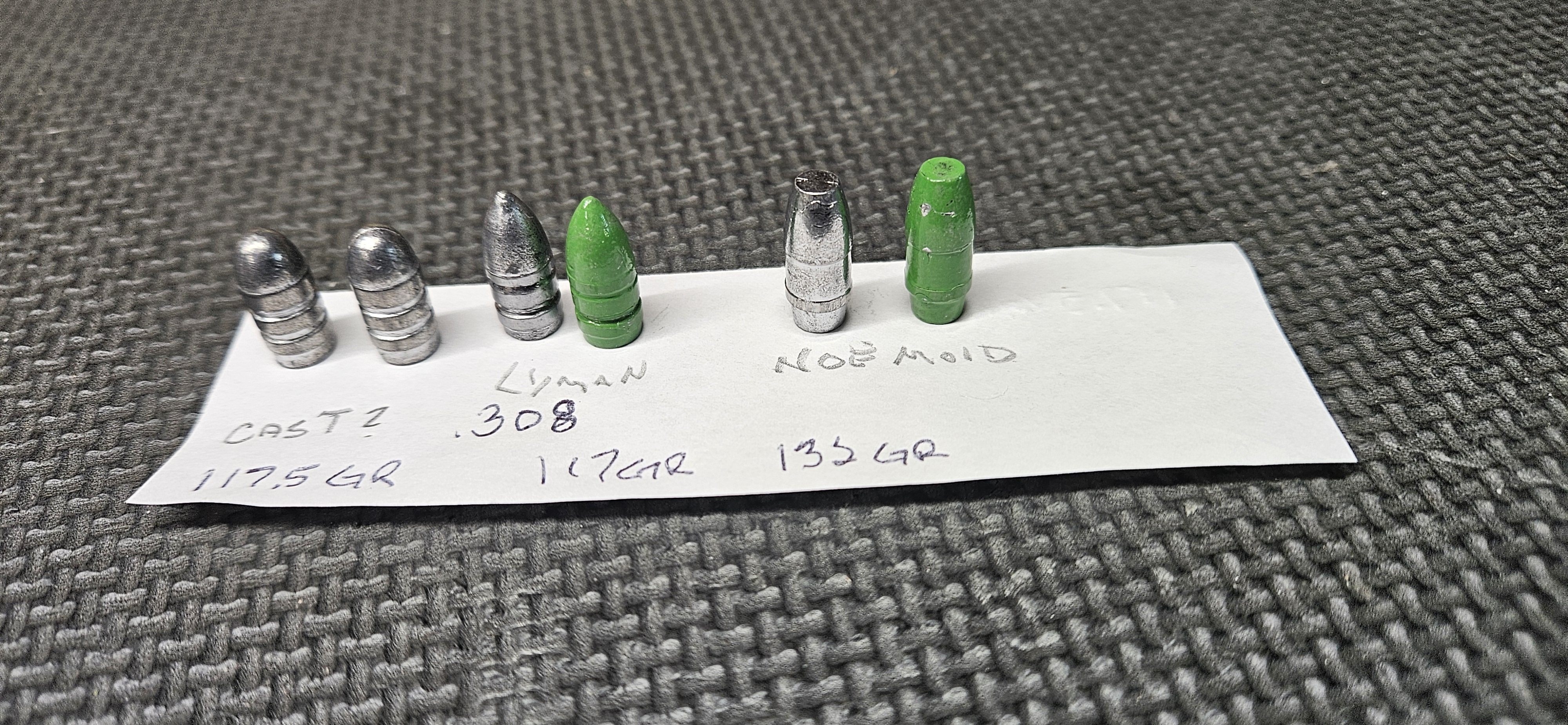

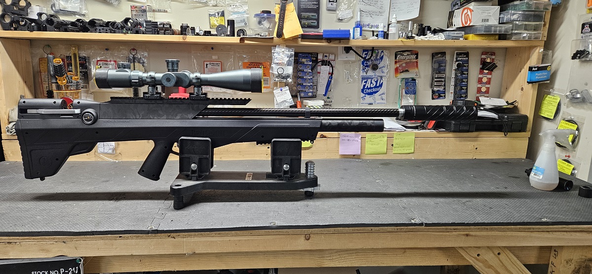

Howdy everyone just wanted to show off my new to me Custom built Taurus 308 by Brian Thurman at Veradium Air this is the only one in existence and I'm not sure if Brain's going to build anymore, I bought it from a Great AGN member a couple weeks ago and have finally gotten time to go to the range to test it and it is a Awesome shooting rifle, the power and accuracy are fantastic it's more accurate than I can shoot it. With the Donny Yokozuna mod it's very quiet. I took it to the range last Tuesday and it was a challenge to try an shoot between rain showers and be able to chrony with my Labradar and FX pocket but I got it done, so here's some results. All starting pressure was 3600psi and I give psi for each consecutive shot.
117gr PC Cast Lyman
1 1039fps 3600psi
2 992 3400
3 968 3200
4 968 2900
5 937 2750
6 921 2600
7 903 ? forgot to check air gauge
8 899 2400
9 868 2250
10 stopped for rain
132gr NOE PC'd and Non
1 1000fps 3600psi
2 984 3400
3 967 3200
4 947 3000
5 927 2800
117gr cast RN
1 1027fps 3600psi
2 1012 3400
3 997 3200
4 976 3000
5 947 2800
I had to stop because of the rain so I'll be going again soon and will update my post each time I go. Also I will be sending the rifle back to Brian and have him put it in one of the FX stocks he's been modifying his rifles in so it will be really Awesome then, here's some pics.
Impressive velocity for sure!!!! Right there with a stock texan.....1000 fps with 134 is great😀...What kind of barrel a TJ liner? I'd hook up to external regulator and run it right at 3625psi for consistent fps.with your heavy slugs... Nice powder coated slugs..
Thanks on the slugs, not sure but I believe its a TJ next time I will take my regulator and do that, I was wanting to see how many useful shots I could get on a 3600psi fill.
117gr PC Cast Lyman
1 1039fps 3600psi
2 992 3400
3 968 3200
4 968 2900
5 937 2750
6 921 2600
8 899 2400
9 868 2250
10 stopped for rain
1 1000fps 3600psi
2 984 3400
3 967 3200
4 947 3000
5 927 2800
117gr cast RN
1 1027fps 3600psi
2 1012 3400
3 997 3200
4 976 3000
5 947 2800
I had to stop because of the rain so I'll be going again soon and will update my post each time I go. Also I will be sending the rifle back to Brian and have him put it in one of the FX stocks he's been modifying his rifles in so it will be really Awesome then, here's some pics.View attachment 462026View attachment 462027View attachment 462028
