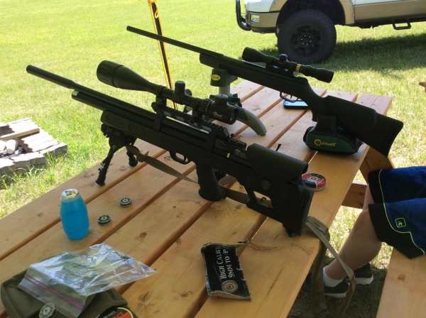

Just put one on my BullBoss and it's kinda ok not to impressed with it for being a 6-24 but maybe because I'm used to Vortex and Nikons on my other rifles, I'll have to look but I think I payed less for mine, just wanted to try a sub 100.00 scope. The BSA on my sons Gamo was clearer and the crosshairs were better just saying but I'm putting a different scope on my BullBoss.
