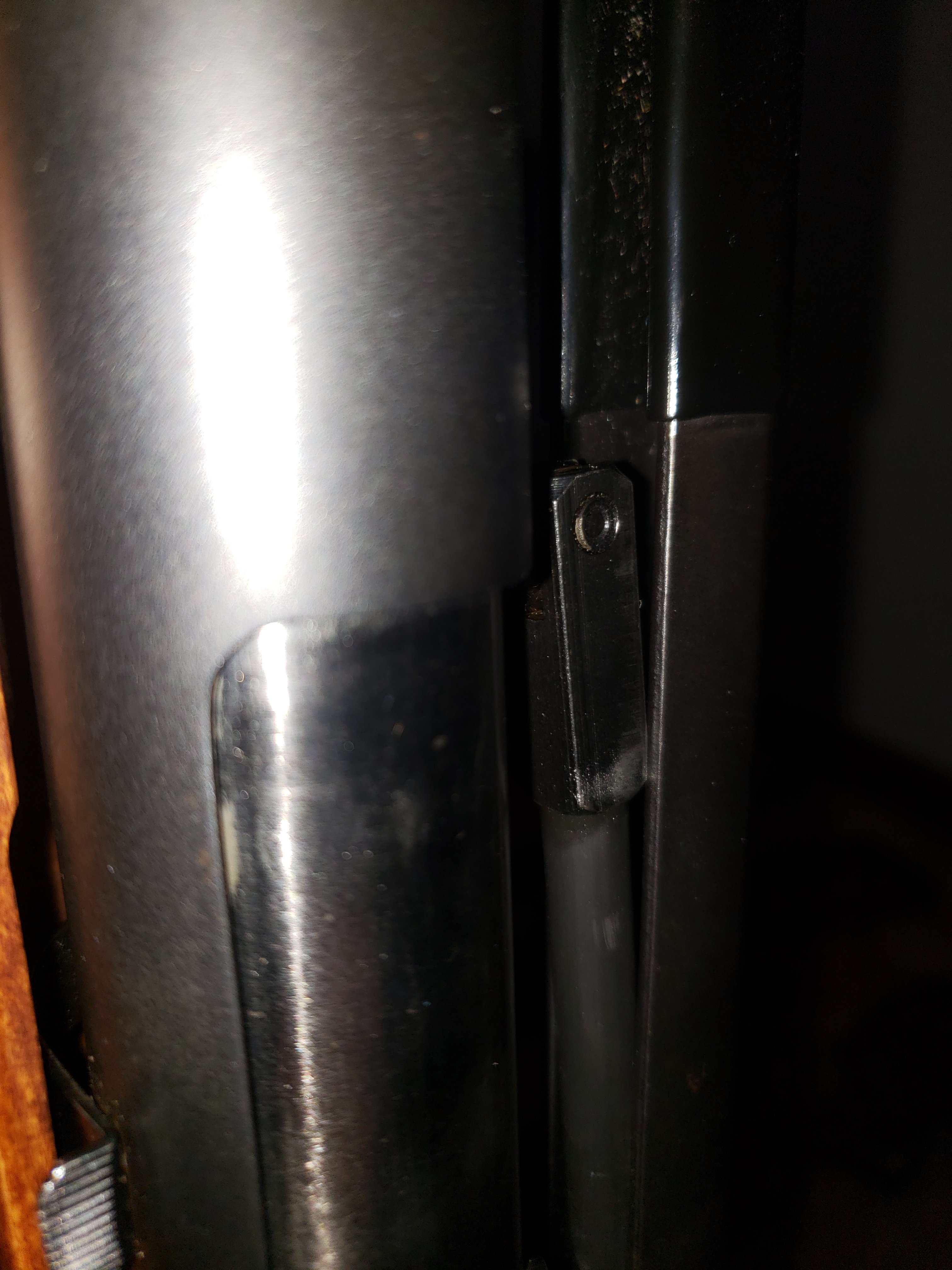

Ok so my sled seems to be setup properly then. The cocking linkage contact may be my next step then. I definitely have contact there. This is just popped open a hair but they are basically on each other and rubbing when closed.
Make sure that the cocking handle isn’t rubbing against the sled reset plate on the right hand side.
No expert, but here is my experience anyway. With the factory oil on the sled rods, there was considerable stiction present. I wiped off all the oil and relubed with Phil Wood bicycle grease (amazing stuff, lasts for decades without drying up or bleeding oil) which greatly reduced the stiction. I also found that tighter detent settings worked better than loose, possibly because that helps dampen some of the play in the rear sled on my 54. I am at minus 1 turn currently and getting good accuracy. My cocking arm overtoggles and seats against the reset plate. Maybe I should look into that.
