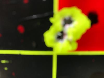

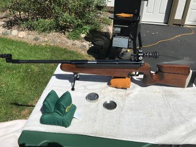

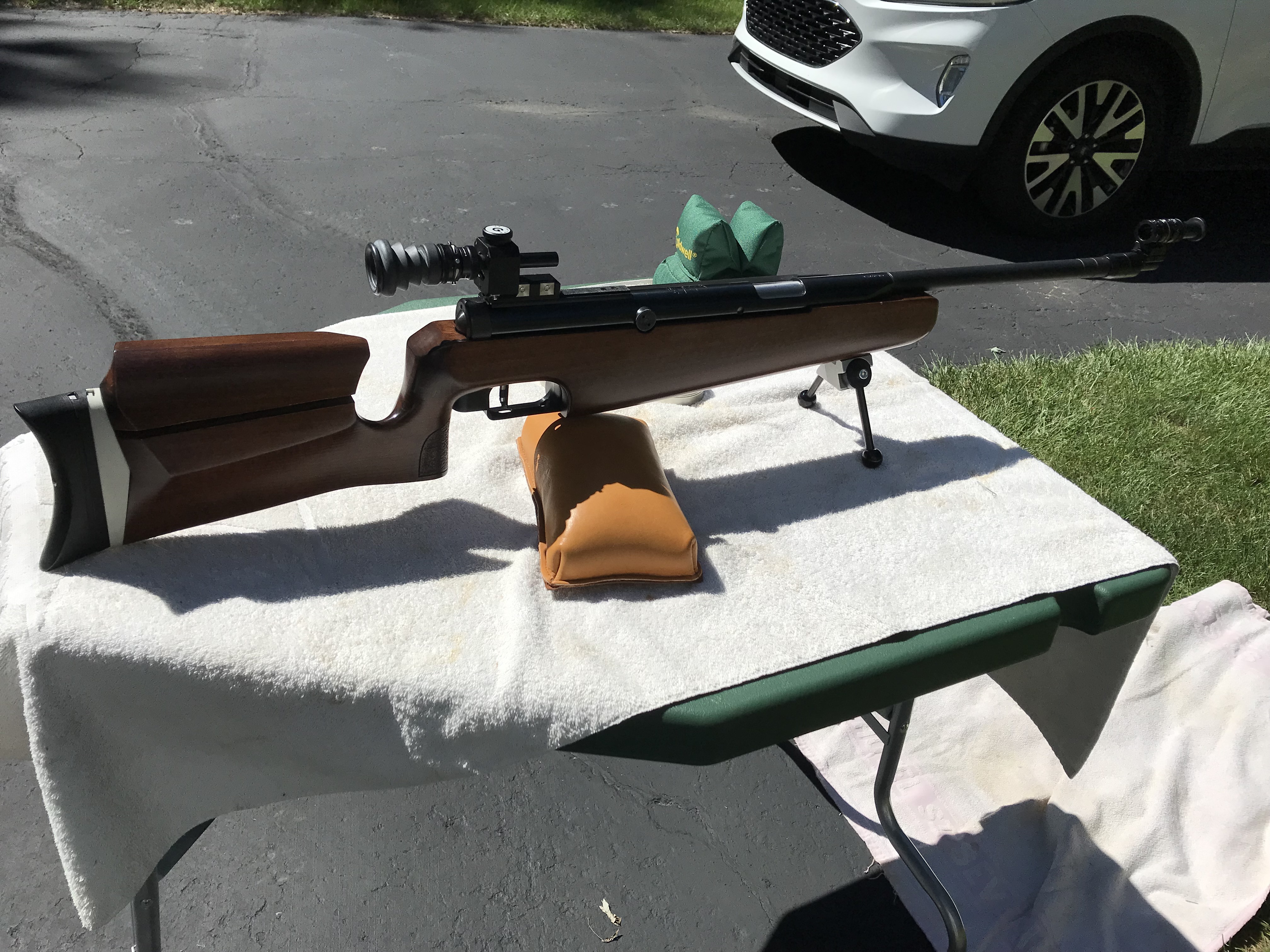

So I have been struggling trying to get this 11mm front sight on my D75, finally seem to have gotten it. I was shooting 7g Meisterkugeln at 12 yards. I was worried maybe the gun had not been timed properly by the seller so I decided to do the turret test. All my results are below, there are about 12 shots in that target, I think they went in one hole except for one I pulled.

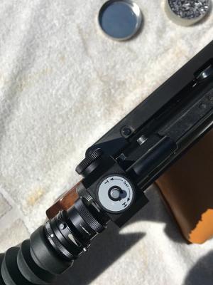

Before shot

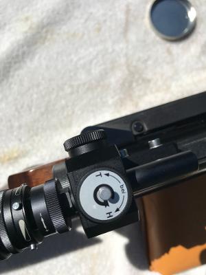

After shot

I think it's timed properly, I also pulled the trigger while watching the gun, it didn't move. What a blast to shoot. Anyone that hasn't tried one do it if you ever get the opportunity. I feel very blessed to have found this one.

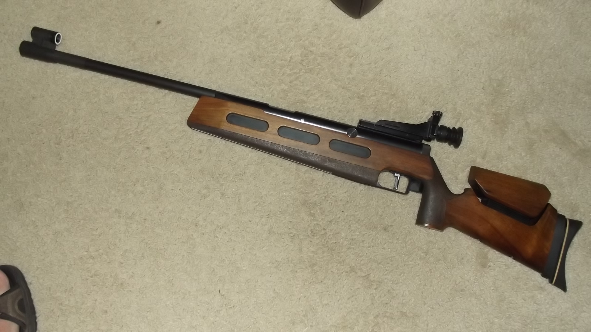

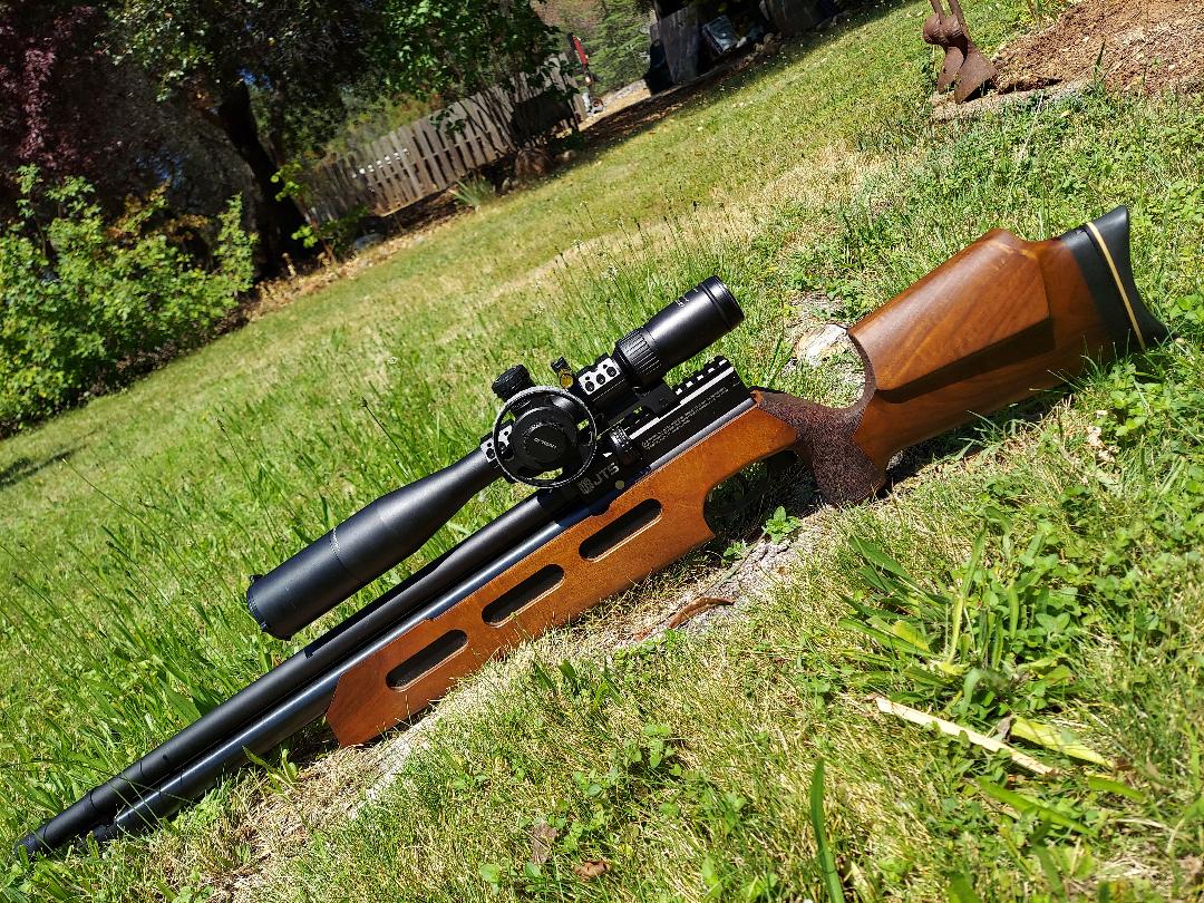

Not to derail post ... just sharing the love of these classics and the STOCK shape/profile they used.
Love the stocks so much that I found one w/o an action and modified it to run a PCP action within it :love:
