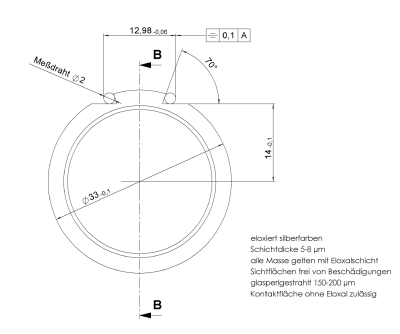

I need to know what dovetail profile is a better match to the D75, Walther or older Anshutz, both have 9mm dovetails. I'm buying an adapter overseas and want to get it right.
The Diana front dovetail should be a 60° dovetail, like most others are.
The Walther front dovetail is a 70° dovetail.
This download below is the Walther machine drawing, and it has not changed as of the present.
If the early Anschutz is a 60° 9mm dovetail, it should be a better fit on the Diana dovetail.

Thank-you Chuck. Think I'm going to take a chance on the Anschutz and hope it fits.
