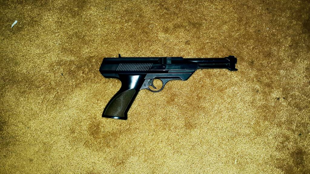

New in 1979 Single shot pellet or BB repeater 215fps BB's- 180 fps pellets. Very few Variations, it went from a heavy Diecast to plastic around 1990. It became BB only around 1984.

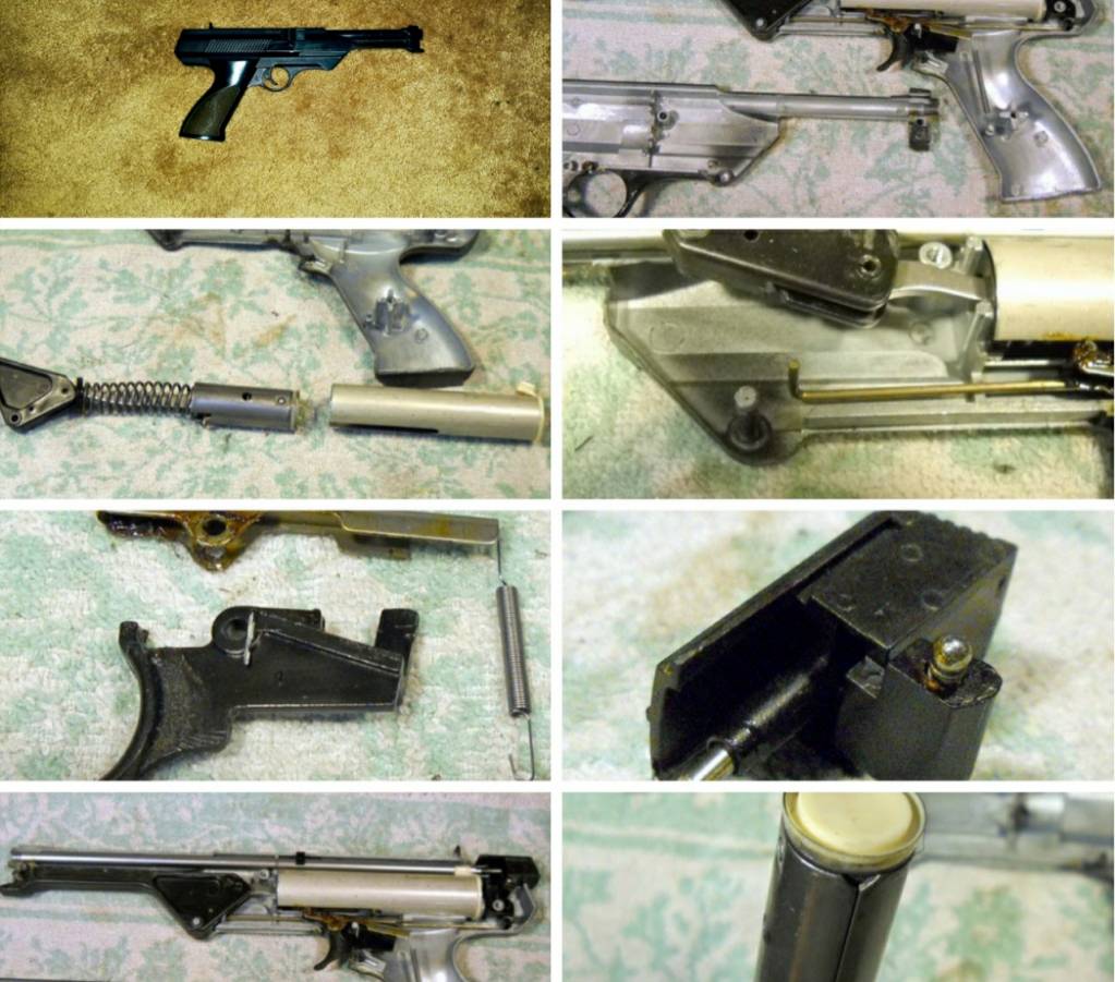

I have two in near mint condition. A earlier bb/pellets and a latter bb only. they both shoot strong but I wanted to see the inside. while in there clean and relive everything. It was dissembled everything was very clean to my surprise except a bit of old caking grease. The spring has more preload than I expected. Putting it all back together I used moly on the piston and other moving parts. When completed for drops of pellgunoil in the oil hole. and one in the loading mechanism.

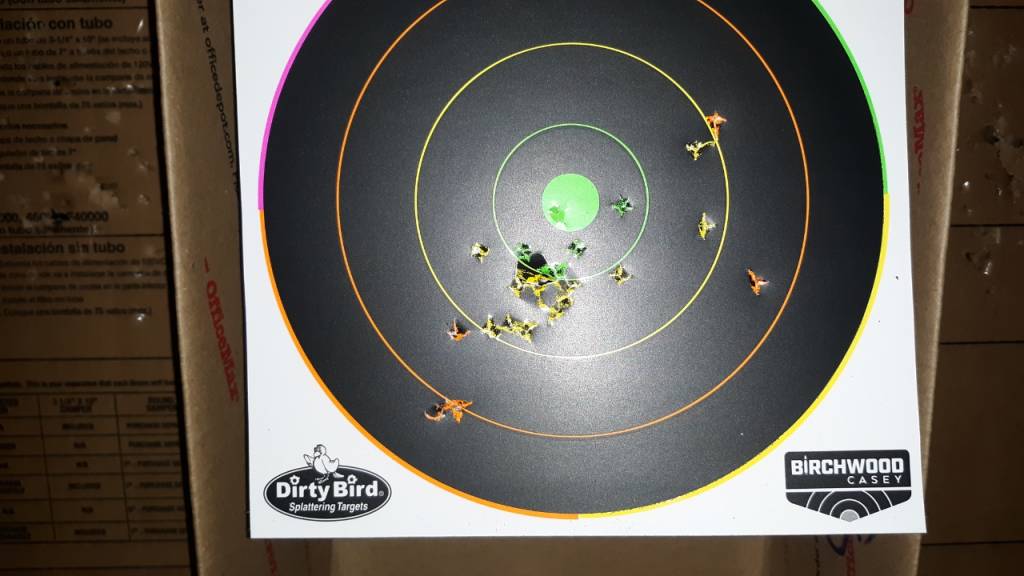

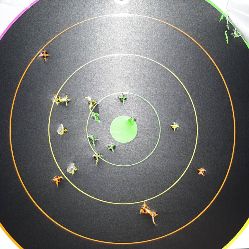

The third load I shot paper from 25 ft kneeling with two hand it's not a powerful pistol but seem to be fairly accurate. More so than the guy behind the trigger.
