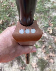

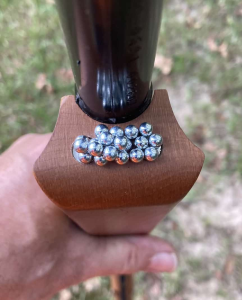

Post some pictures once it’s installed. Though the dimensions for the rifle was more kid oriented it pretty decent for me and I am 6’-1”. A little more length would hurt. The forearm has a trough built in for adding lead weights. I plan to drill two to three 1/2” holes in the butt stock 6” deep and inserting lead rods. Then I want to copy this I saw on Gateway using rare earth magnets.

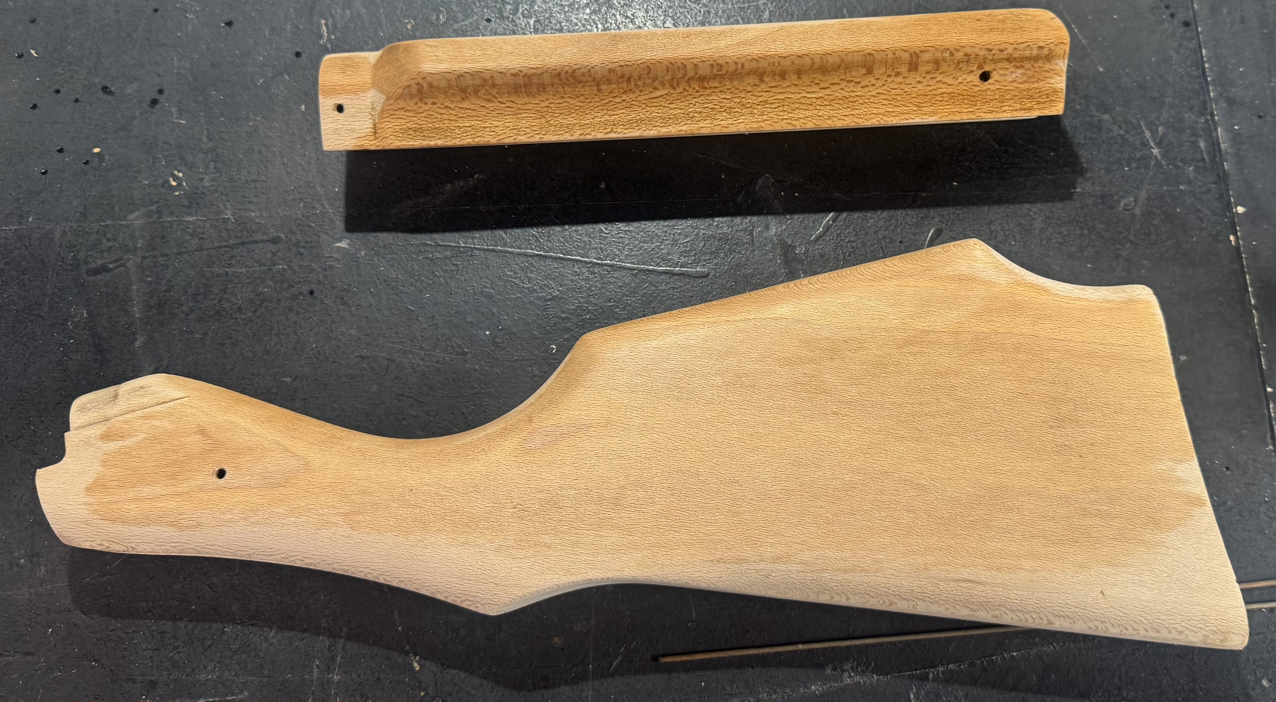

I want to modify the stock so I bought an old one from EBay . I am going to add the butt hook and I was going to make a cheek riser but with the peep sight I need to make one of those cheek wells. I taped everything off and began to look at it . I cannot add material because of the stain. All I can do is carve in and make a recess. I have no clue how. I am not a wood worker. I guess I need to try on a piece of practice wood scrap first. Any suggestions.
This is what I am thinking .

I am still watching my rear sight travel the Midwest. It was ment to be here yesterday and it’s someplace around Chicago. The butt hook will probably be here by Monday and it is made for an Air Arms S400. So I will have to do some work to fit it to the Daisy 499. I spent this week removing the stain and dings from the stock I bought on E bay. It is a beech wood stock and after sanding it with 220 grit paper. The wood grain is really beautiful. I am not going to do any sort of cheek piece modifications because I know it will ruin the stock.
I am not a wood worker. But I have made enough mistakes trying to know my limitations. I can probably do a decent stain job. So after I fit the butt hook I will sand it with a 180-220-600.
