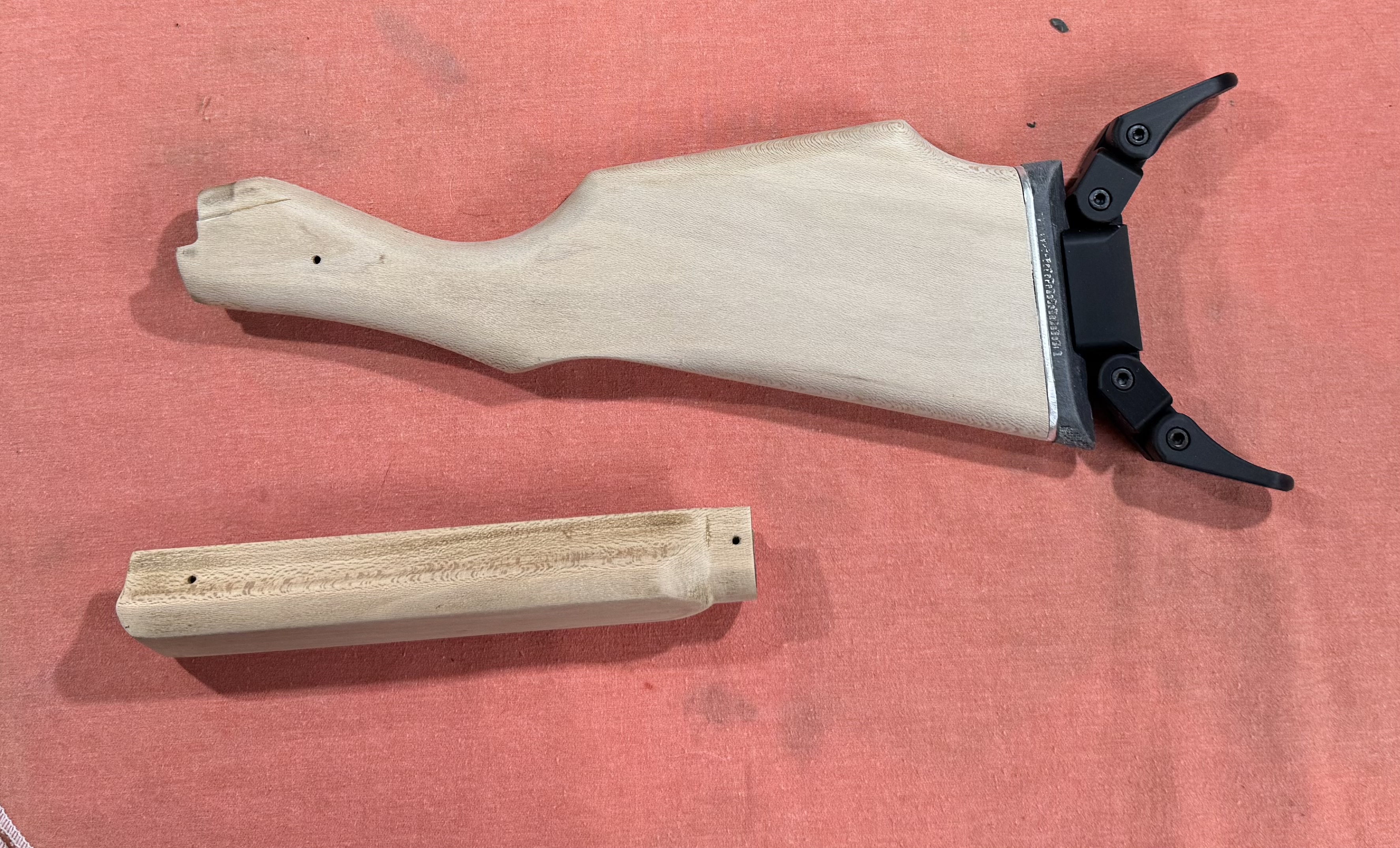

you could use pellet scraps from your pellet trap , if you need more weight in that small trough ?I think it will look good. I did some test pieces but on a different wood type. As long as it’s consistent it will be fine. Going with oil stain and danish oil finish.

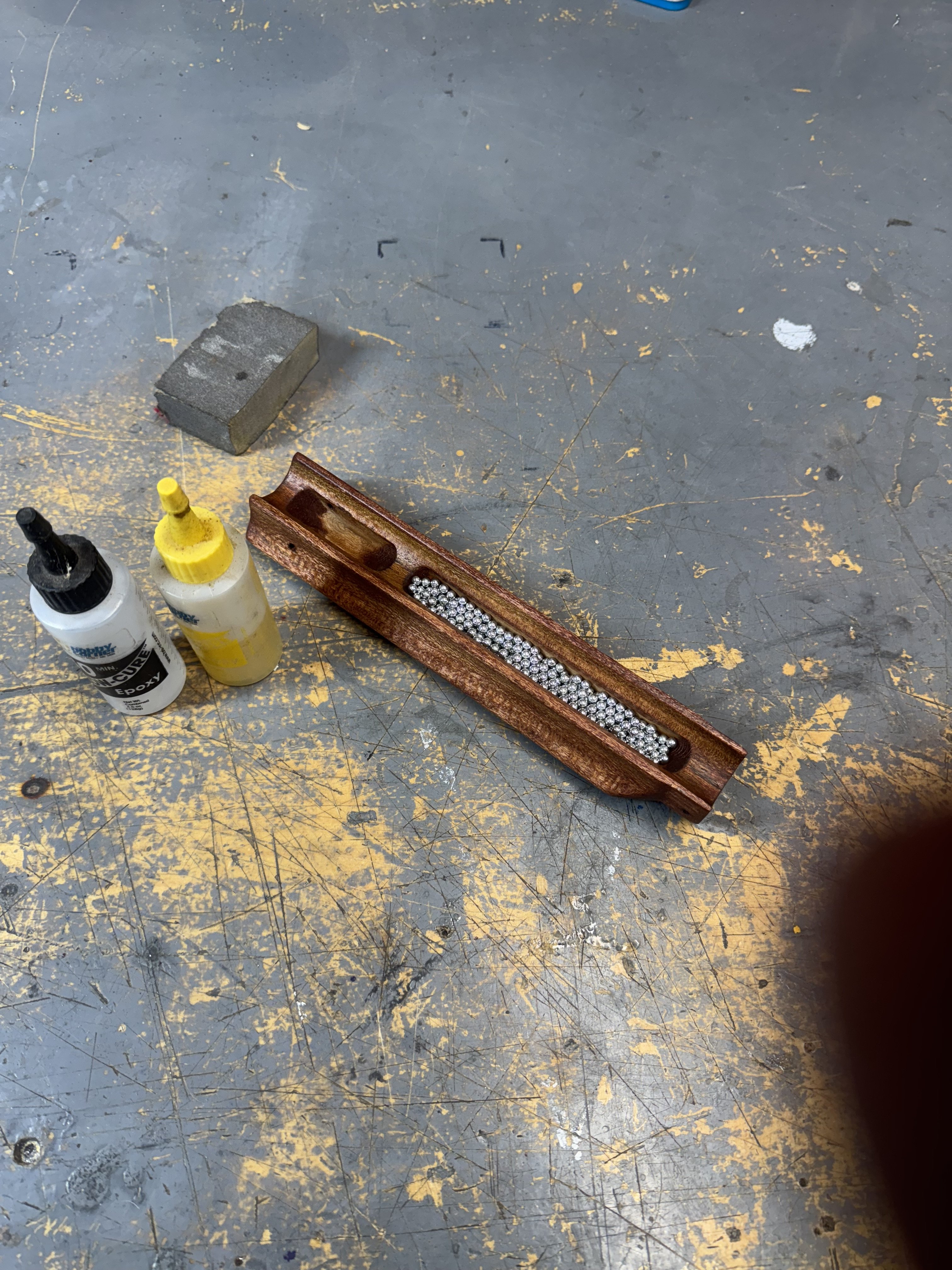

I am probably going to fill the forearm trough with BBs and epoxy for added weight.
Hey maybe external weight at forend?I have lead tire weights . I just thought BBs would be cool. I am now realizing j can’t just fill the trough up. I need to figure out the balance point and compensate for the butt hook.

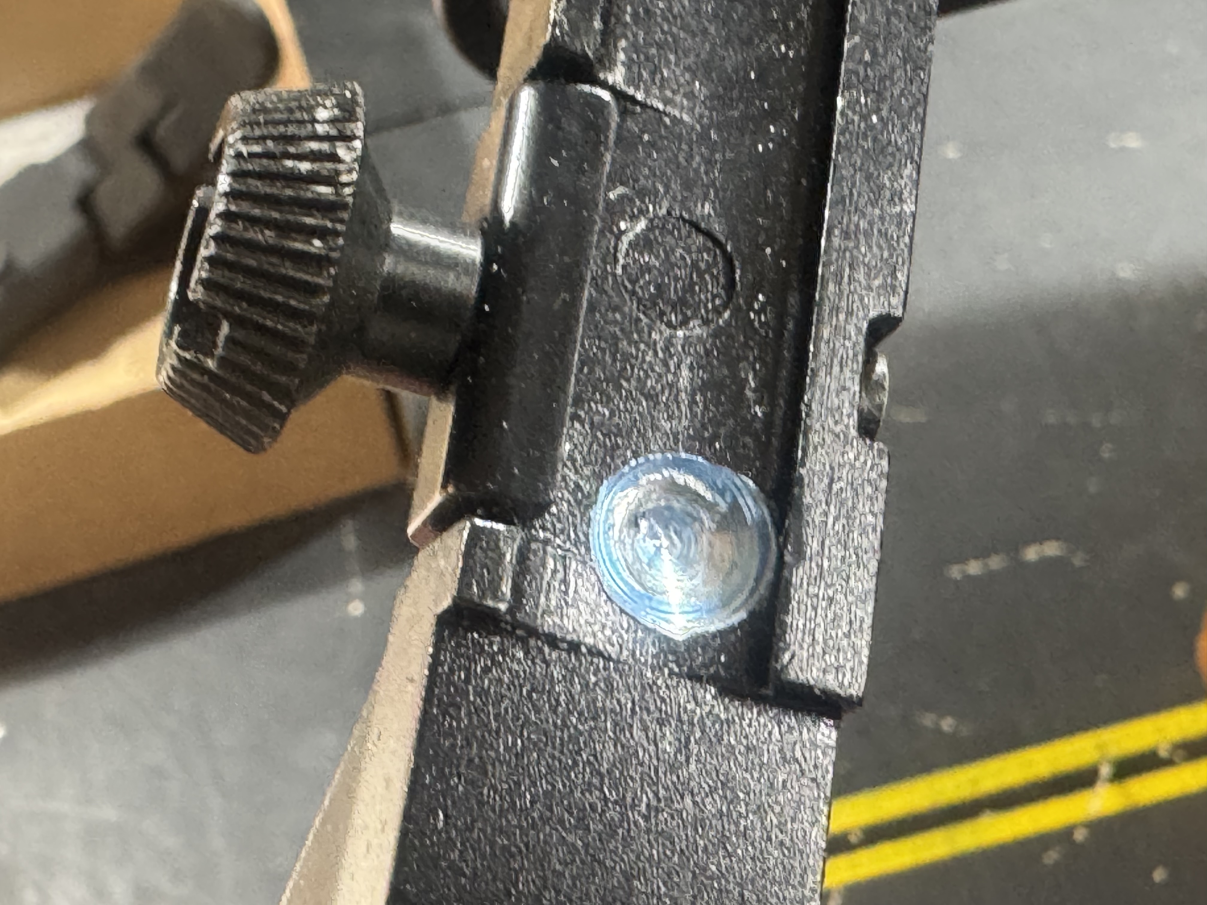

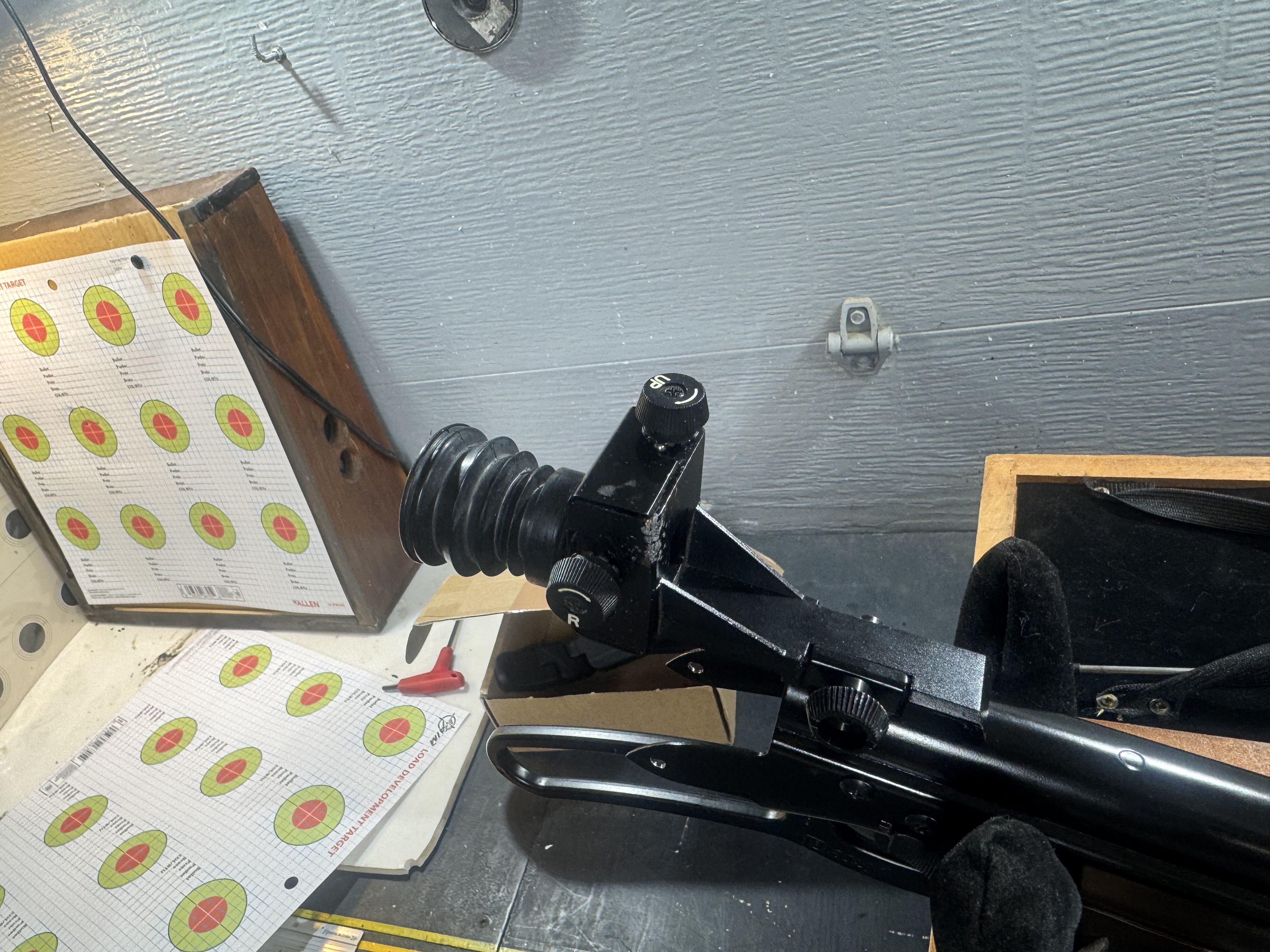

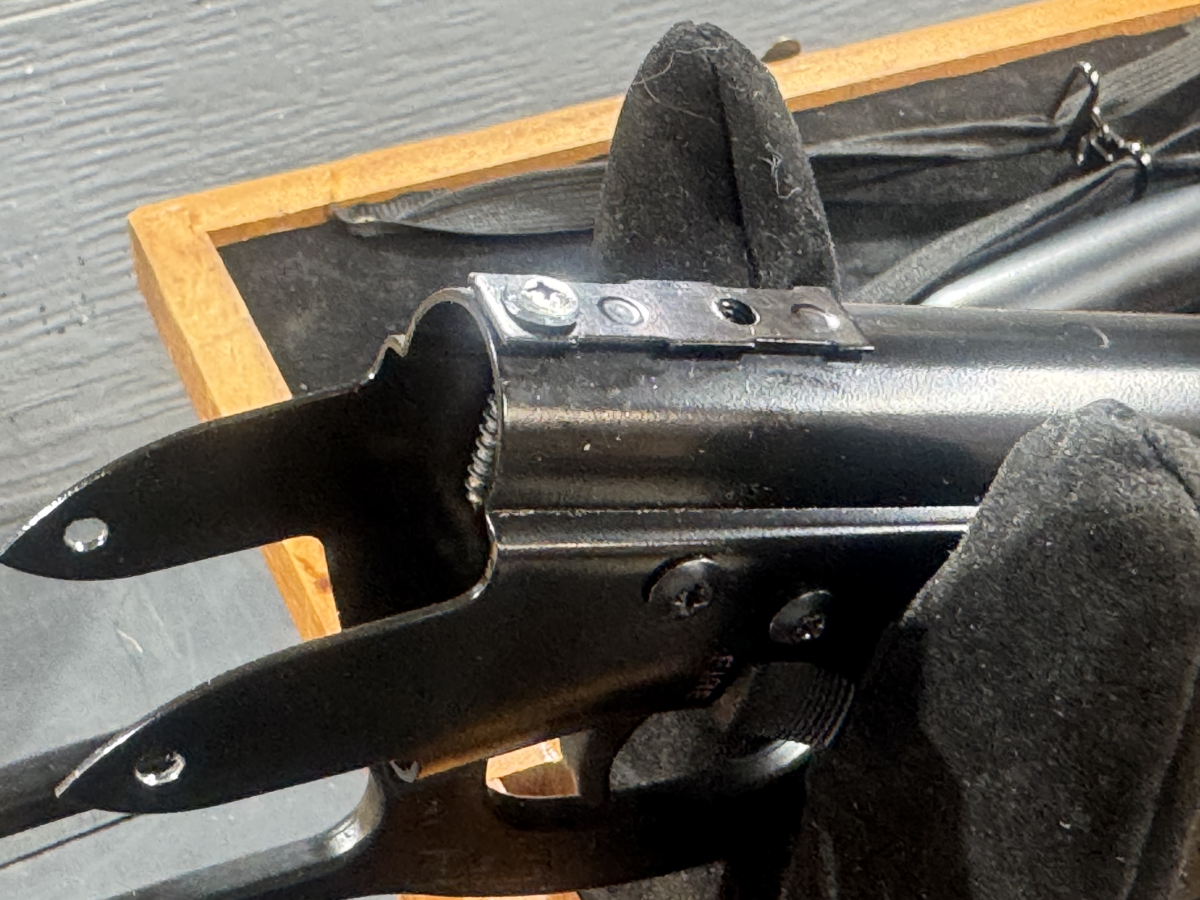

And metal Diopter sight. It is big but line up great. I did have to make a special screw and recess the head a bit to get it to fit Perfect.
It sighted in without a stock fine. So I think will all work.
The sights fits the weld on sight mount but the original screw is in the way. The mount is made up of two pieces of tin welded to the action. I used a slight countersink to put a bevel into the sight mount. And I drilled a slight recess in the bottom of the sight. Be careful here, there are springs under the clamp and you don’t want to drill into the cavity.I have one of those rear sights sitting around. Did it fit the base that is tack tack welded on the rifle? I really don’t have an issue with the factory rear sight.

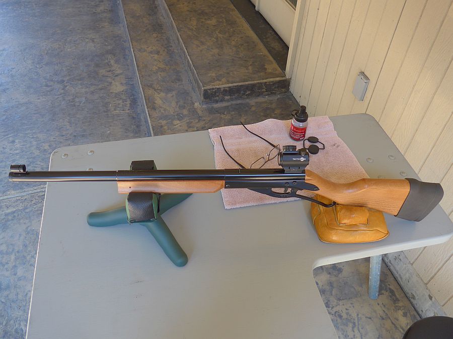

Depending on how you want to use your 499B, you can also put a red-dot sight on it.I have one of those rear sights sitting around. Did it fit the base that is tack tack welded on the rifle? I really don’t have an issue with the factory rear sight.
