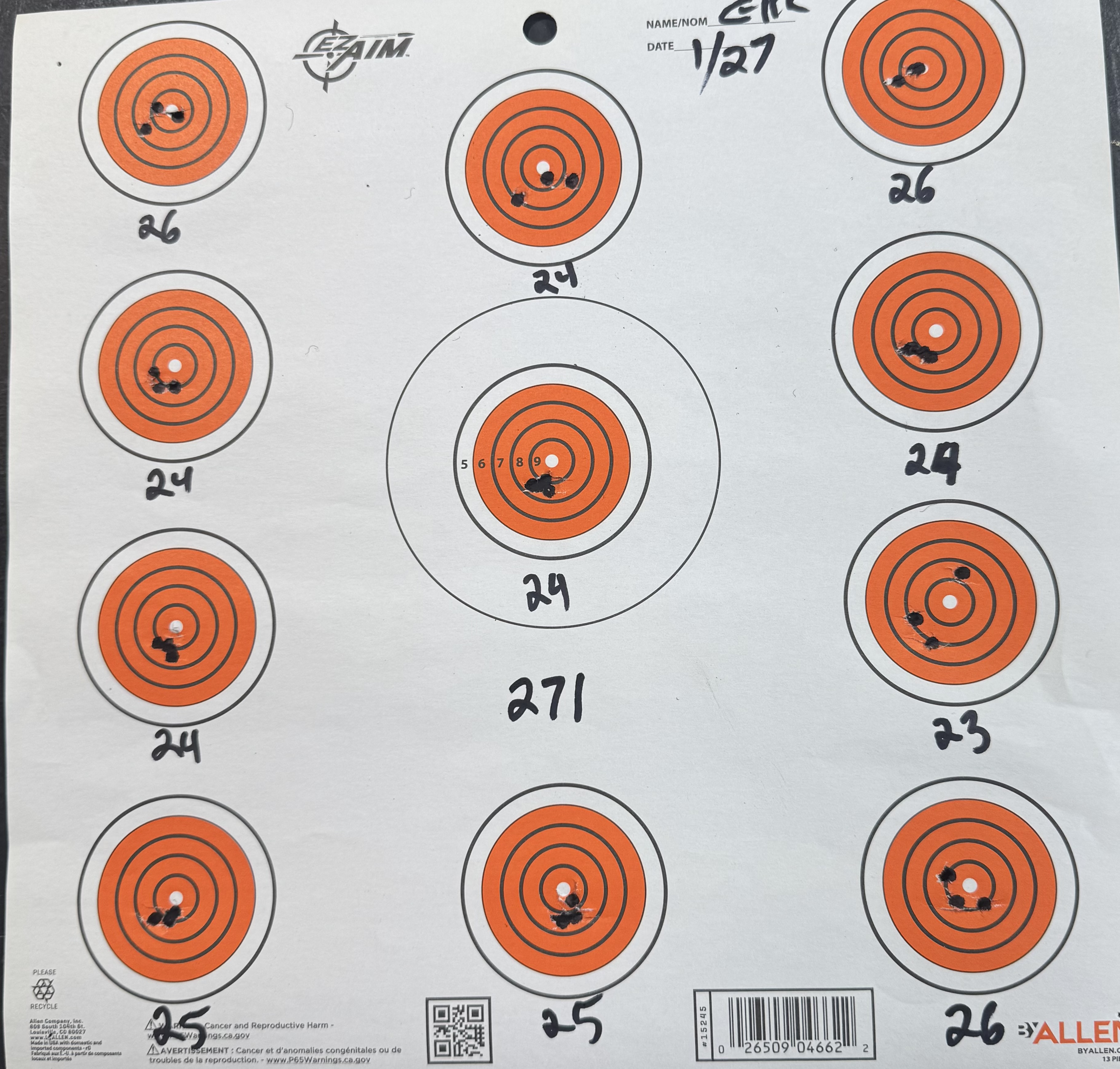

I had to clean the barrel again. I need to do a better job of washing the used BBs.
BIG WARNING!!!
Never clean a 488 barrel while it is in the gun!
If you run a cleaning rod down the barrel and touch the magnet it can easily pop the magnet through the abutment washer and ruin the gun.
Any how 271 I really don’t feel bad as the last three targets lower right were affected by the barrel .
Also don’t over tighten the barrel and I am going to mark my barrel so I get it back where it was sighted in.
BIG WARNING!!!
It sounds like you need a cleaning rod with a stop built into it.
