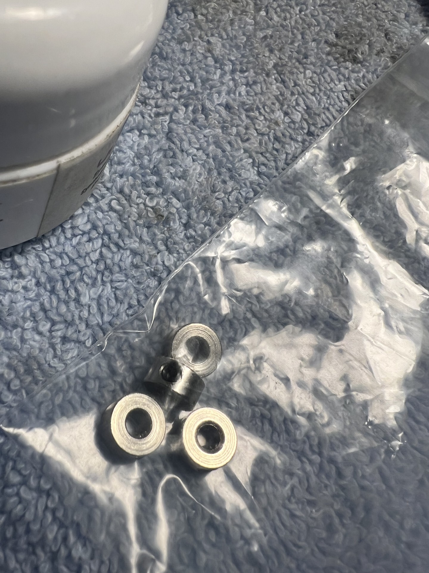

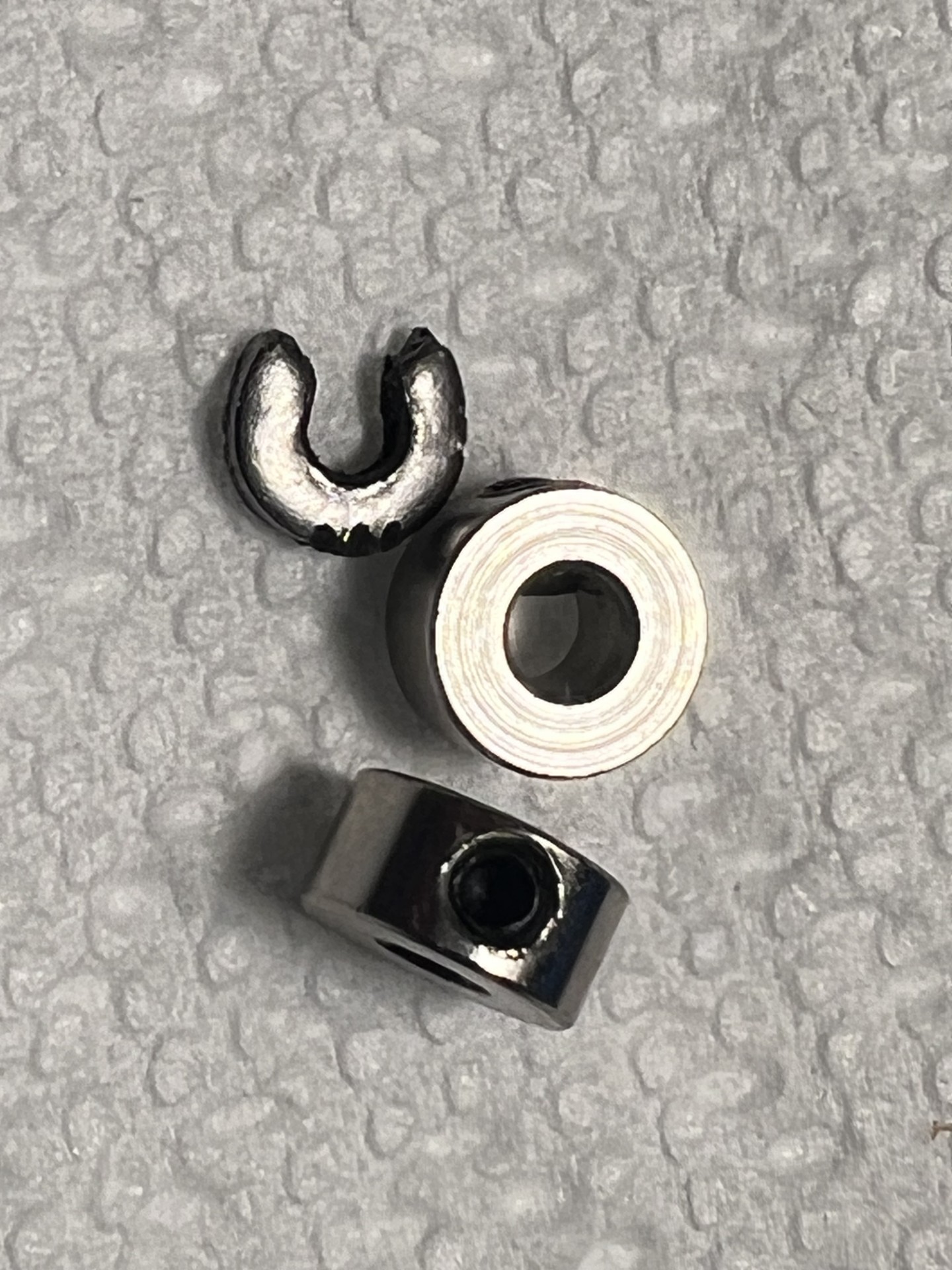

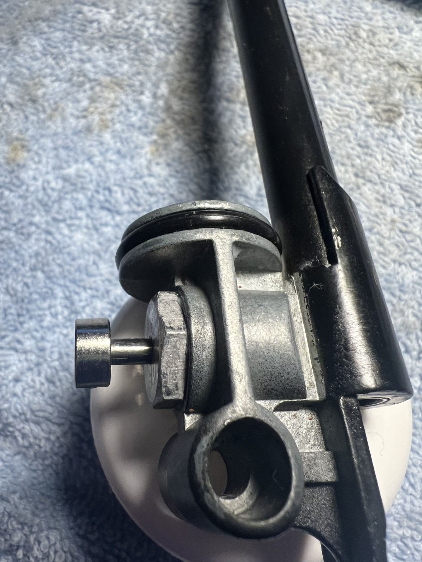

i have been work on a miss behaving Daisy 717 it was leaking and then it was not dumping all of the air but if you need to work on the valve they have a that steel clip that is a PITA to remove and put back on
i said to myself, there has got to be a better way and bought some 3.05mm ID collars and they are a better way
now for the guy that has just one pistol maybe not but for someone like e that has many of these and likes to tinker maybe so
it is an idea no more no less
the other thing i did was change the 006 Oring to a 005 on the stem and we are testing as i type
