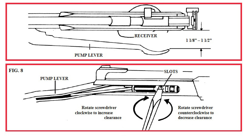

I bought a new 717 about 2 years after they came out and the velocity out of the box was about 354 fps. I checked the adjustment of the pump lever to the receiver and the distance was just 1". Adjusting it to just under 1 1/2" and the velocity increased to 382 fps. This was with H & N High Speed pellets that weighed 7.2 grains. The don't make these particular pellets anymore.

The key is to carefully adjust the seal as close to the bulkhead as possible on closure of the pump. (We call it dead heading in UK) also used Pellgun oil which has an O ring conditioner in its make up, oiling the felt wiper…to get the best out of the O ring condition.
One more thing worth doing, is lapping the front face of the piston, which has crude casting marks on it….a sort of casting ridge standing a good few thou up on the front face. Smooth this off flush by sanding the face down on some wet and dry 600 grade…then performing the dead heading procedure above gave me another 10 fps. I had H&N match running 405 fps. 411 fps, 408 fps.
