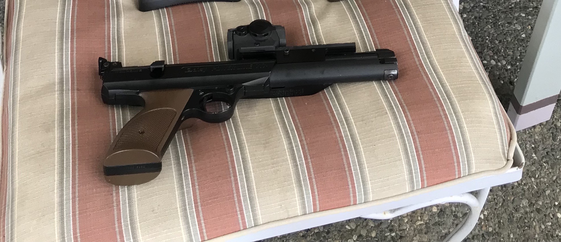

I had a Daisy 717 sent back to the factory for a rear sight replcemt and piston repair. It was not holding air. The gun had been unused for many years. It was a training tool I had when I was a competitive pistol shooter. I recently got involved in airguns and took it out of storage to tinker with. I mounted a dot sight and shot it at 10 yards along with my air rifles. I previously only shot indoors at approximately 5 yards(15 feet). No issues experienced.
I got on target surprisingly quickly and groups were centered up. I just noticed the impacts on paper were not round as compared to the hits from the rifles. I then discovered the pellets were keyholing. I shot a group on a fresh portion of the backstop and it was obvious.
Question: gun seems to function as it should. I added a few more drops of ND30 oil on the seals just to make sure the piston is functioning. I was unable to see and damage to the bore. I tried diffepellets ranging from 6.9 gr to 8.44. All diabolo WC or dome pellets. All will keyhole. Walking to to 10 feet, the keyhole effect lessens… but sttill there.
Send back to Daisy? Any gunsmithing local to Tacoma WA? It was originally tuned by Roddy T of Eugene OR.

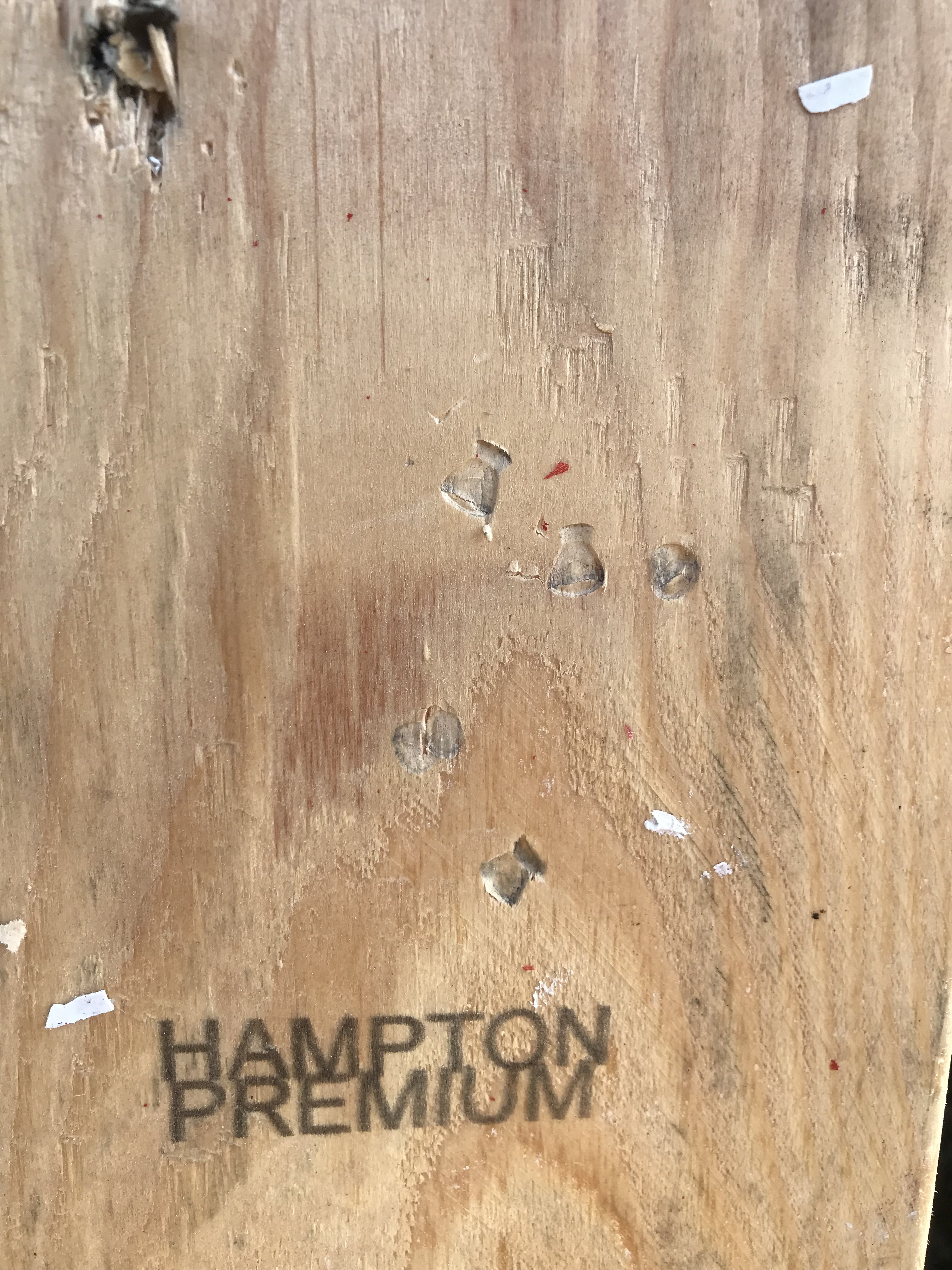

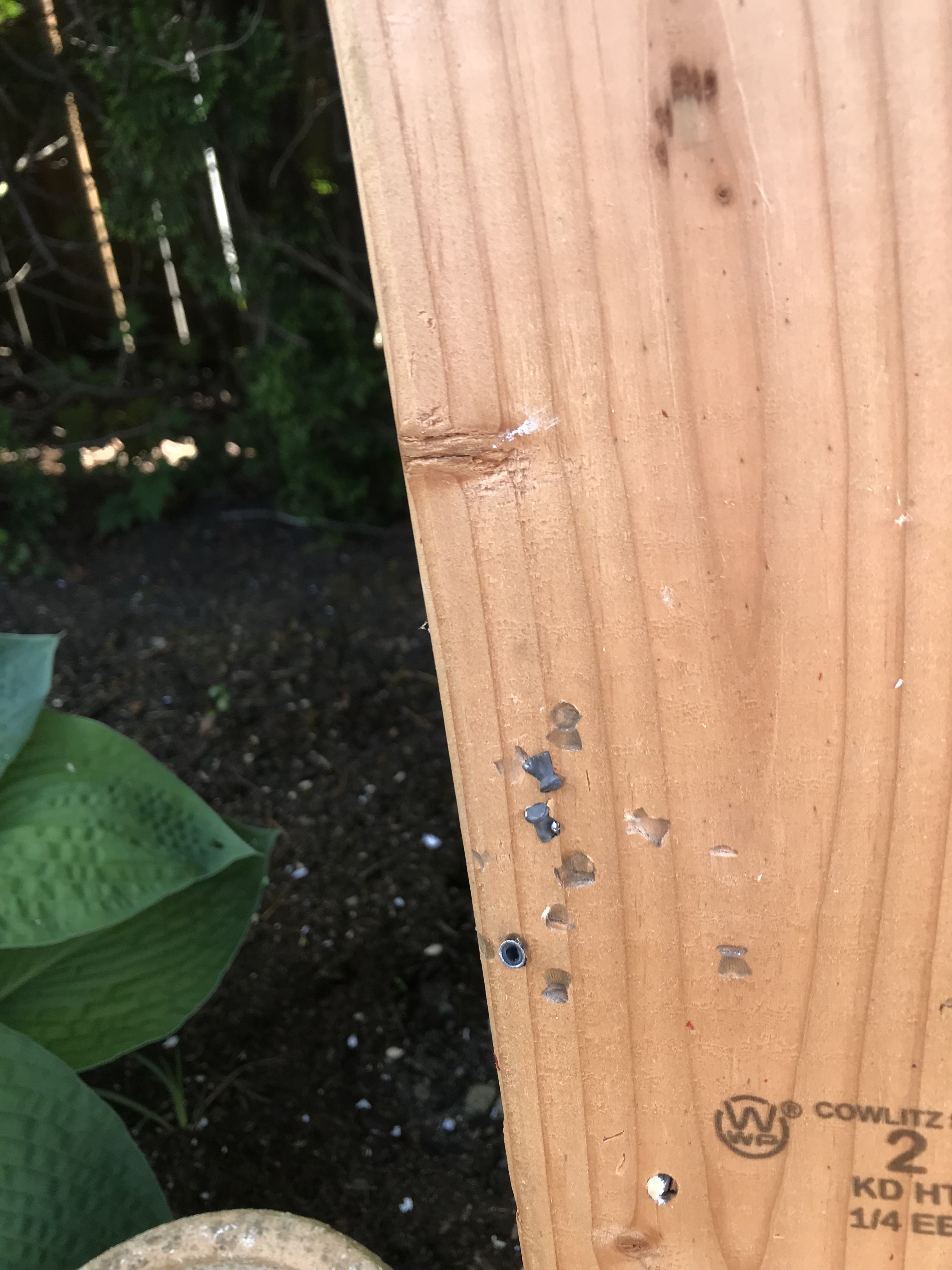

Can’t do it that way with this gun… will shoot a few into a stock tank with water tomorrow and look at the recovered pellets… never done ballistic forensic on pellet guns before… this will be discovery learning
