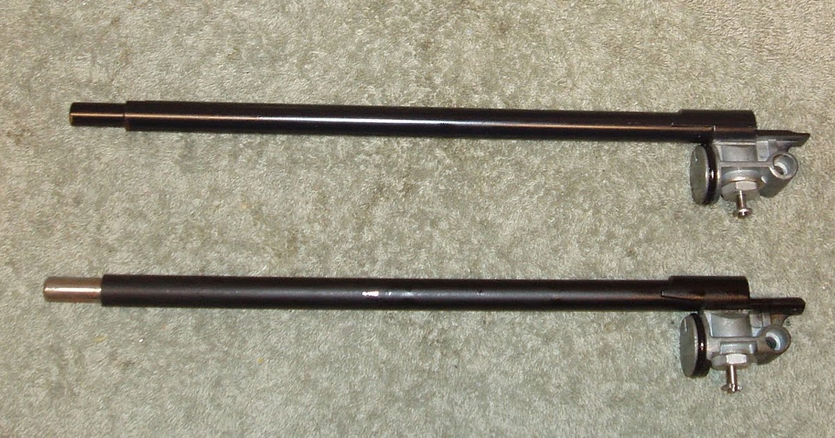

so how do you find the leak
a large bowl of water and the barrel assembly held in with a punch the bubble will let you know
out the barrel bad valve
out the valve stem two Oring in there
out the tube at least the back side but you have already done the the two in the tube
it is case of chasing your tail
