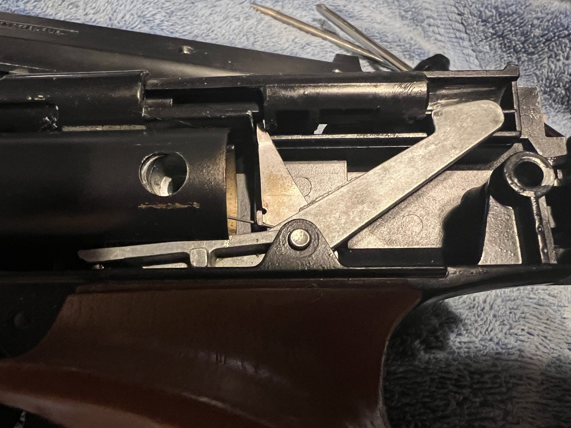

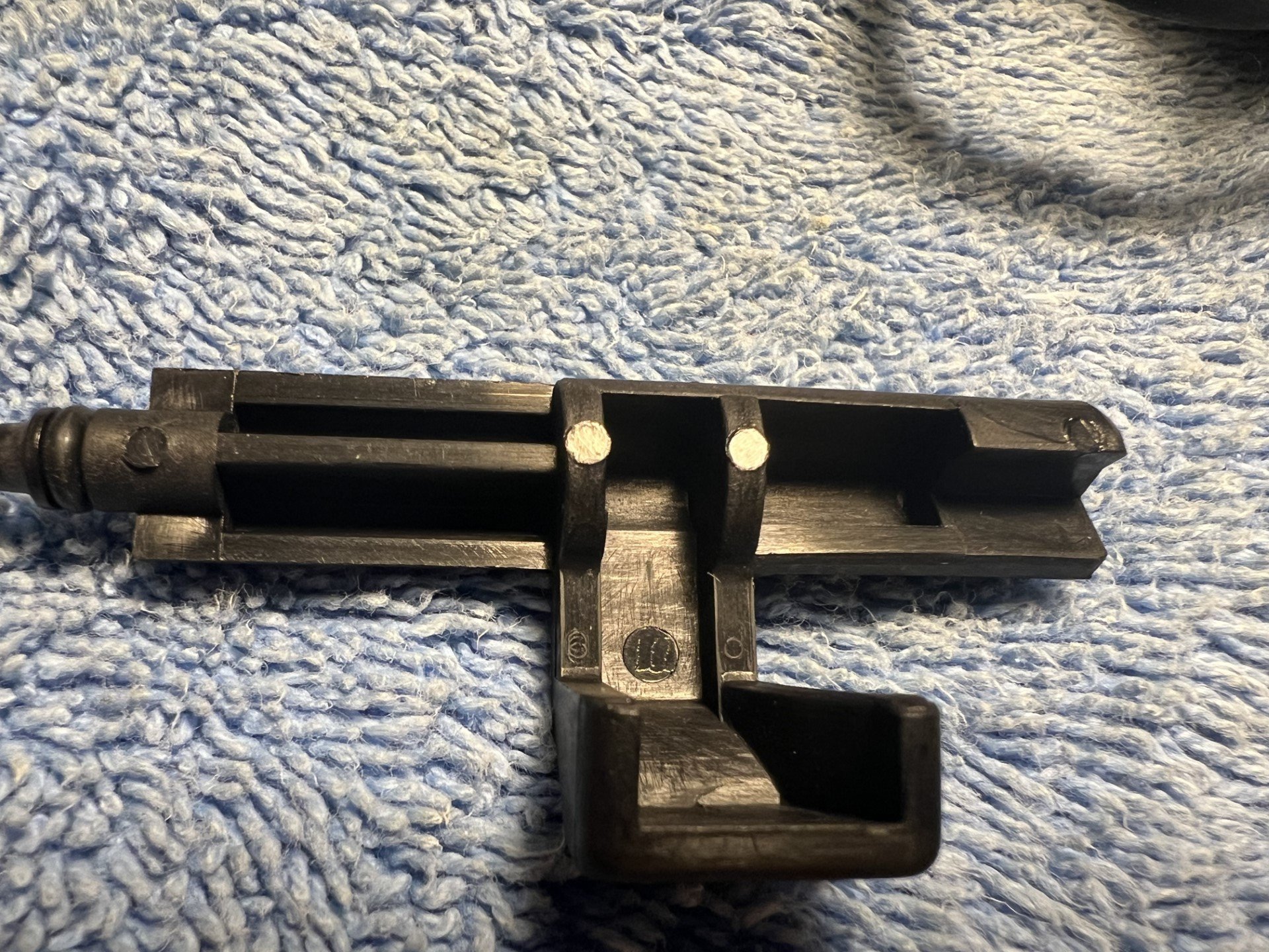

the silver V is up against the bolt and the bolt hold it forward and is under a small amount of spring tension
and a new bolt that might be your fix
It stopped doing it today. I did oil it yesterday, and it was still doing it, but it has stopped for now. I ran 5 shots through the chrono, and they were all above 380 with the first being just over 390 fps. I may take a center punch and make a couple of divots in the bolt where it won't be noticed. That might provide some friction to stay in place.
power level is great, the bolt is behaving just shoot it
