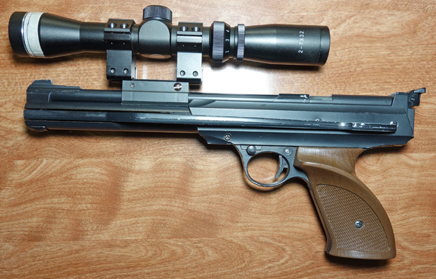

This gun is 26 years old. It has been fired thousands of times over the years and the seals and some parts have been replaced. Back then I found the most accurate pellet to be the Beeman H&N High Speeds, which weighted 7.2 grains. These are no longer being made. I tried the RWS R10 WC pellets several years ago and these now are the most accurate. I have tried 21 other pellets but the R10's shoot the best in the 8 and under grain pellets.
