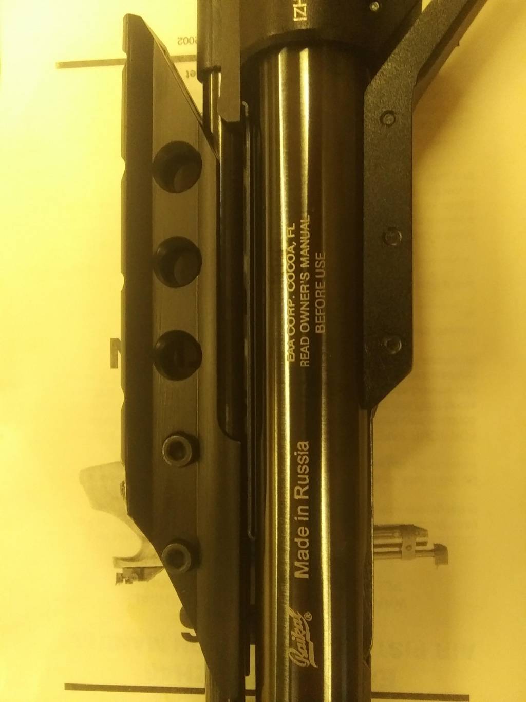

I don't know who made this but it was on a used Daisy 777 I bought that now resides on my IZH46M.
I have successfully used 22 quick peep see through rings with makeshift shims using small PVC tubing cut in half length wise to grip-shim the barrel similar to like the Leupold rings on a Daisy 717.

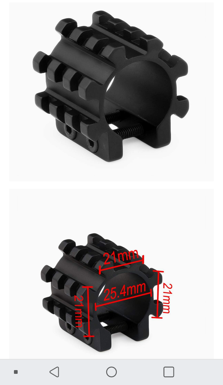

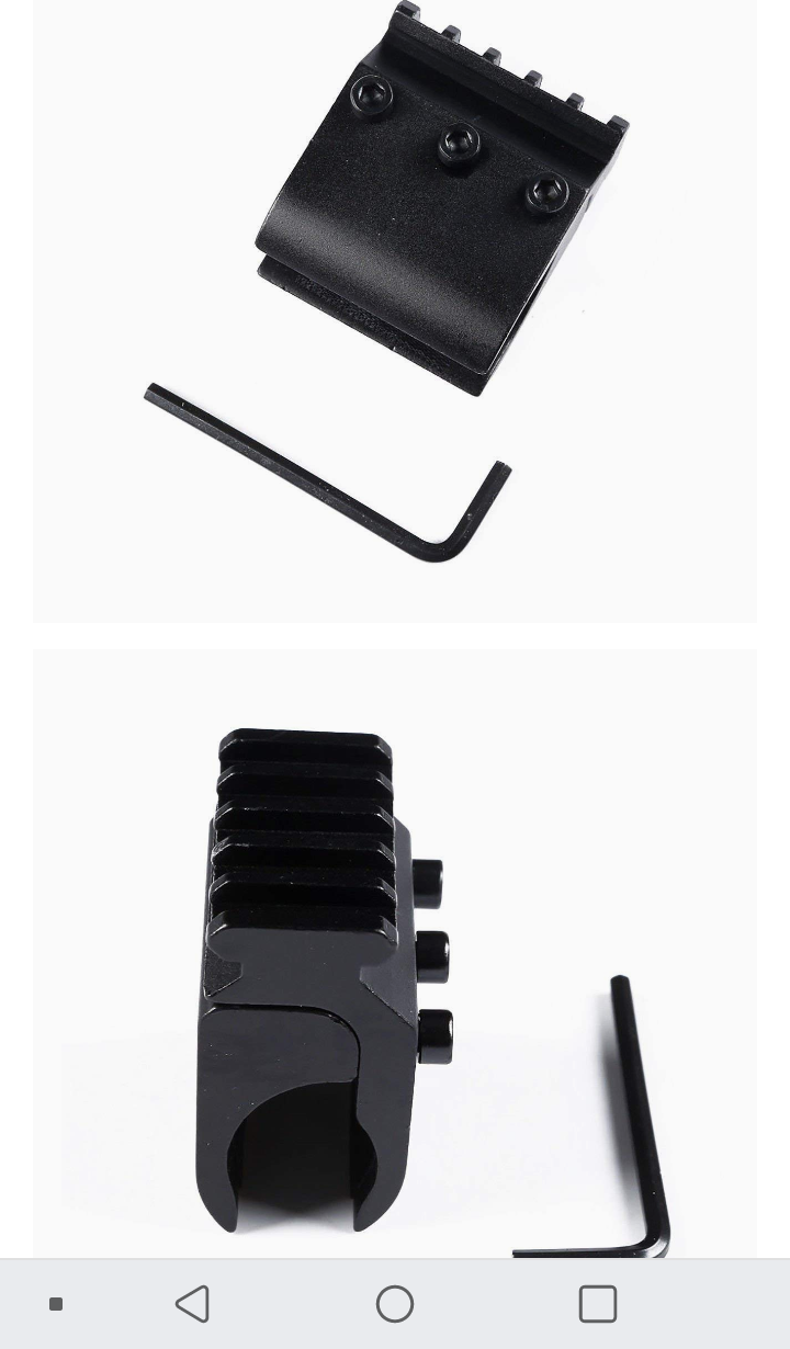

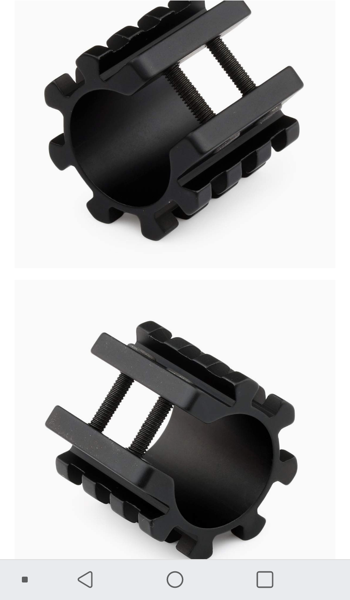

Natchez Or Midway or your local sporting goods store or gun shop may be cheaper. Don't buy this one from Amazon they're most expensive for these $10 rings. Picture for illustration purposes only.
Another interesting PICATINNY option that may work for Daisy 7x7 sidelever pistols and IZH46M below. Use small PVC cut in half length wise to shim barrel to clamp them.

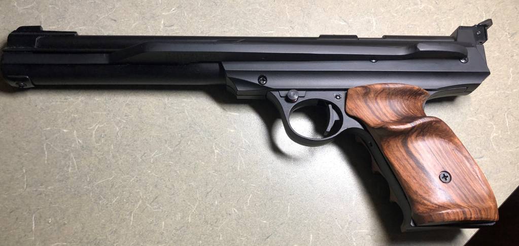

View attachment 115282A look at the custom grips on my Daisy 747. Much nicer than the standard plastic panels.
Good afternoon, I needed help in relation to the handle of the Daisy 747, I recently bought one and it comes with the plastic ones it comes with, could you help me tell me where you bought them and if possible, do they make them or are they left-handed?
Daisy used to sell the plastic grips in left handed. The guns were all sold with right hand grips, so you had to call Daisy to get the left handed ones for a decent price.
Don’t know if they still sell the left grips now that they have discontinued the pistol.
Worst case, get a couple blocks of wood and carve away anything that doesn’t look like a grip…
Good luck, hope you are able to find some grips.
