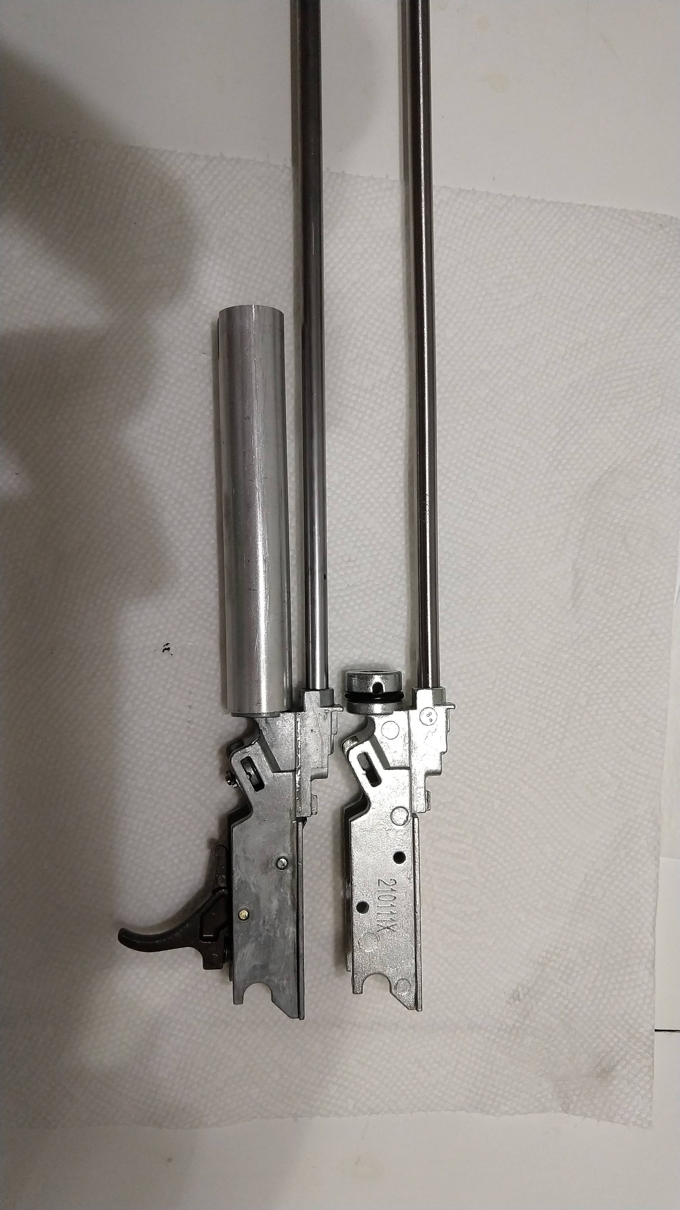

I've a friend whose childhood gun was the 901. I actually re sealed and rebarreled his for him a few months ago. His was shot a zillion times so yours being NIB is different. It may seal up and be just fine or may leak. You'll have to find that out.
As for #1 , we all would recommend Crosman Pell Gun Oil. Some people make their own out of Automatic Transmission Fluid (the good Alphabet org lol) but those little tubes of PGO work great for me. Like $4 at Walmart.
As for #1 , we all would recommend Crosman Pell Gun Oil. Some people make their own out of Automatic Transmission Fluid (the good 3 letter organization lol) but those little tubes of PGO work great for me. Like $4 at Walmart.
