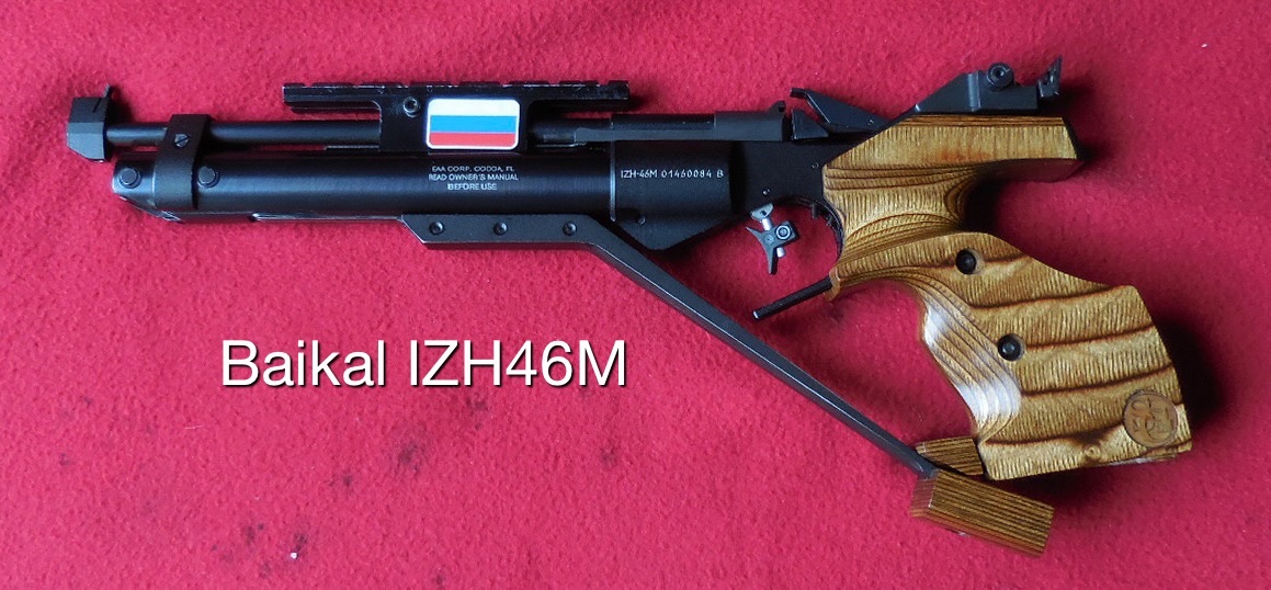

the best true target pistol is the IZH46M

the IZH 46M is the best pistol and the most problematic at the same time, with the Russian sanction there are no parts and when that will change is unknown i own one and it is very nice

so, if i had X amount of dollars i would still look for the 46M and the why is, it is the best pistol and you can add the Daisy at any time there is no shortage of ones selling on the secondary market

I also have a couple of the IZH pistols. Honestly it is easier to cock or charge with air due to the complex linkage of the piston, Sights are excellent and the trigger is absolutely out of this world. Mine are probably down to about two or three ounces. One of mine is an AV model that had the red black laminated grips, which I did not care for, and acutally starter splitting in a couple of places so I replaced them with some nice walnut grips from Rink. The other is a pure IZH with the beech grips that were rather blocky until I modified them to fit my hand. Now they fit, and look like a set of target grips instead of a block of lumber. Basically I created some finger grooves on the left side of the stock where my hand wraps around instead of having a square edge. I took the wood down over several weeks and stages until I got it to the point where I though no more removal of wood would help any, then smoothed and refinished with some tung oil.
If you want a pure target gun go with one of the IZH guns. I know parts are and may be a problem but then they are no longer replacement parts for the Daisy guns either. About the only thing you should need for either is O rings, and those are not impossible to find. I actually got some "kits" with polyurethane O rings for the Daisy's a couple of years ago off ebay, but no longer see the variety that was available. The ones I got used some split teflon washers or rings vs a foam wiper to hold oil for the cylinder, so no worries about foam breaking down., but again, I no longer see them available.

I have dad the Daisy’s and three 46M.
Traded 777 for one of the 46m.
I gave the 46m to my son.
Gave one more to my friend in Kansas.
Should have kept them.
No one gets this 46M:
