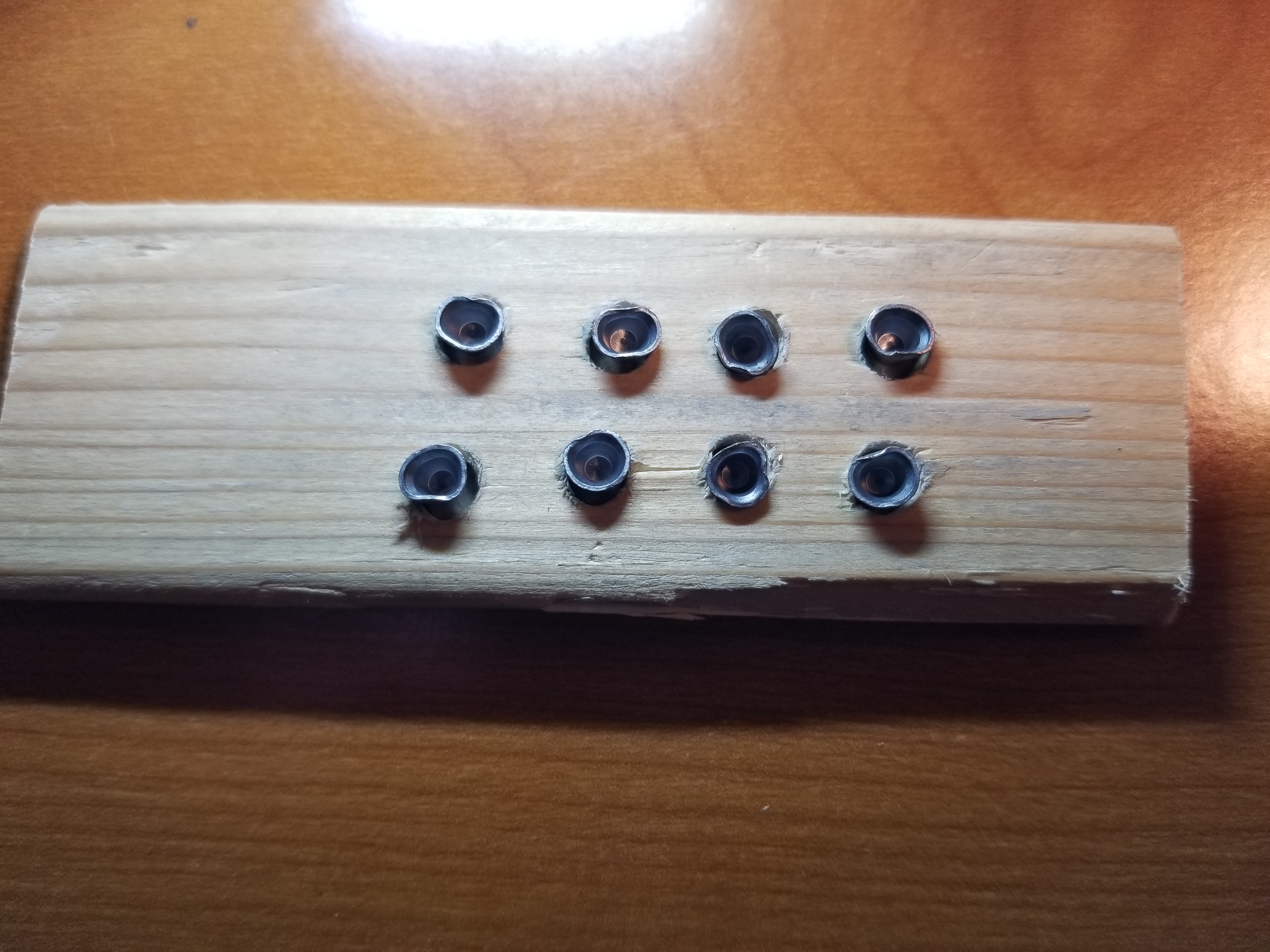

You are right. For grins, I reconducted this experiment after rebuilding my gun. I found a retaining nut on my valve was backing out and was allowing the valve to wiggle around in there a little. The pressure held it into place, but it allowed for some inconsistency.
Here are the new, bent pellets:

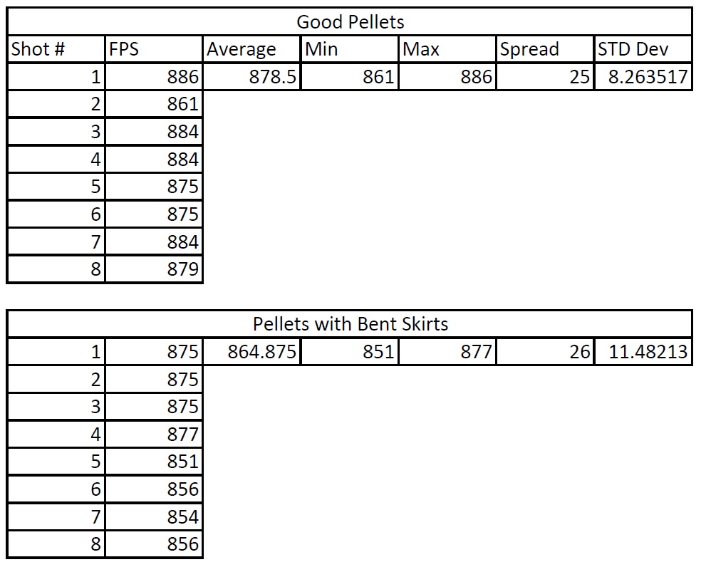

Finally, since I rebuilt my gun, I ran the numbers again. They were marginally better, so here they are:
So, in conclusion, I got the same results. I won't be throwing away my bent pellets any more and will save them for plinking. They are definitely good enough.

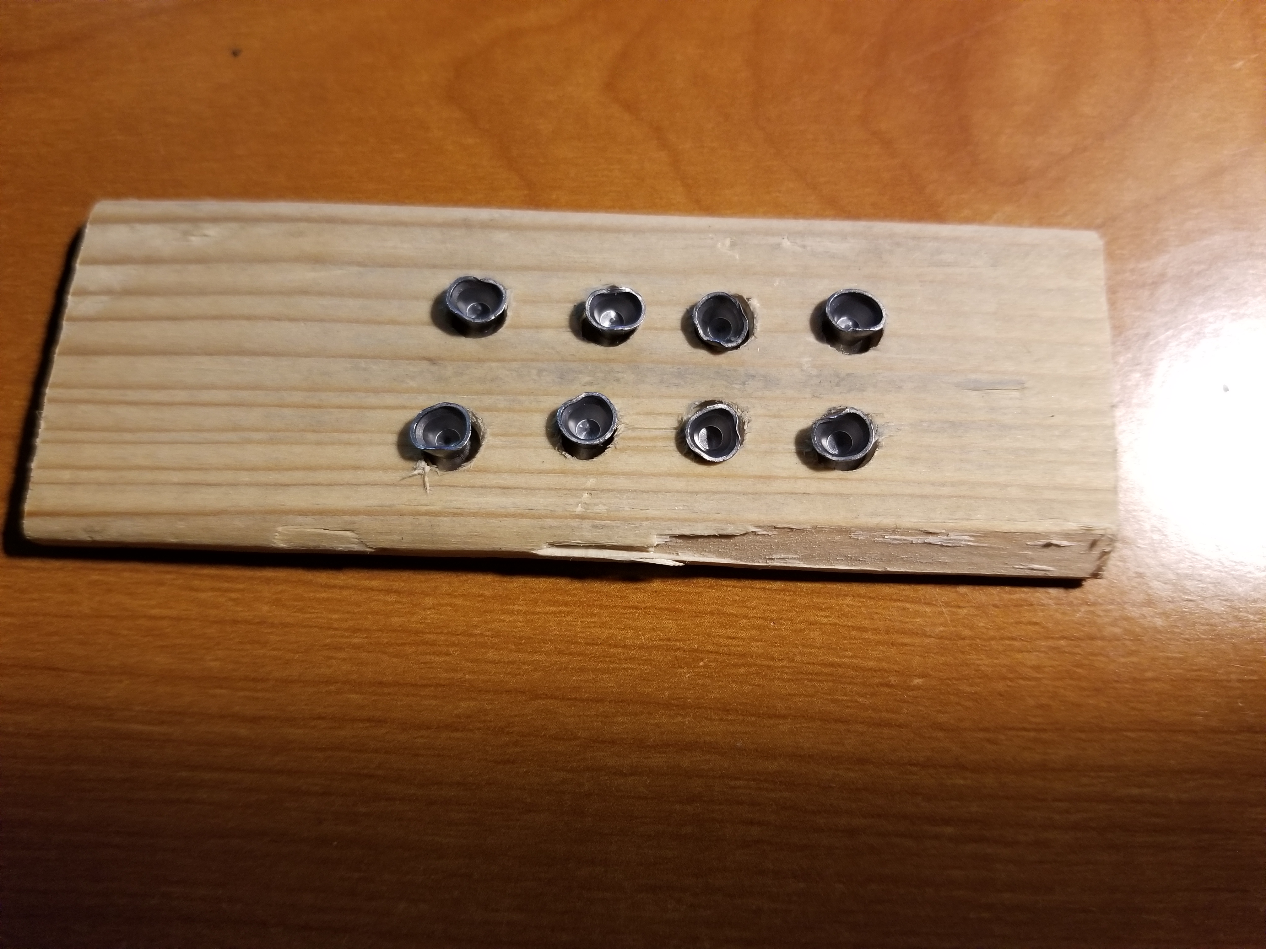

Years back I had the same pellet issue with the CP lite pellets. I used a piece of pine wood and drilled about 60 holes with a ball nose cutting tool into the wood. Just deep enough to allow the skirt to stick up above the surface mabey.030". This blovk of wood fit into the old Crossman Premier pellet cardboard box. I saved all my damaged skirt pellets and still do today even though I switched to JSB 8.4 pellets. When I get a bunch and that can be often, I drop them into the box with my drilled wood block and shake it around....most pellets drop into the holes head down ( heavy head) then I use one of the old Beeman pellet seating tools..the tapered end, and push while turning into the damaged skirt....rounds it right out, looks like new again !! They even shoot like new undamaged pellets. Best thing is you can do a bunch at a time. When you gave all the skirts trued up, just turn it over and bang it on a towel and most of the pellets fall out...some might need a fingernail to get them free. The fact that you can do them in quantities makes it a worthwhile step. Very few pellets get tossed anymore, when I get a bunch of bad obes, in 10-15 minutes they are good again. Get a ball nose cutting tool ( end mill cutter) slightly larger than your pellet head, the soft pine wood protects the pellet head while you gently round out the skirt and you have good pellets again...try it..you will like it !!
Reactions: crowski
Would you mind posting a couple pictures of your block and how you are using it? I believe that I understand what you are talking about, but a visual would really help. Thanks so much for the tip and (hopefully) the visual!!

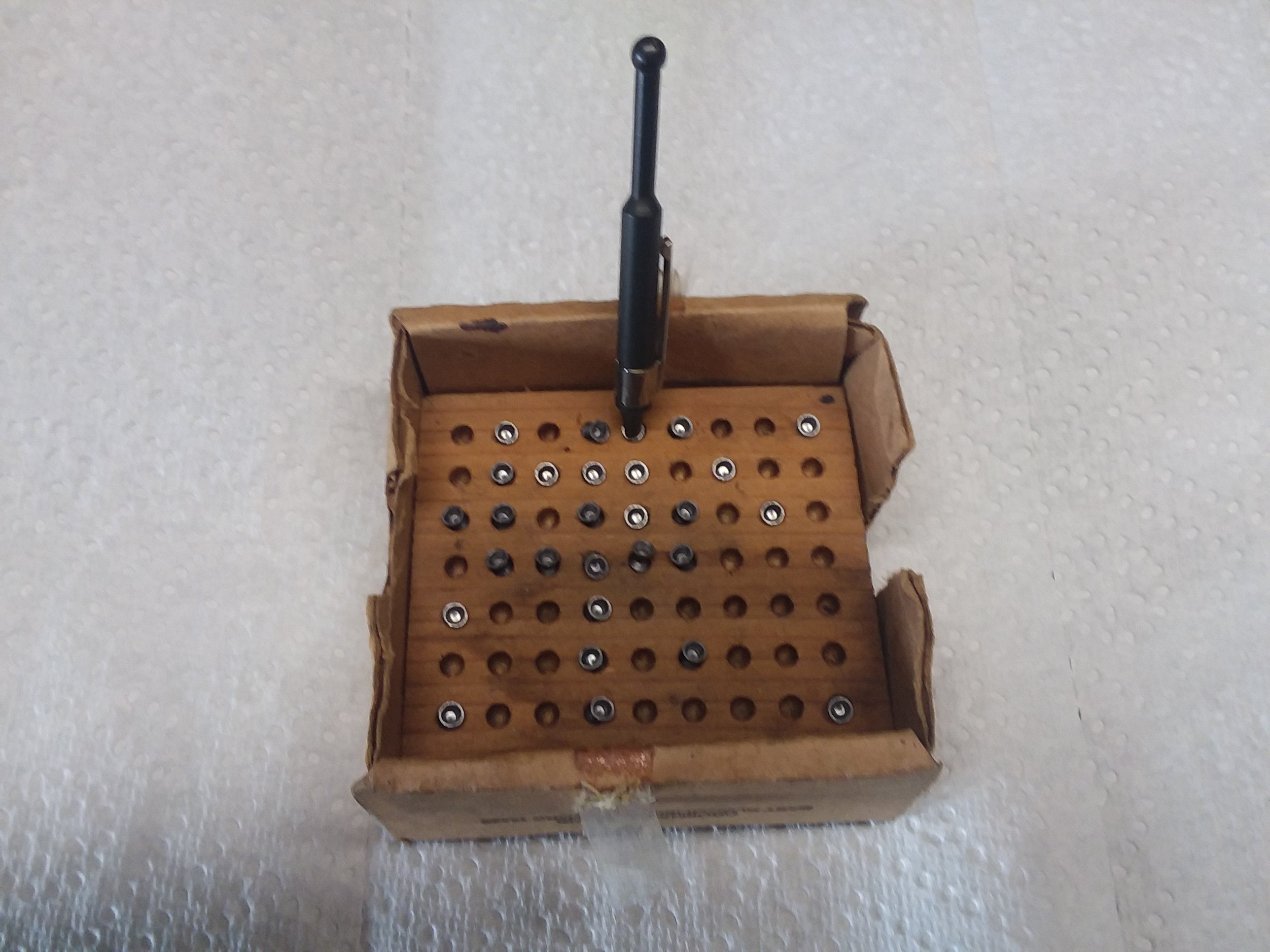

Hope this helps, makes crappy pellets better!!
As you can see, this has had a ton of use !! Started back in the late 80's when the SR came out and many realized some of them shot better with expanded skirts. This started as a skirt expanding tool, but as pellet quality began to suffer, I made a number of these for people to make better pellets from what was on the market. Started using JSB when I bought another TX 200 3-4 years back, shortly after, their QC began to suffer so I dug out the skirt repair tool again!! May not be perfect but a definet improvement for squished skirts. I haven't shot competition in many years now, but still enjoy accuracy!! Most of my informal testing shows the repaired pellets shoot just as well as new undamaged pellets. And you can repair a bunch in a very short time !!
