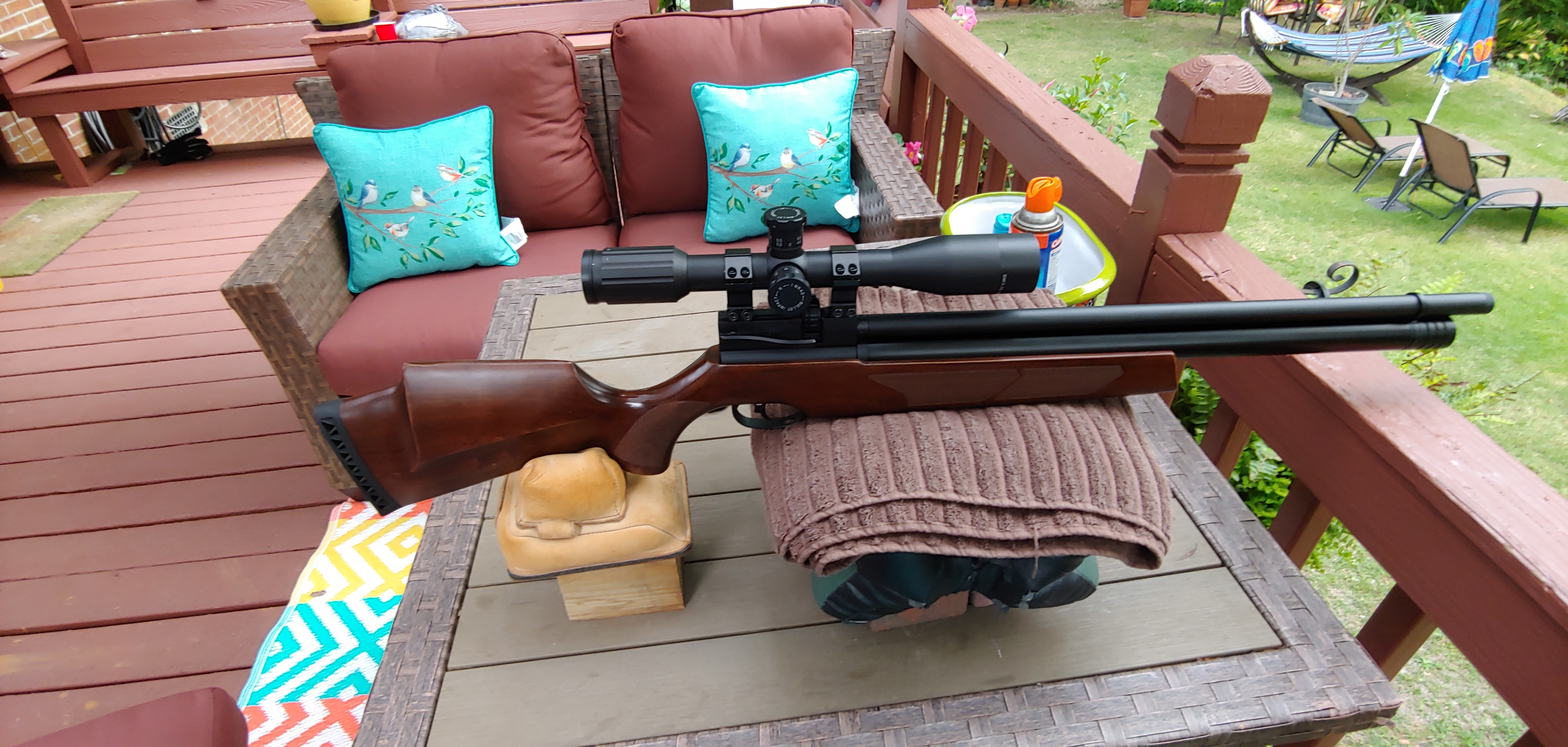

When I bought my Gen2 .177 DAR, the plan was to make it work at ~750fps with the CPUMs like my Fortitude.
However, when I adjusted the HS tension trying to lower the fps to ~750fps, it became very erratic (fps) and I could never get it to settle down. So, then the plan was to adjust the regulator (void the warranty), but I never could get up the courage to take the gun apart and do that, so it simply sat for about a year without me even touching it.
Then, relatively recently my Fortitude lost accuracy and was frustrating me to no end, so I took the DAR back out and decided to simply use it as it came. I adjusted the HS back to where it was originally (adjustment flush with the end) and testing with CPUM. No go.
Bought a variety of 10+grain pellets and started testing with those. Nothing seemed to work until I got well over 500 pellets through the gun... and it may have jumped to 920fps during this period as I didn't chronograph it on a regular basis.
Anyway, at least for a while, it was grouping sub MOA with the FX/10.3 pellets.
The last test, tonight, it was not doing nearly that well. Didn't feel like pulling out the chrono, but will do that again soon.
It has potential, but consistency is everything... (heavy sigh)
