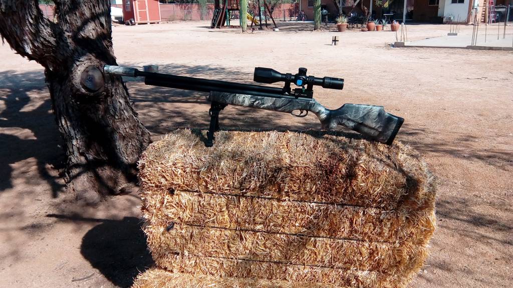

I Took the D3 in .25 out yesterday after work in 15-20 mph winds to see how the NOE 249-39-RF-E6 slugs would perform in heavy, gusty winds. Much to my surprise, they only drifted 2" at 100 yards. The 25gr Kings I shot last weekend would drift 6-8" with only a 4mph breeze.
I guess I wasn't expecting such strong resistance from deviation.
I was also amazed at the accuracy and while there were no MOA groups, the slugs held the same pattern and spread they had at 50 yards all the way out to 100 yards. Yes, the groups were bigger but very much in relation to the distance.
At 50 yards, I was getting 1" plus groups and at 100 yards the groups opened up to 3". Time for some barrel work, polish the crown, polish the bore and lead. some as well.

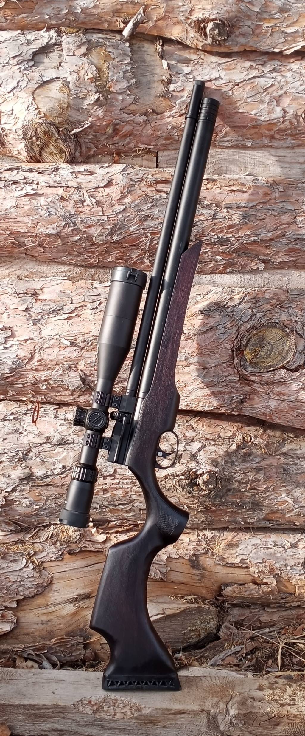

So far I'm digging my DAR in .22
Well balanced feel to them, I may have to grab a 25 caliber. Mine is doing 30 shots at 32 fpe with just a turn of the hammer spring from what it came set at. I need to get some groups, but its been raining all week here. Today is nice but unfortunately won't have the chance til the weekend.
