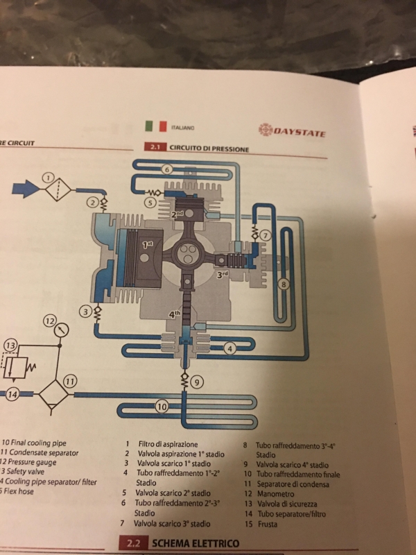

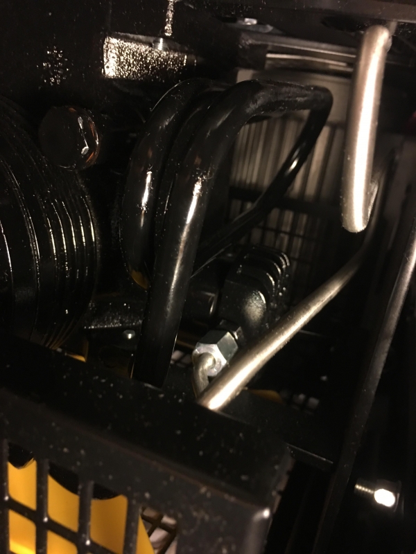

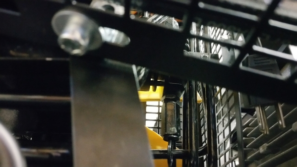

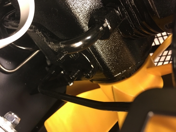

Eddy, back when AoA sent whitetail a 3 stage by mistake, I remember a thread about this. I was double checking everything to be sure they sent me a 4 stage like I ordered. To my understanding the 4 stage has 4 pistons. Looking at it from the belt side, there will be one at 9, 12, 3 and 6 o'clock. The one at 3 o'clock has a pressure release valve(I guess) that sticks out the bottom of that piston unless they changed that on the newer ones:

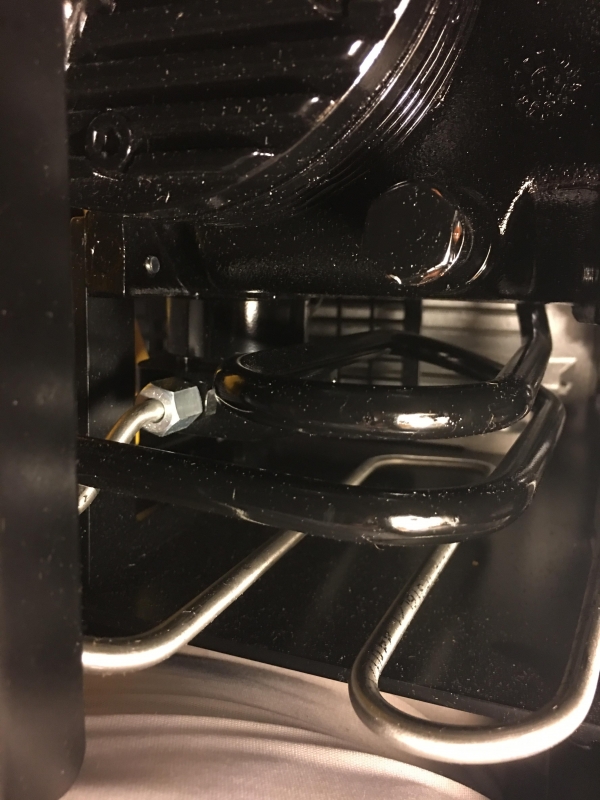

right in front of the fan with the keyring looking thing hanging on the bottom. Here is another pic of that piston where I think yours just has a flat plate:

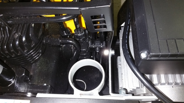

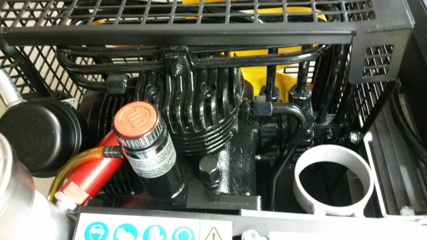

another pic:

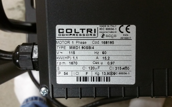

my v110 motor label:

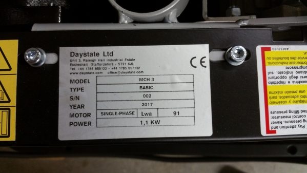

Belt housing label:

I notice from your msg that your motor label says 14.5 amp and mine is 15.2

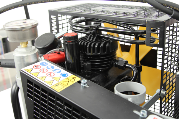

Here is the pic from AoA where they still list it as a 3-stage on the web site (unbelievable) and I doubt they updated those pics either. Pretty sure this pic from their website is 3-stage:
See that plate on the right-hand side? Mine has a piston there, the one with the release valve thing on the bottom. I call it a valve, but I don't know what it is. Steve from Aeac did a vlog where he talked about that valve on the 4-stage but he deleted it later. I would have thought all the 3-stage would be gone by now. They used to list a daystate v110 used for $1899 but they weren't used, they were the remaining new 3-stage. The $1999 v110 is supposed to be 4-stage.
