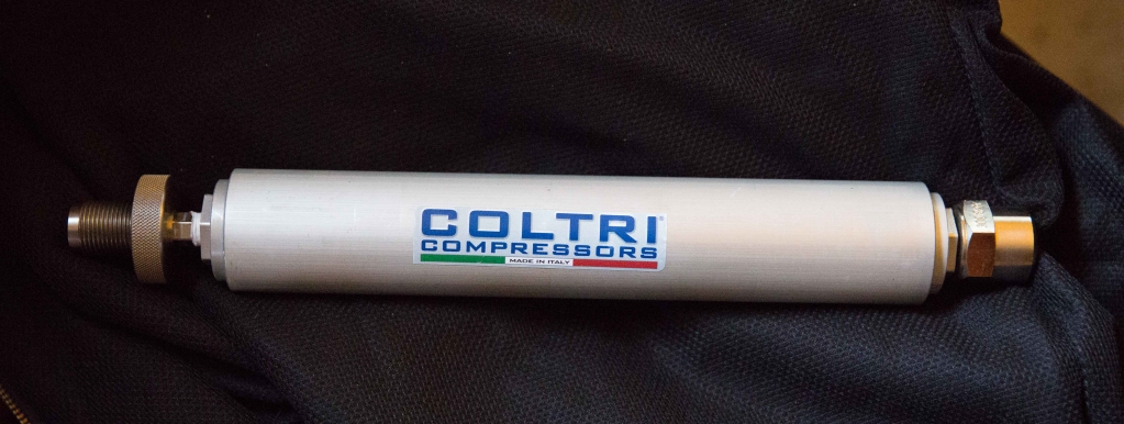

I'm in the South East and I didn't have any issues with the factory oil/water separator. I'm getting dry air into the tank. Unbox it, put the top on the oil/water separator cylinder, connect up the pressure shut-off lead, fill it with oil, and away you go.

I bought my 110V from AOA last May and couldn't be happier with it. This unit can be used to fill air breathing tanks with the additional filters. Thanks to us not needing them and Coltri working with Daystate we have lower price for a very good unit. It can be rebuilt and I know it will outlast me. I put one of Joe B's Alpha filter that I was using on my Shoebox on it to eliminate ALL moisture. I live in a very dry climate but I'm a nut about any moisture in my guns. Joe's filter is sweet but pricey. There is a copy out there of Joe's unit if you are so inclined. After watching Steve's video of the compressor and seeing the moisture he deals with in Florida I would add a little something just to be sure. Hard to measure what moisture is actually going into your gun. I vote for overkill and better safe than sorry.

I highly recommend the Tuxing cartridge gold filter as a high pressure filter. They can be found for $76-82 shipped from the U.S. when purchased from Aliexpress or Ebay. Mine has 6 hours of run time and the indicator beads in mine have not even begun to change color. You can choose to spend $300-400 for a higher priced filter but it won't keep your air any dryer than the Tuxing.

It is -- I'm in Alabama, my house humidity is usually 55-60% inside. I have a dehumidifier in the basement which is where I run the LC-110. I think if you look at the filters, and think about CFM, and then look at the method of moisture removal in the filter you might find you don't actually need it. I would think where you would need it is if you need Grade D breathable air. The cost savings I believe we're seeing with the LC-110/MCH-3 over the Coltri MCH-6 is the reduction of filtering required for breathable air.
I think additional filtering is overkill -- this is a quality compressor intended for the PCP market adapted from a breathable air dive compressor. I imagine if Daystate believed we needed additional filtration they'd have implemented it. That said, I'm not against overkill, I'm actually a fan of it so if your budget permits and you like the idea of Grade D breathable air going into your airgun have at it :)
