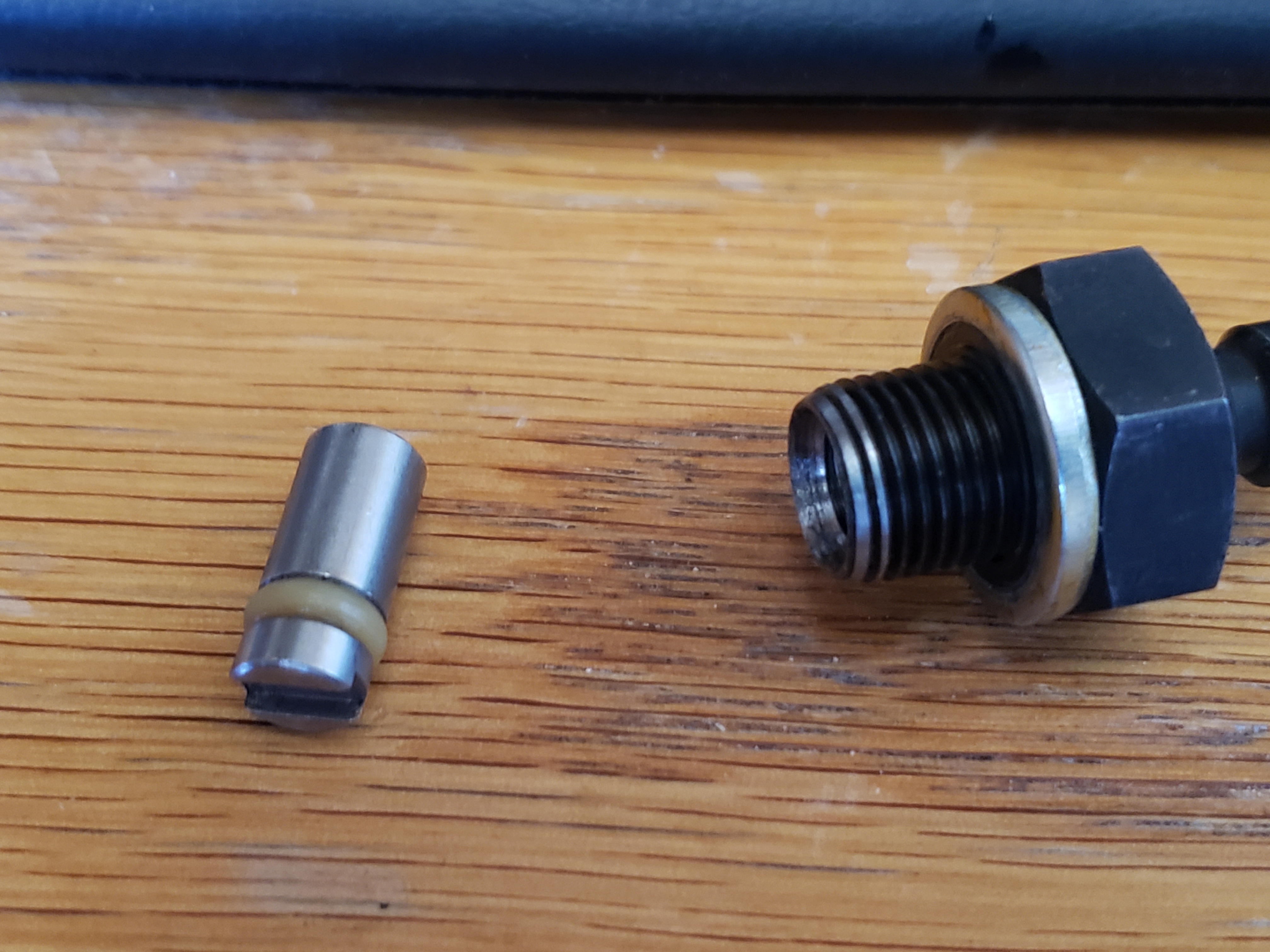

So I just bought this used Daystate Air Wolf and it came with the gauge at 100 bar. I hooked up my compressor and when the gauge hits 100 bar on the compressor there's a loud click and it will not charge any further. I contacted daystate and they said it's a problem with the shuttle valve which they assume has been assembled backwards. They told me to clean it all up and it will work. I took off the fill valve and the shuttle valve was very difficult to get out. once I got it out, I saw why. the inside of the fill port is very scraped (chattered?) up. I am assuming the shuttle valve is simply sticking on the rough scraping in there. Will a new fill port fix this issue? where do I even go about finding a new fill port?
