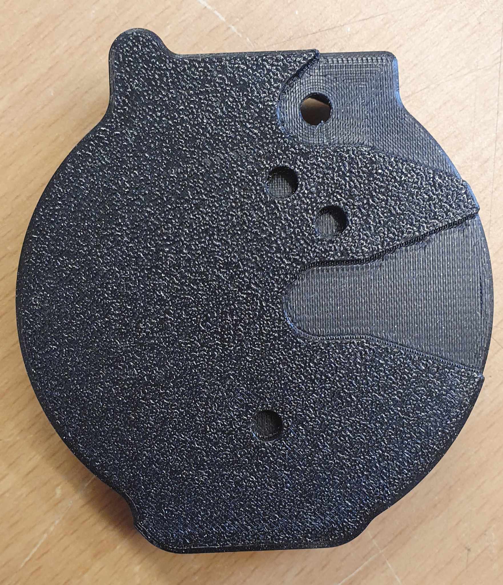

Do someone know what is the maximum length of projectile that fits into to magazine of the delta/alpha? I assume that this depth is same in al calibers.
I havent checked but a 20 gr. Zan fits easily in the .177 magz.
I can check what i can fit into my DIY magz for the DW/AW
i heart from AOA that the depth is 11.7mm.
is there a particular reason way you made your own magazine's?
Good Reason hehe - Do not ask my wife for a good reason :cool:
Accuracy, Accuracy, for the most. - and I also like to fill 10 magz and then shoot.

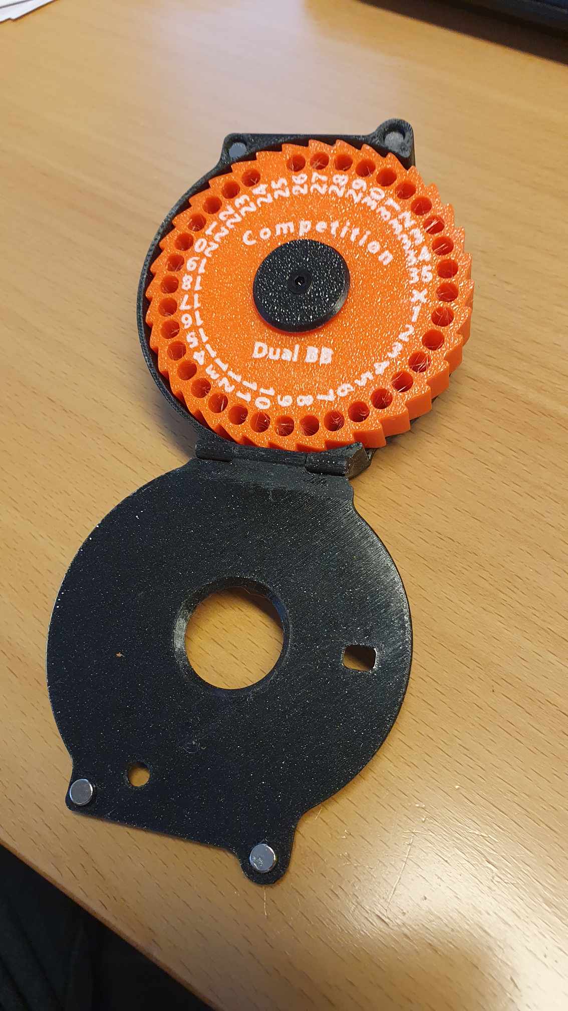

I designed magazines for many different rifles - mostly for the fun to be able to design something that works better, easier to use and have more features than the OEM magazines.
My last new design was a ManuLoader magazine for an Epoch Skout .177 with dual ball bearings.
ManuLoader is a name i invented for a full magazine working as a single loader.
When single loading you open the prope - flip the loading part out feed the perfect pellet - flip in and bolt forward then shoot.
With my ManuLoader you take your carefully sorted and checked pellets and fill into the Manuloader magazine.
Insert the ManuLoader in the rifle.
You now by hand twist the rotor into the next clear click and close the pellet probe and shoot.
Next shot open the pellet prope back - twist the rotor again one click. close the pellet probe and shoot.
Accuracy exactly like single feeding - advantages --- a lot.....
Did ManuLoaders for Red Wolf, Delta Wolf, Impact, Crown, Avenger and some i forgot.
Normal magazines for a lot more rifles.
When i personally shoot pellets, i only use ManuLoader never normal magazines.
Easy to use and just a bit more accuracy to gain.

This is a print of a magasin body in Petg filament.
When It comes to the support area I use one layer of PLA filament as automatic Support interface with 0.0mm distance. These filaments will not fuse with each others. So when I remove the support it just pops off and leave an even surface where the dimension are very accurate too.

Yes Ive heart good things about bambu lap. Your print looks very clean and the use of different colors in one product is very cool 🙂. I also like the Markforged fdm printers that are able to print composite materials with continuous fiber inlay for high mechanical strength. But you're going to pay 🤌. I probably go for a resin printer for tighter tolerances and details. Resin has less mechanical strength but for prototyping its fine.
