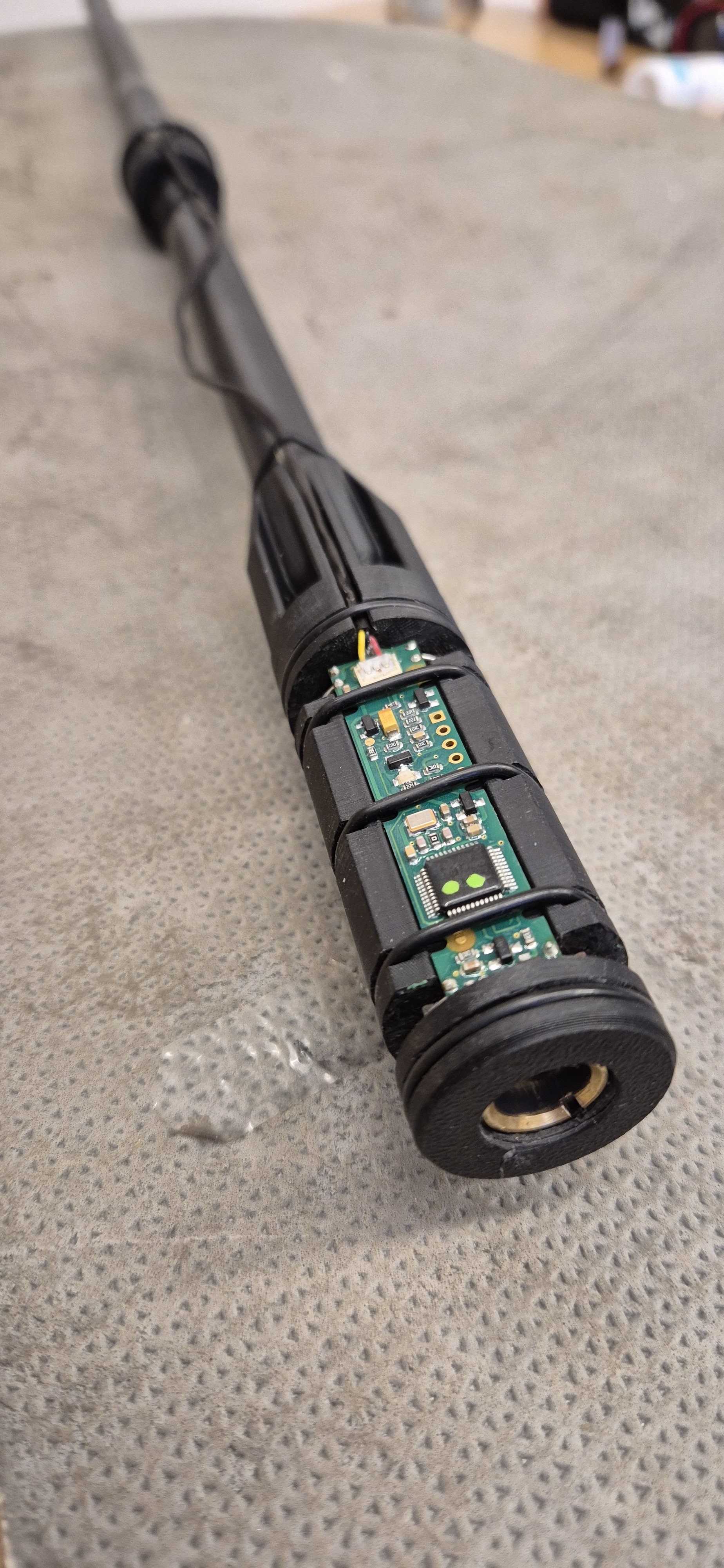

In the hunt for accuracy I also designed a DIY Chronograph holder with integrated Airstripper. I tested it and accuracy immediately improved.
Here the DIY Chronograph holder is installed with the circuit board and the O-rings. A no problem switch from the OEM to the new. Now i also can shoot faster and still have superb accuracy. (Daam I should have done this last summer)

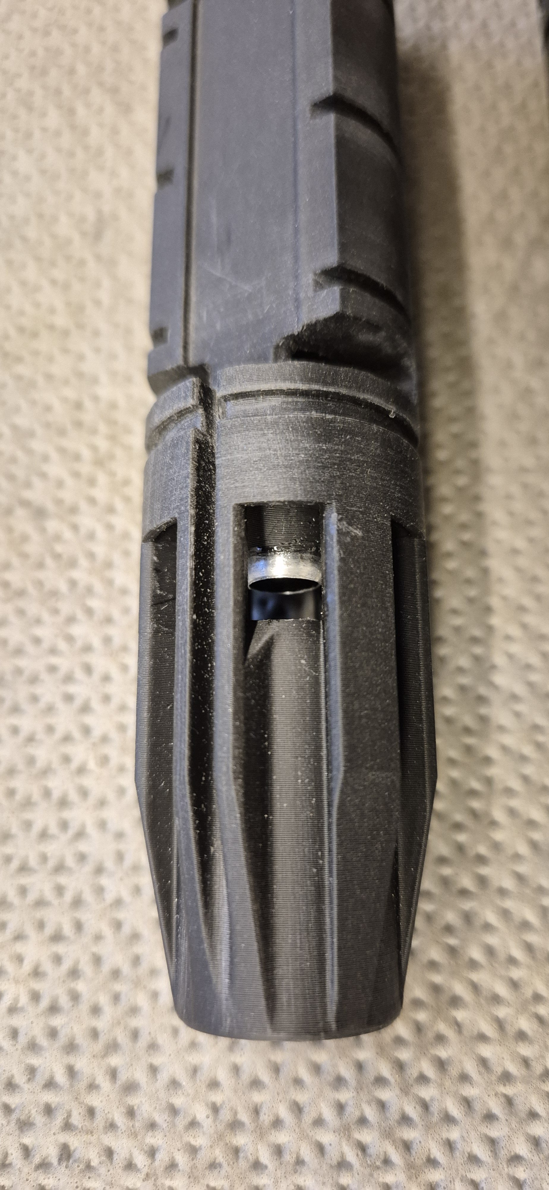

Here the airstripper is fitted with a small aluminium pipe ø8 mm outside and ø6.5 mm inside diameter. Distance from the barrels crown to the airstripper is approx. 6.3 mm. ( I aimed for 6.15 mm = the length of a JSB Knockout 13,43 Slug.
Here is the the holder directly from the printer - printed in ABS - (The green areas is PLA used as support interface)

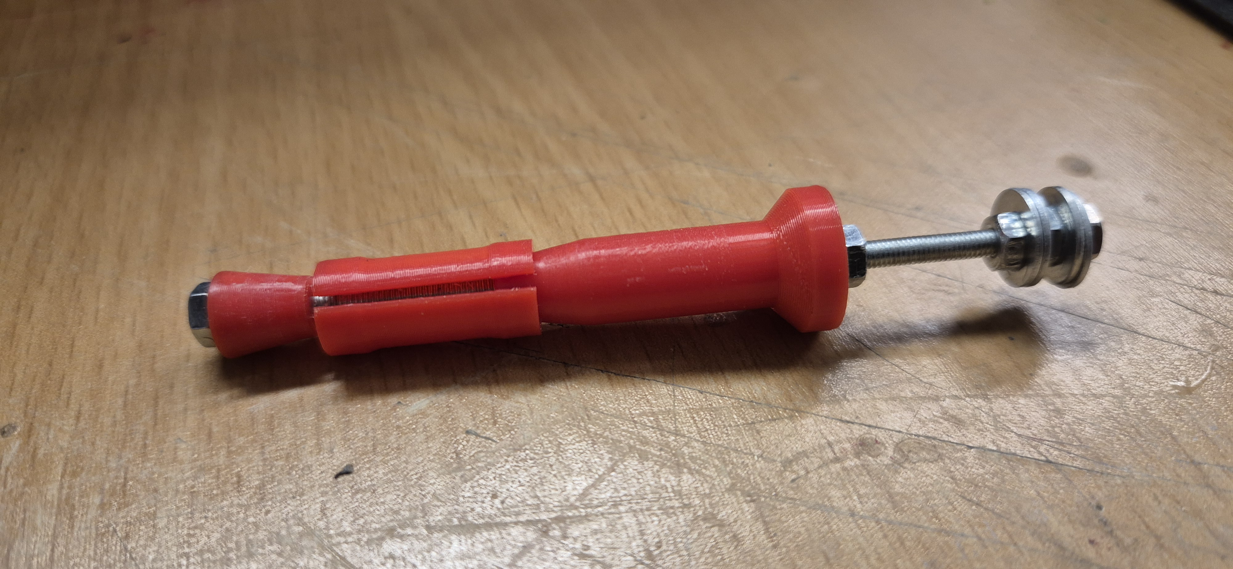

The clear plastic tube in my chronograph holder were tight and i could not get it out - so I designed a little pull out tool - Worked flawlessly.
