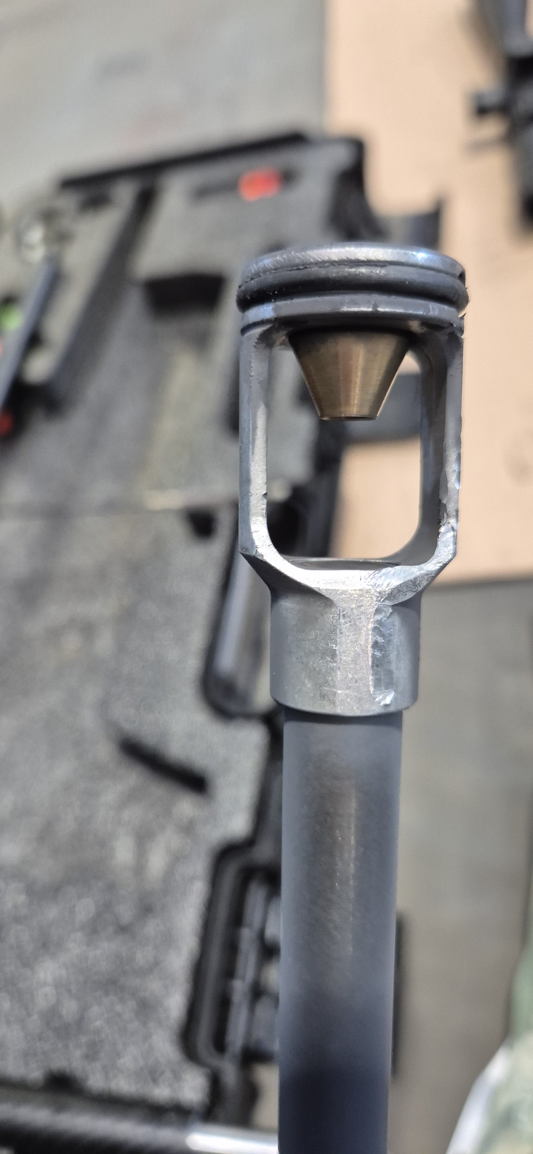

Had a lot of trouble with my AW and the second replacement was much the same, so ended up doing a lot of work to it.
Reactions: cavedweller
Accuracy, the first was replaced, and the second was a little better, but rather than send it back for yet another I polished the barrel well and recrowned it and ended up doing a fair few mods to the gun, but now it shoots very well.

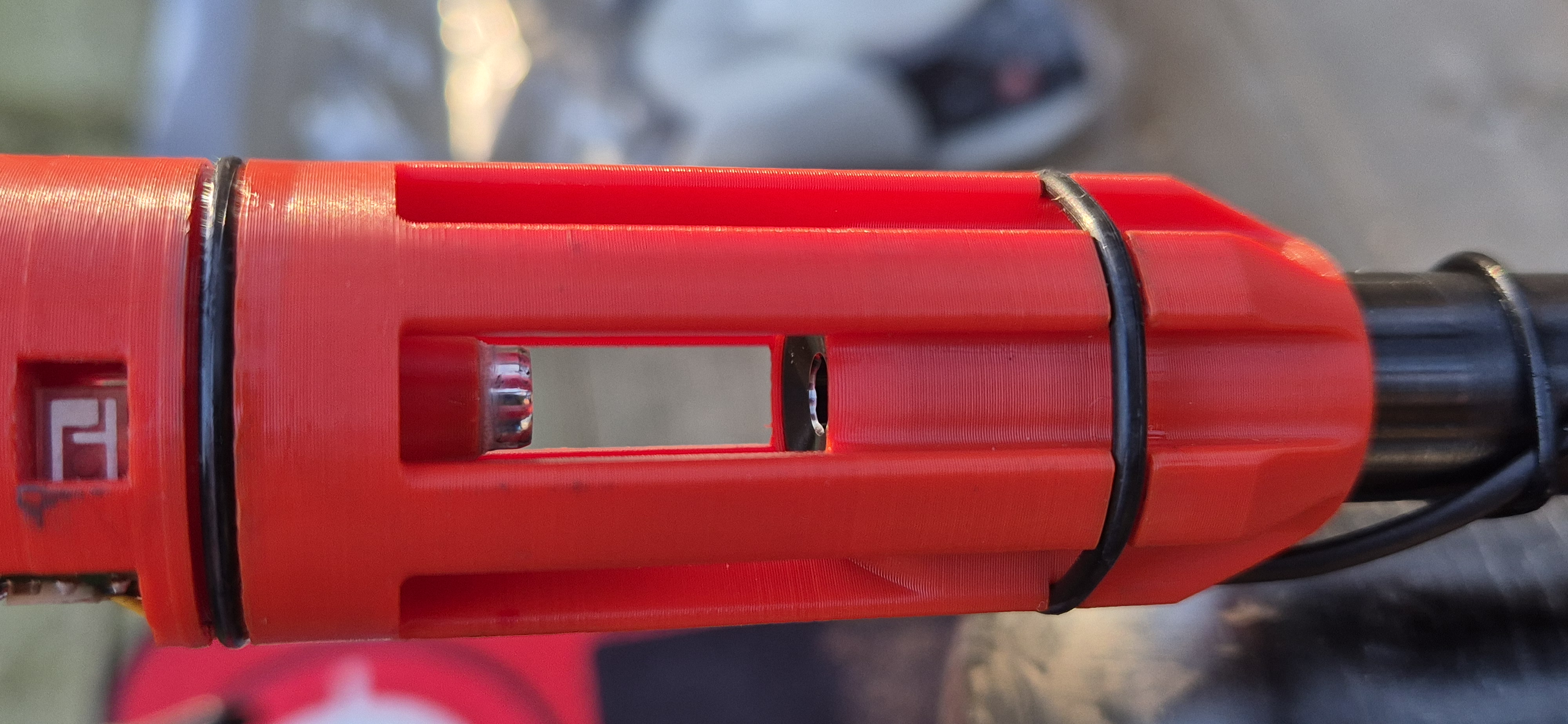

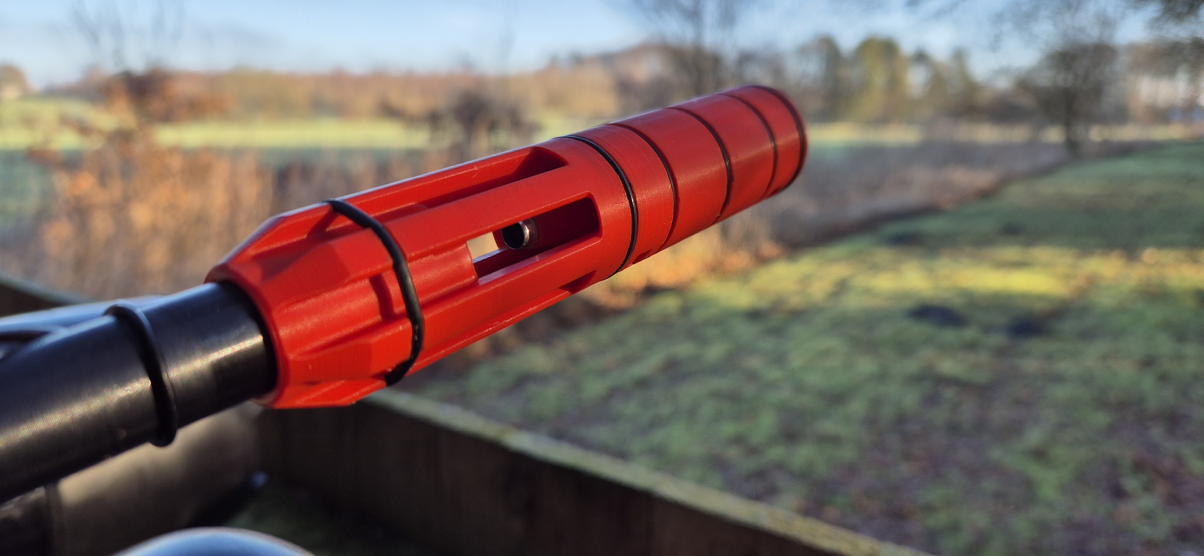

This is what I call Daystate Wolf Redtube ;-)
Inspired with the measurements from the BRK Ghost air stripper.
View attachment 530840View attachment 530842
View attachment 530844View attachment 530845
Delta Wolf .177 HP 600 mm ART barrel - 158 bar - Zan 20 gr. 890 fps - 190 meter - (Very little wind)
Opened transferport - ø1.5 mm Pinprobe - All DIY
Can I ask what the reason for the incorporated internal stripper? Did you have accuracy problems with the std setup?
I found that if I added a moderator to the STD shroud I got POI shift and not through clipping which lead me to develop my silenced over shroud which solved my problem, I also ended up making a barrel clamp after talking to an Indian gentleman who made one and this was before Daystate decided to make their own however while they are probably worth it with FAC and a long barrel it's not worth it for the sub 12 version.

You have to bare in mind I am in the UK and limited to 12ftlb so anything that can be done to improve efficiency and accuracy is paramount, so during, and after I sorted the barrel I then made a pin probe as with the STD set up the STD probe did not fully engage the complete pellet in the rifling, I then made the barrel clamp, I also turned down the reg pressure to 80bar and luckily a friend told me how to unlock the full software IE FAC which I then reprogrammed it to the two pellets I use so it couldn't go over the sub 12 rule, I also made a plenum plug as the STD plenum is rather large and causes the reg to be slow in recovery, aside from that I just did some cosmetic mods.

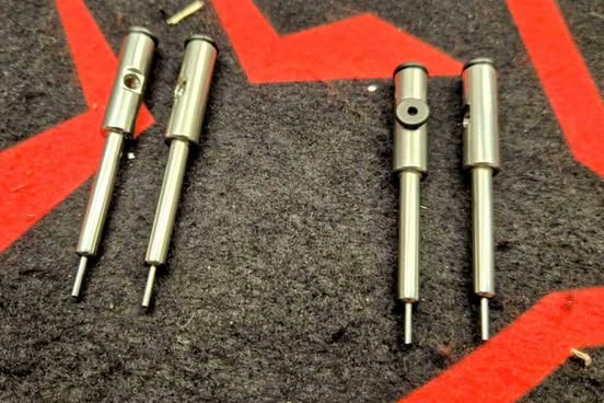

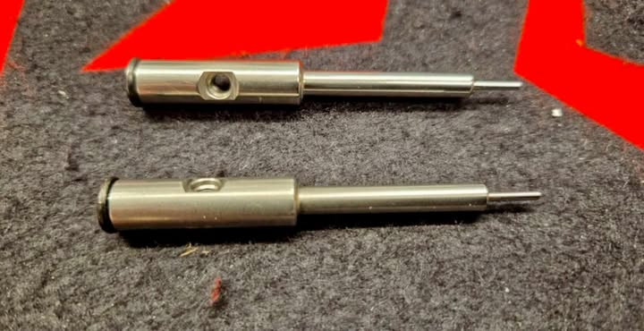

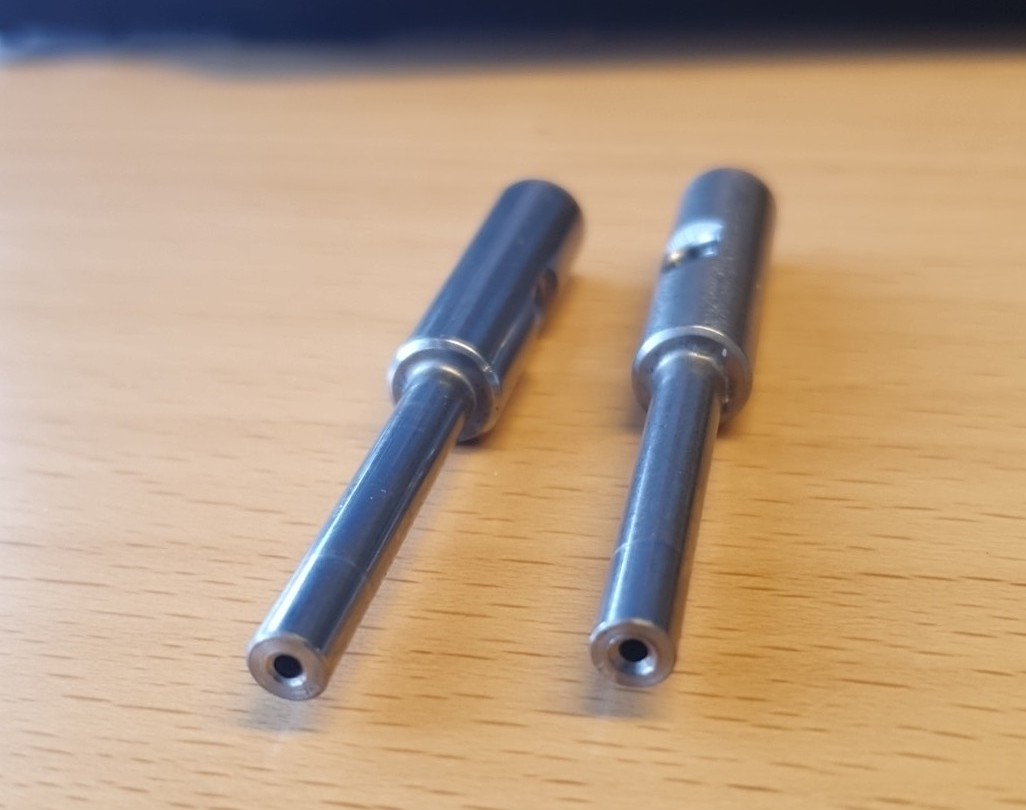

Custom converted original pipe shaped Pellet probes to ø1.5 mm Ultra Pin-propes.
The ø1.5 pin is to utilizing full area air-flow, corresponding to the opened Transfer ports area that was gained from opening the port from ø3.2 mm hole to oblong holes 3.5 x 5.5 mm. That matters and its like the hard roof on fpe is raised considerable.

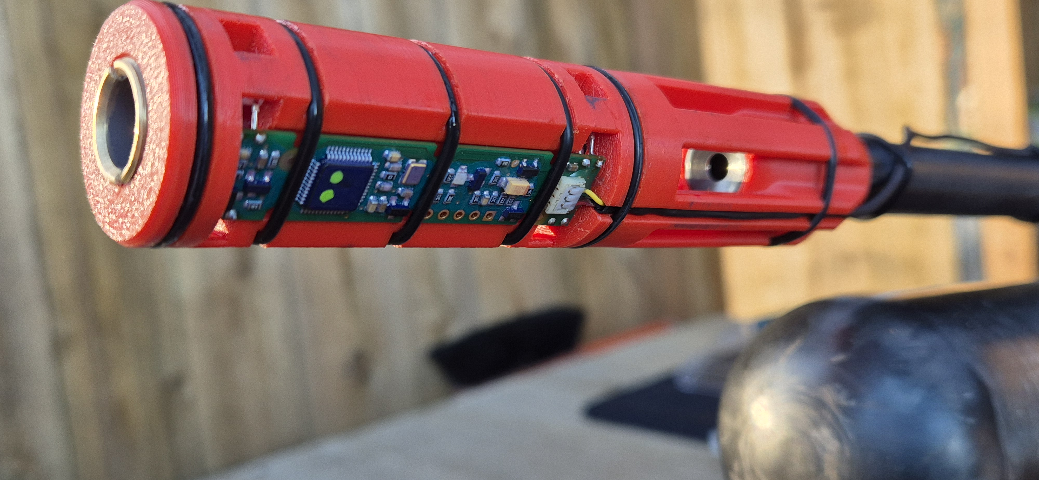

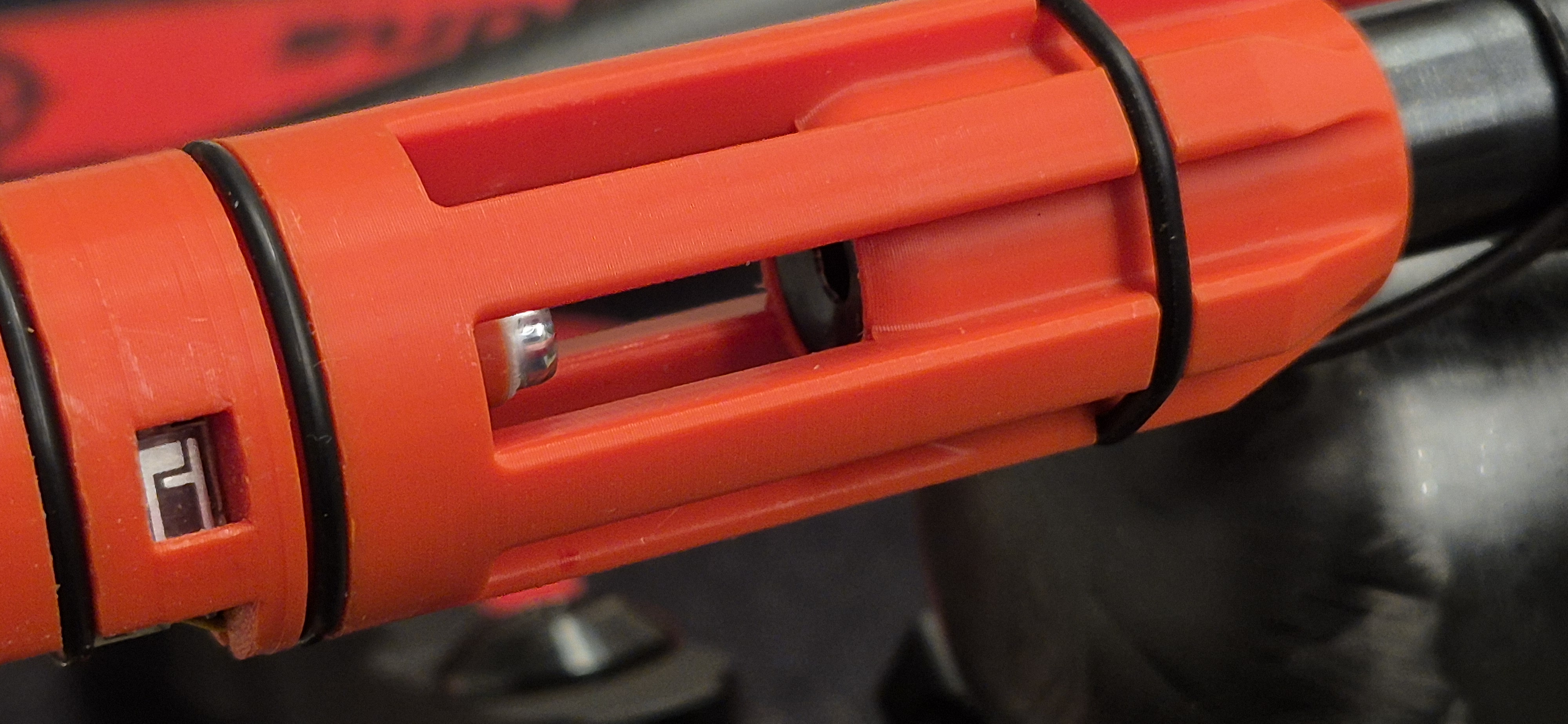

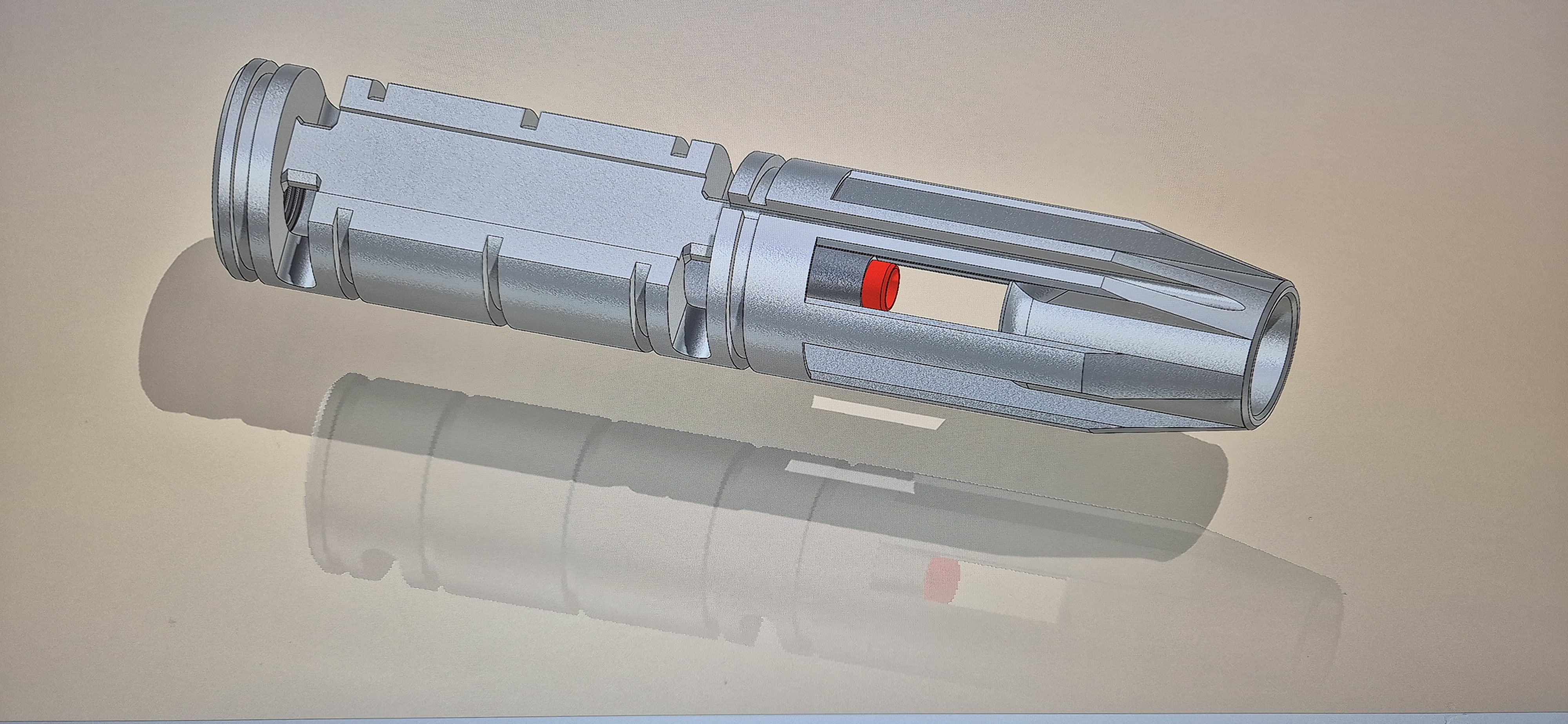

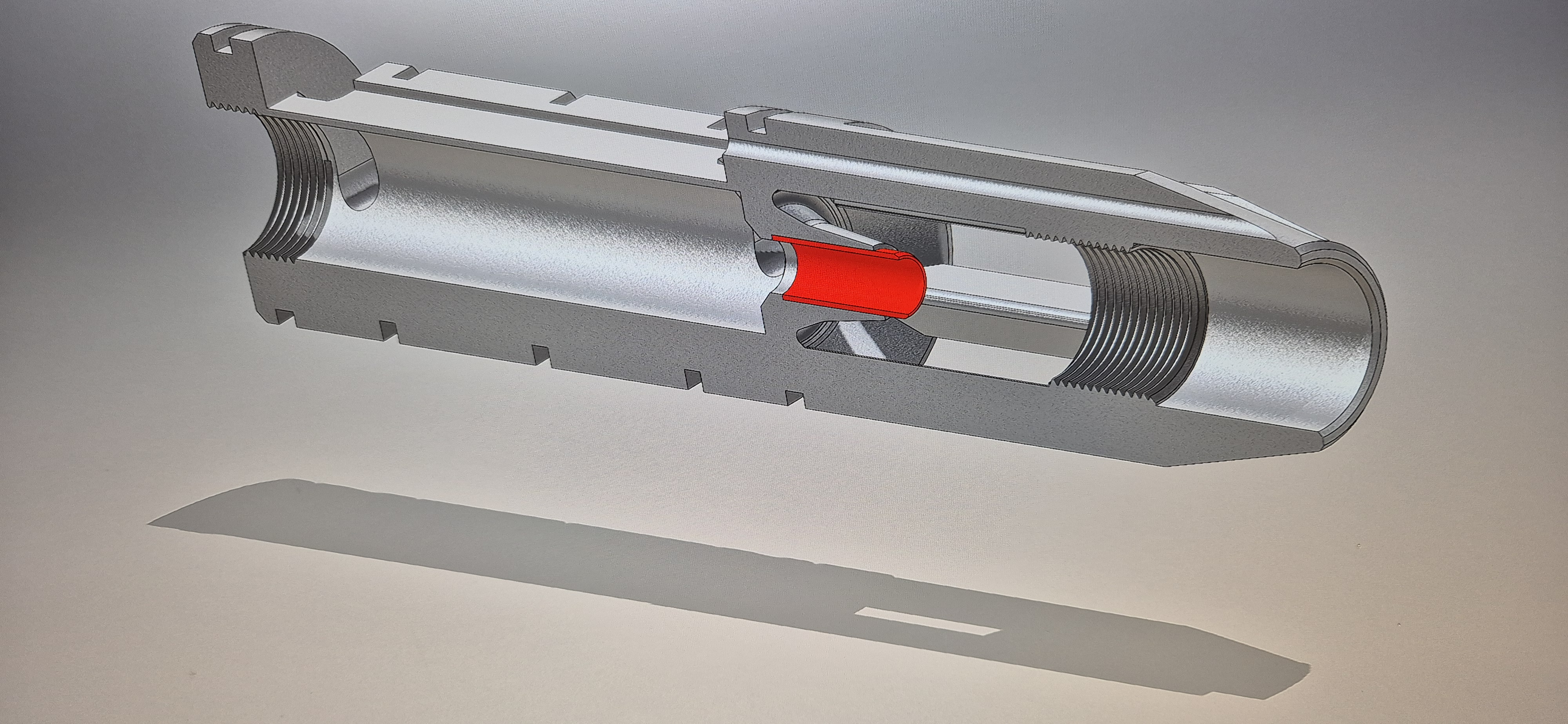

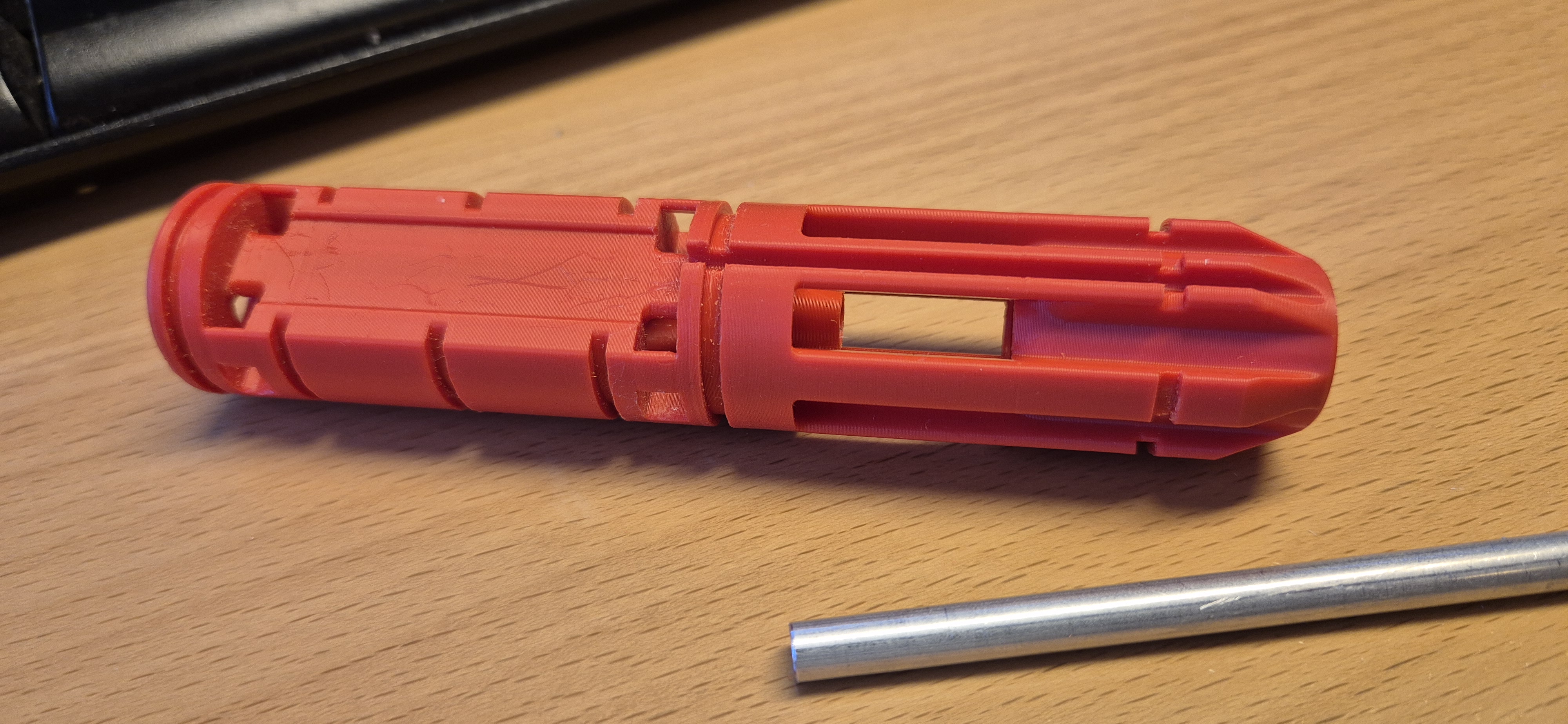

My Delta Wolf is a second hand rifle and one of the earlier models. I experienced not the same accuracy as my shooting budy Soren Drost. He har one of the earliest DW and a newer AW. The earlier models were supplied with a Chronograph holder in Nylon or POM without any airstripper integrated. He later got an updated holder manufactured Aluminium now with Airstripper included. Before christmas I designed my Gen. 1 holder with airstripper - where the gap between the barrels Crown and the air stripper edge was approx. 6.5 mm apart. This was to get approx. the length of a Knockout 13.43 slug 6.2mm. The hole inside was a aluminium pipe ø8 mm outside with an internal hole of 6.5 mm.
But I had been looking at photos comparing Daystates plastic types without airstrippers to the new including airstripper. The new one looked much longer.

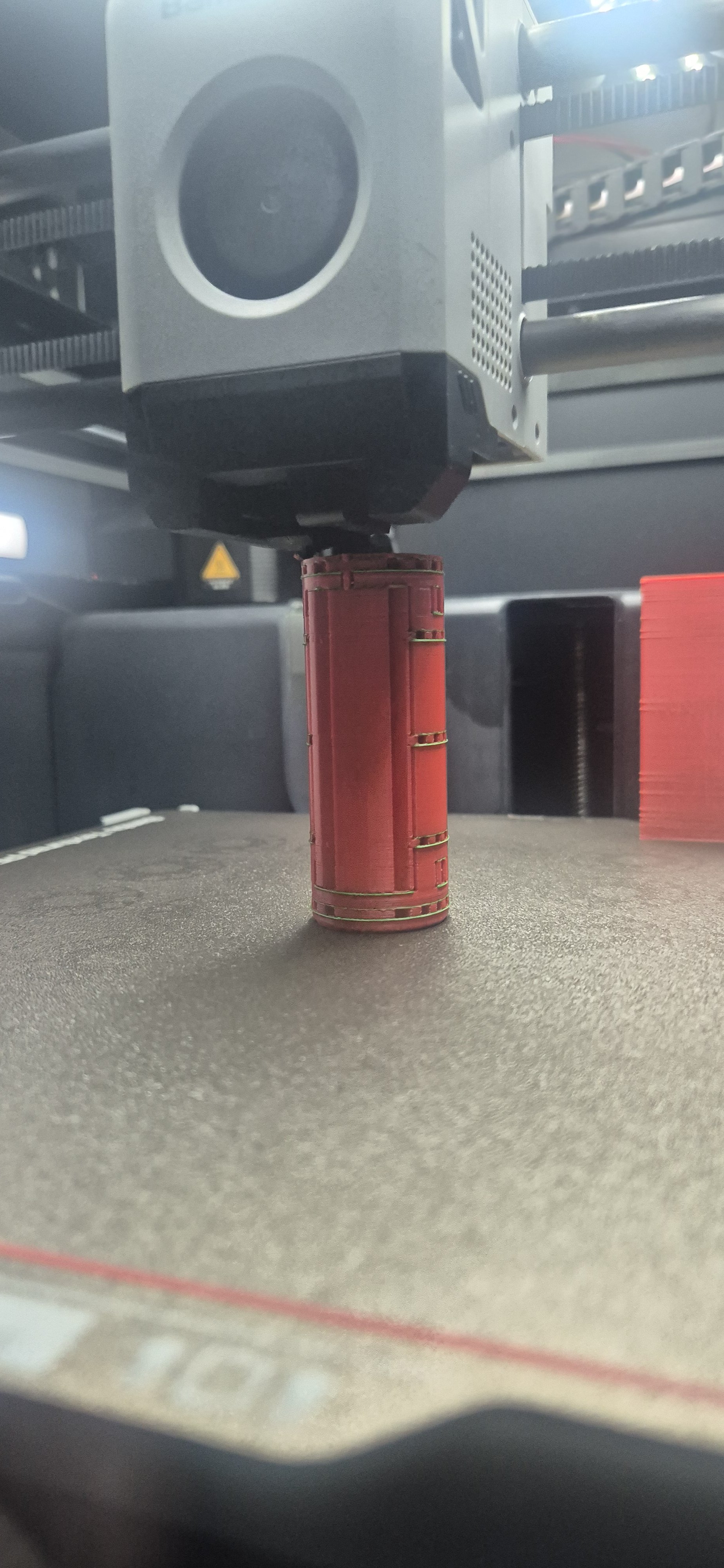

So when i designed gen 1 i made it 5 mm longer - believing i had plenty of space in the shroud.......... Daaaaam. So now when I test fitted the shroud gen. 1 was exactly 5 mm too long. I Did modification to try the gen1. anyway and found it helped a lot with accuracy.
I redesigned and found a found a way to shorten the holder / stripper -5 mm without losing any functions . Tested and worked well too.
Then Soren and I was in the workshop where I machined a lot of DW - AW - Ghost barrel transfer ports, and when we took the Ghost apart I saw the air stripper. Immediately in my mind i found the design to look technical optimal. 18 mm between the barrels crown and to the edge of the airstripper. And the hole inside was only ø5 mm for a 4.5 mm pellet / slug.
So back to the 3d design and integrate the new knowledge - This time knew that it would be 18 mm too long. During assembly I discovered that the cable was 10 mm too short when the chronograph circuit board would be pushed forward. So had to design a 18 mm adaptor / spacer with gold pins to extend the plug connection from barrel to rifle. Urgent since i should meet with Soren next morning to test shoot. I did not want to cut the very tiny cable and extend it before i test shooted the rifle and have proof of concept. But it worked very well - so I ordered a new carbon fiber pipe and will extend the Shroud so it can hold the extended (+18 mm Chronograph holder with airstripper Gen3) and also space for a 700 mm barrel that will be installed later.
So accuracy problems - Hmm before it was still more accurate than my FX Crown gen1.
But now it is way more accurate.
Indoors with pellets i shoot 24 pellets through one single hole at 50 yards - and i can now do that all day long.
Before my DIY chronograph holders with airstripper a numbers of fliers would ruin that.
As soon as the first flier appears I shoot a couple of felt cleaners with a pellet behind - and accuracy is immediately back.
The original pellet probes - I cut the pipe away and drill a 1.5 mm hole in a lathe.
Under Here finished probes - I use the shaft of a 1.5 mm HSS drill bit - with Cyanochrolate instant glue. And polishing afterwards

View attachment 531351View attachment 531352
How does your Chrono/stripper design compare / differ to the newest Daystate alu design?
Very interesting @engfred, like me, you obviously feel a need to improve on the STD design of most guns, There is a lot crammed into the shroud on the AW/DW ! so i may have a look into trying to improve that myself as mine is certainly not as accurate, but I think the barrel is still the main culprit.
The pin probe for the .177 AW is definitely needed, I know DS used one on the .22 not sure about the larger calibres, can't figure out quite why the did that.
My AW is a June 23 gun not sure which chrono carrier it has but it's definitely polymer of some sort.
