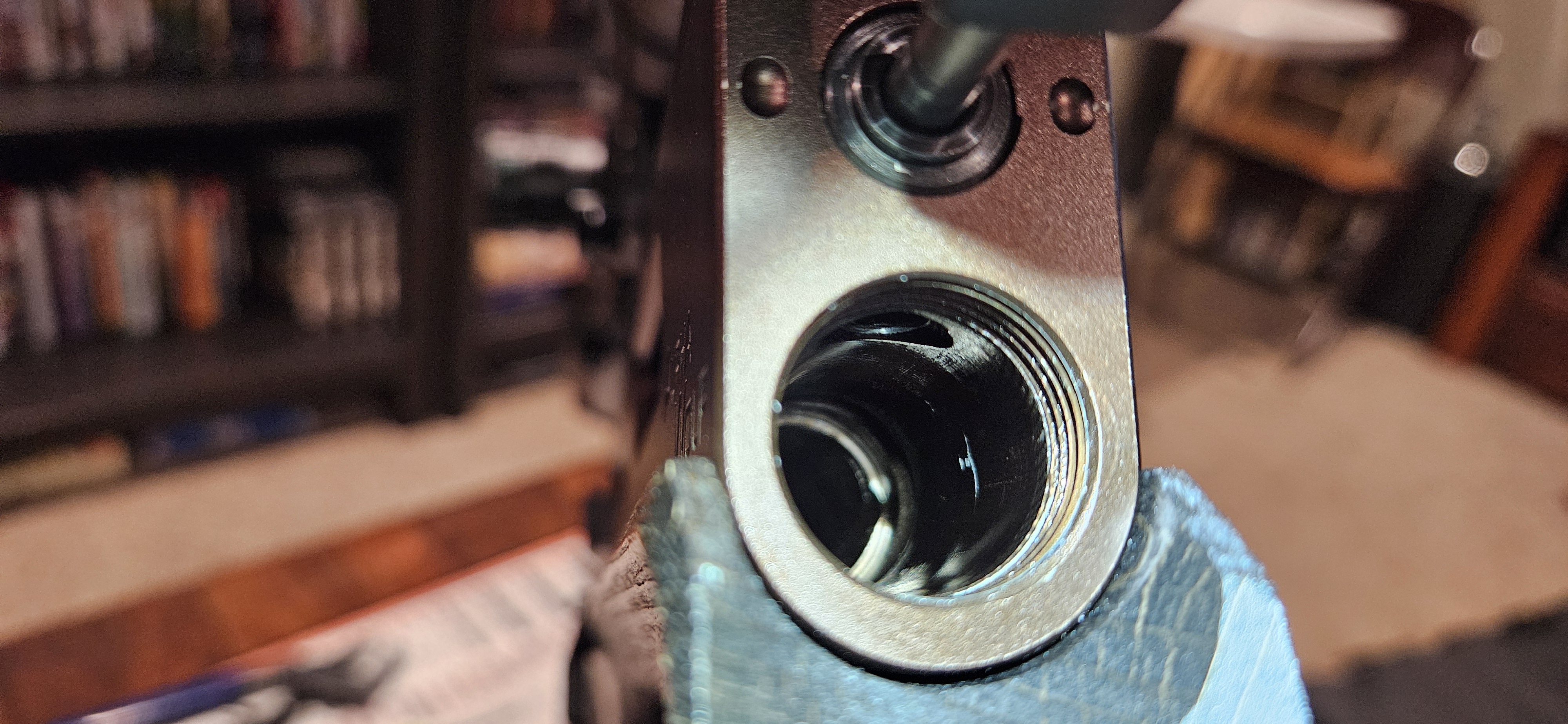

Well it looks like I found the problem. I pulled the valve out and found a sizeable gouge in the sleeve it fits into. It appears air pressure is leaking past the gouge to the opposite side of the valve.
Reactions: cavedweller

I had a ghost that had a similar issue and best I could figure is that machining was sloppy and bad QA left debris in body where regulator moved back and forth resulting in oring damaged and creep and eventually degassing. Although they could replace the orings and valve… the marred surfaces were still there so I had the gun replaced
Wow well at least it seems to be a consistent problem 🙄.... did you get your Ghost from AoA? This is my first warranty manufacturing defect issue with a Daystate. My Red Wolf and Huntsman have been flawless.
Yes from AOA and it isn't an AOA issue... it was a QA issue at the factory. I suspect the cleaning part of the machining process failed when they tapped for gauge bodies or threading stuff.... thus the trash left inside to roam around with other moving parts.... friction equal wear...wear equal failure.
AOA was right on their game and fixed me up. That said if the internal block is fudged request a NEW unit as machining post production isn't a good idea in my opinion. My second Ghost is indeed flawless and my two Redwolfs are flawless and my Wolverine Sapphire is flawless.
