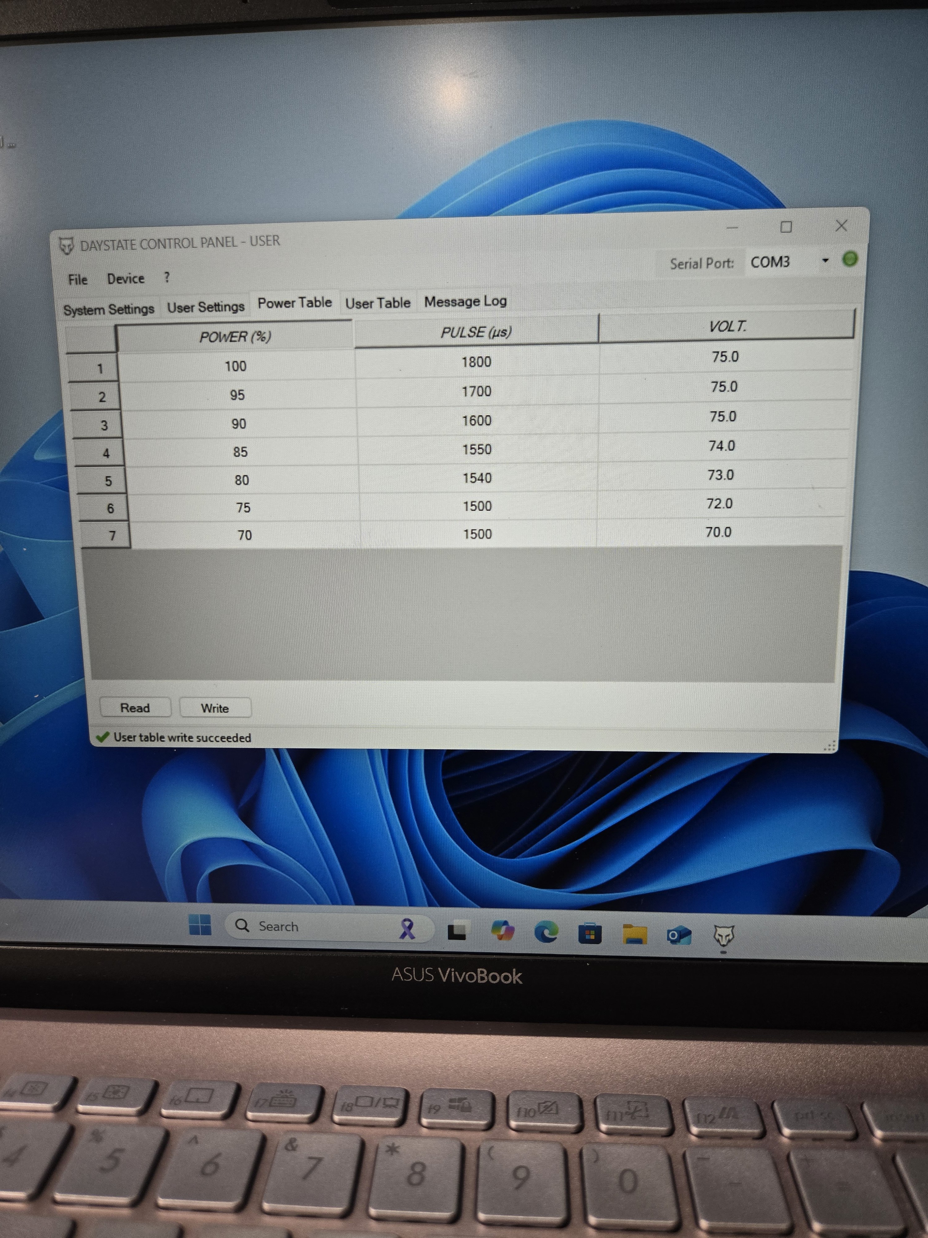

Here are the Factory settings for FAC .25 caliber. They will get you close to what you want and you can tweek from there.
Thank you!!$!
No problem. I was told to set reg. pressure 5 or so above the minimum, then tweek dwell and voltage from there. Dwell is how long the valve stays open and voltage is how hard the valve is hit/ air used. Now your work begins..
Its a really dark and deep rabbit hole, and everyone has an opinion on the setting in Advanced mode.
Here are the % in power mode set from the factory on the Smart Wolf. There isn't much change shooting now as the % would lead you to believe. BUT I have found out, you can add % and change the % dwell and voltage similar to advanced mode. So you can put in a 73% or a 82%. The % isn't REALLY a % of anything, it's more like a setting for a particular fps. But you can adjust the bar as you shoot, without going into advanced mode to increase velocity. I think I'm going to like it.
