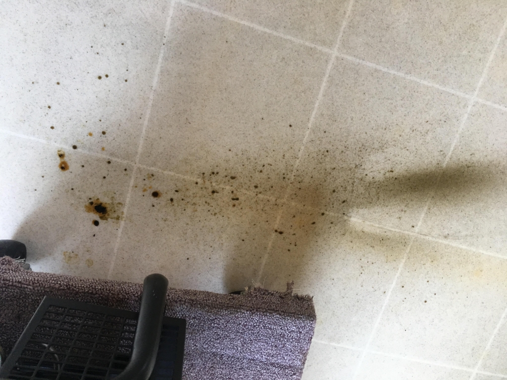

Here is another sign of trouble if it was a car engine I’d say it’s rebuild time Not that many hours to justify this . That’s the oil and water from the condensation drain
