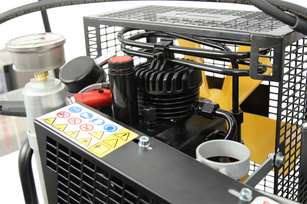

The version of the LC110 currently pictured in the AOA web page do not have it:

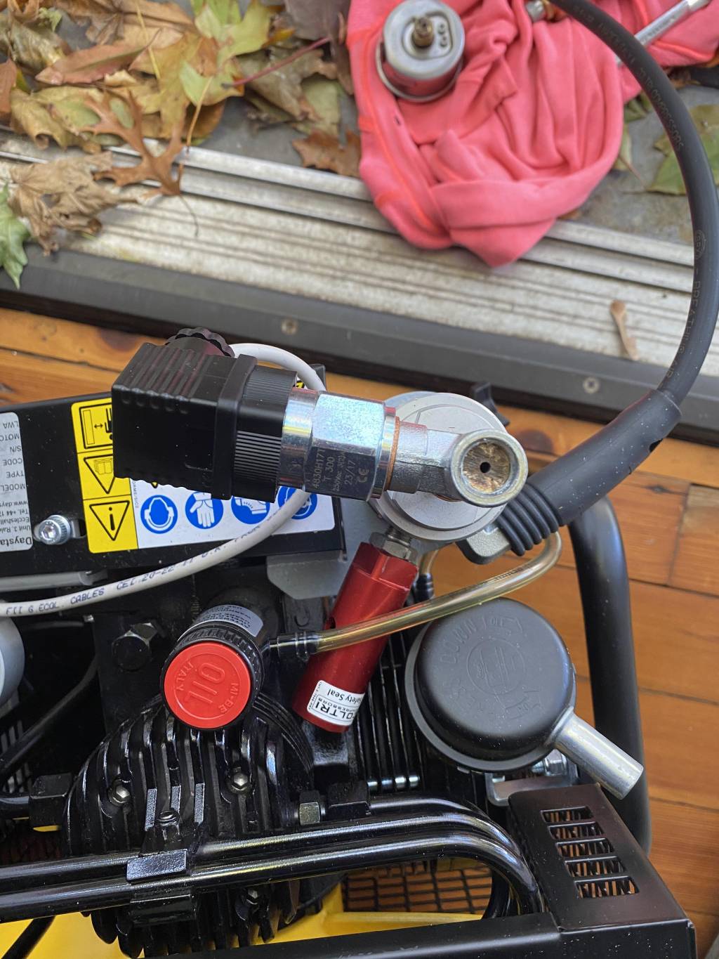

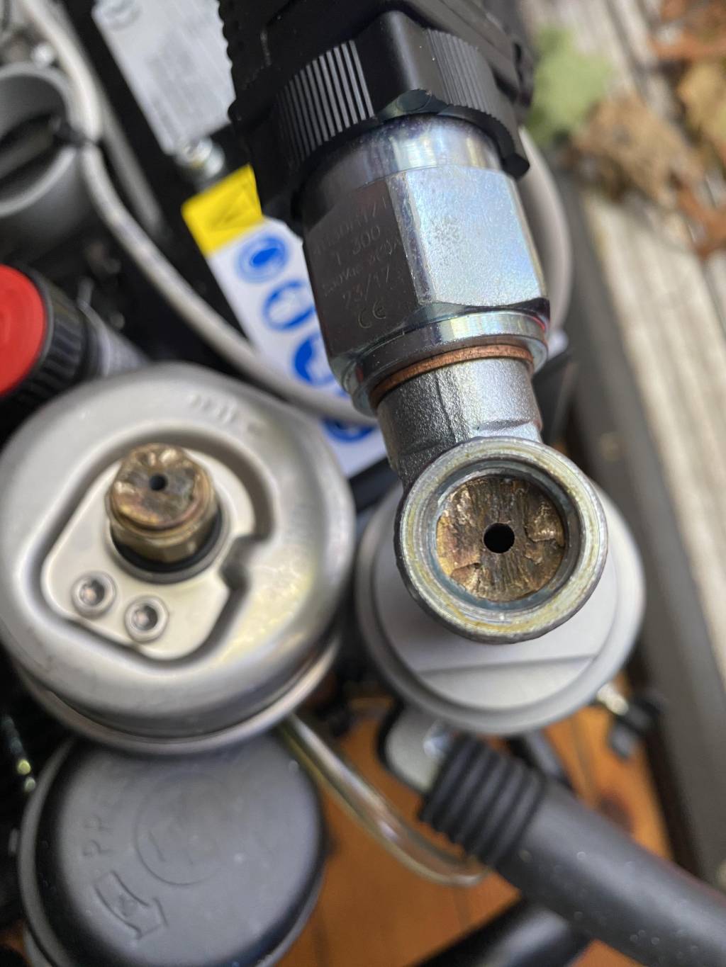

I bought it from AOA 2years ago.. I don’t how I got installed.. I’m disappointed because it has less then 5 hours of use and already failed
5 hours in 2years is very light use. The problem is not with the compressor portion so it is not a big issue. The problem might have arisen from a careless install of the auto stop and gauge (over-tightened?). That's why I was curious as to when the auto stop was installed, or if it was done at the Coltri factory.

Weird, mine looks like a garden hose style fitting, the one Eddy shows is different. I also noticed the tee itself look like it got attacked by grabber claws :( Sorry Eddy :(
Have you contacted the supplier of your compressor to see if they can explain the fitting or send a replacement? Sorry to hear your compressor auto-stop failed.

I did contact AOA but my warranty expired in September.. my problem was the gauge it was leaking I try to take if off to put tape or locktite and I broke
