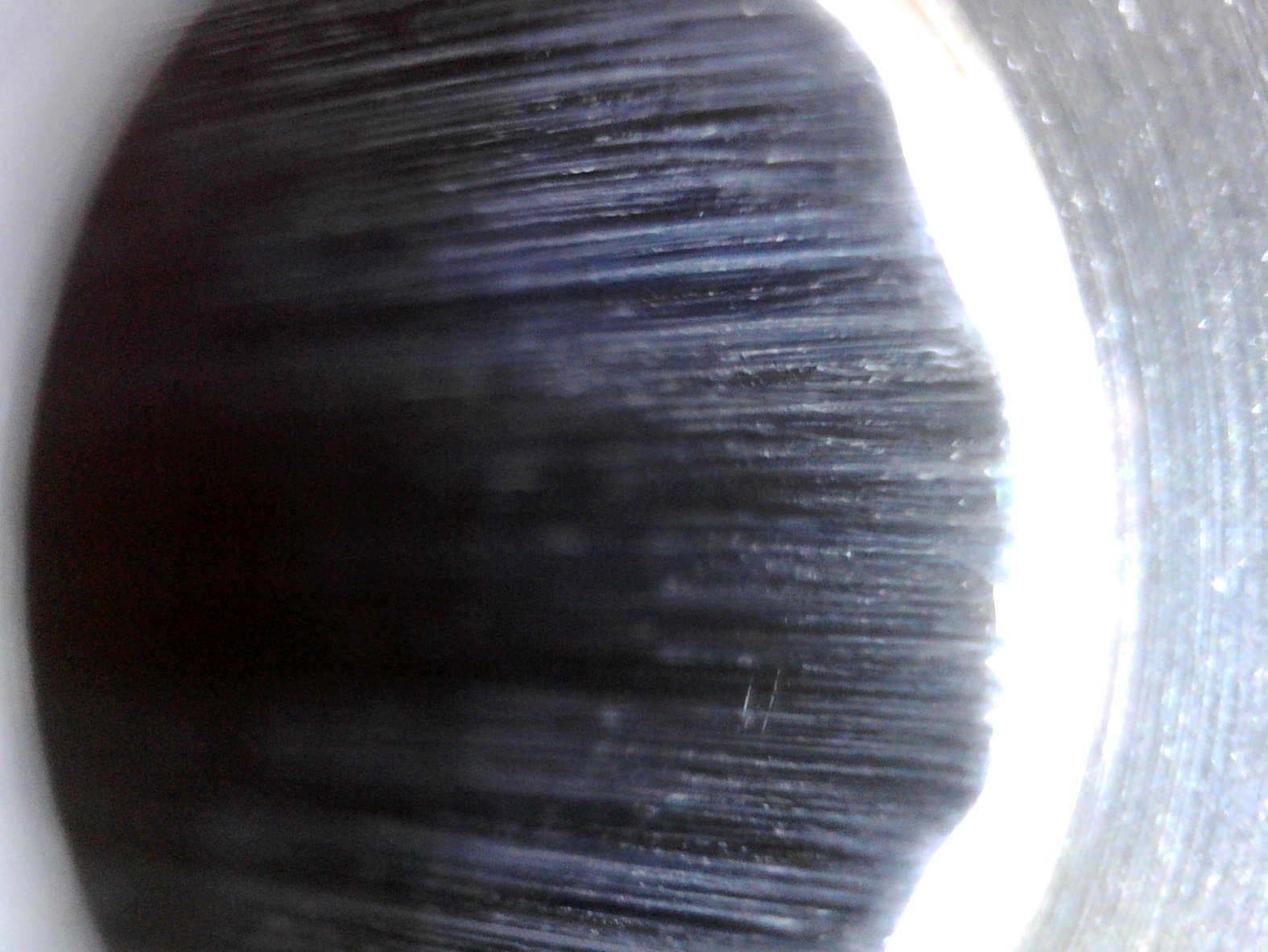

Brand new Daystate Delta Wolf HP. Just had it a week and have been searching for a pellet that it likes. No such thing. Tried 5 pellets and one slug and speeds from 750 to 1050. Best group is about 1" at 30 yards. Clearly there is a big problem . This is just a small sample of the testing. In a word its useless. Got a USB microscope on the barrel and you see the pic below. Match Grade LW, really? Please don't suggest this or that pellet or a different speed. This thing has a problem. Shop ignored my email and Daystate on summer break. Extremely frustrating. I expect the shop will want to send it away for 2 months and come back the same.

Mmm, that barrel should have NOT...made it past the Quality Inspection the first time around, period.
That barrel was broached with a way...worn out tool. Unfortunately, there are barrels that are just as bad as your out there in the world, and no one complained !
And Daystate should NOT have resold a gun with bad parts in it...period.
Change the barrel, then, resell it, fine. But not with that garbage mistakenly called a barrel.
Then they give you...a bad time, yeah, that's uncalled for.
Other than sending them a picture of what the interior of a barrel "should" look like, I don't know what to say, except, good luck.

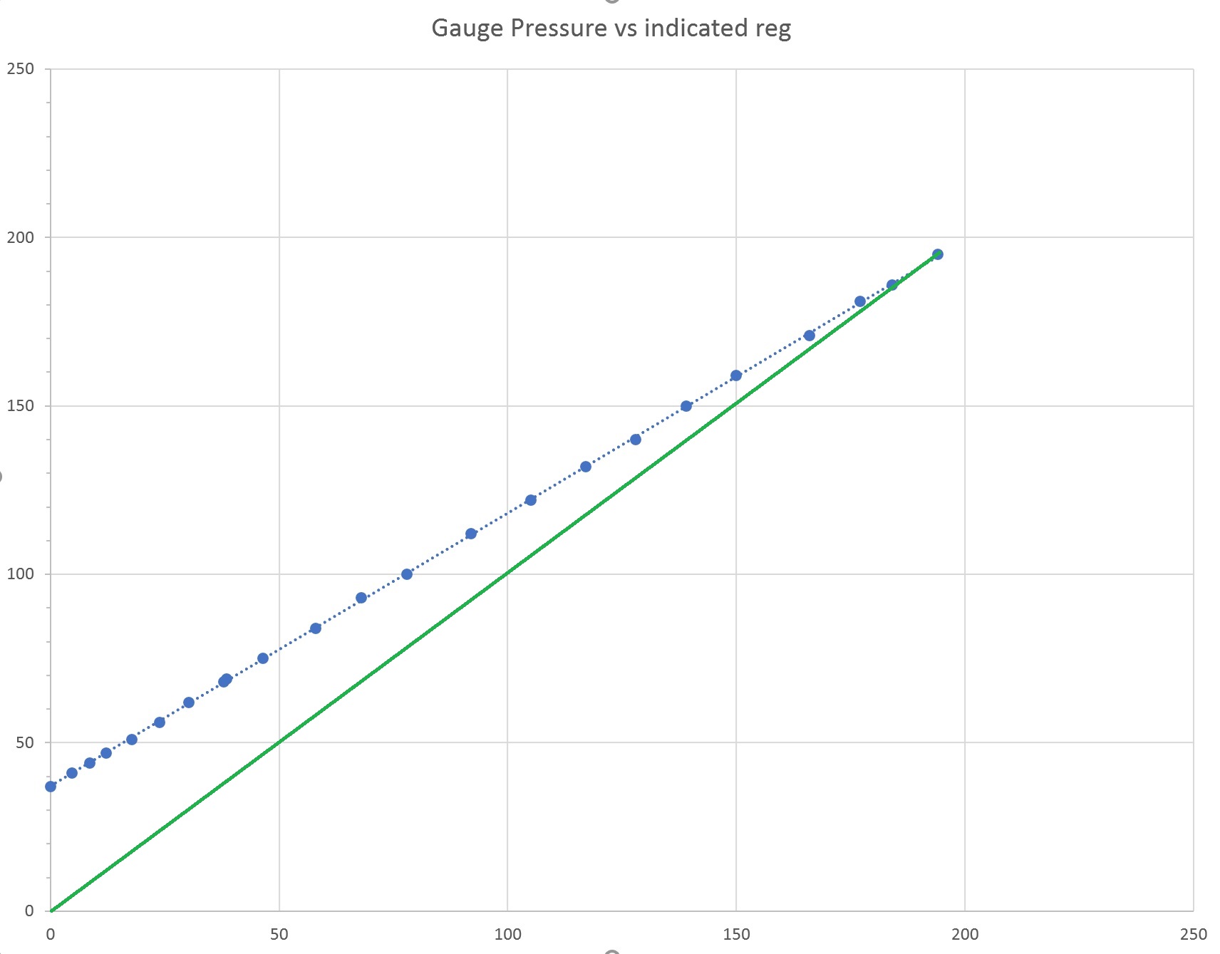

Regulator mis-reading 38 bar when gun empty (software fixable, see graph)

About the graph. Blue is measured data with reg wide open and green is what it should read. Clearly to reads correctly at 180bar. The Daystate firmware warns not to change the zero setting but I suspect thats what this needs. Anyway I dont have the USB connector and its going back anyway.
