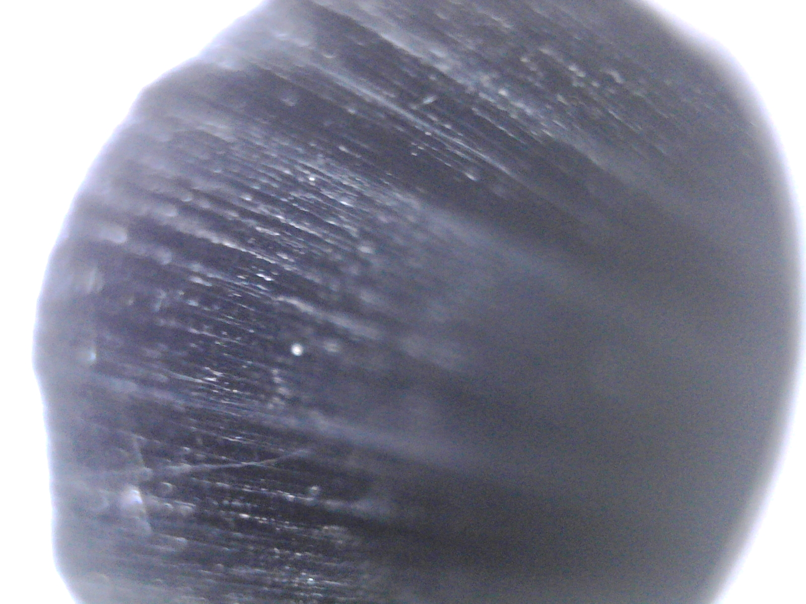

Devils advocate here: OP states shooting a JSB 18 well over 1000 FPS .... Barrel an obvious POLY profile.
What i'm seeing ( Due to consistency of image texture of bore ) Is a case of EXTREME LEAD FOULING.
I would be more incline to play along after seeing a through Bore clean & scrub with a bronze brush etc ... Picture :cautious:
Interesting!!! I have never seen a barrel THAT bad with lead fouling, not saying it’s impossible. Even when dirty and not shooting well my poly barrel still looked mirror smooth minus tiny imperfections/lead specs. Certainly would be very interesting to see if a good cleaning would restore it to a mirror finish, certainly won’t cost much to try.

I’m with Motörhead, give that barrel a thorough cleaning not just a couple dry patches, pull the barrel and remove probe o -ring and use a product called Gunzilla it will remove the mold release from the pellets that coat the inside of the barrel “which is not lead” then this product will start removing the lead. use your borescope to check your progress.
With a cheap borescope the thin streaks of lead look will like fissures or discoloration in the barrel. your patches will also have shiny streaks of pure lead on them not the black mold release that many mistake for lead.

Following Motorheads suggestion that it may be extreme lead fouling, I got a bronze brush in it and complete clean after. See pic after cleaning. Still looks quite scratchy but perhaps not quite so bad. Sorry its best pic I could get.

Following a very thorough de-leading and clean. The first 5 shot group, quite acceptable for 30 yds, then 2nd then 3rd..........
O dear.
Leading up again after 30 shots. Exactly the way it behaved straight out the box. So not to be accused of shooting them too fast, they are all about 760 but speed creeping down, also indicating fouling.
Ive given it every chance as I really wanted to keep it. Perhaps new barrel would fix it but that ship has sailed.

If that is after a through BRUSHING ... Yikes !!! I can see why it lead fouled so quickly & badly.
If that is the actual bare metal surface of barrel ? yea its a Bad one for sure !!
Tho I thought I had READ you already got a refund after returning it, So how were you able to clean barrel & provide a picture ?

The shop have agreed to accept it back but are shut until tomorrow. In the mean time I thought it worth giving it a brush as you suggested. Im also wondering if that is bare metal.

Whats odd .. is tho faint, looks to not be a Poly but seem to be seeing faint outlines of Lands of a std 12 groove ?
If thats the case ? perhaps the streaking is just brush scratches across the lead fouling ? And a lot of lead is still present on bores surface.
You know what, thats also possible, but how far do I go trying to fix this? It was not bad first 20 shots from new but then started spreading. I have no experience of a gun fouling up so quickly so didn't suspect this problem. If its new (and not almost new, and shop returned) then anyway it should not be doing it. Ive spent enough precious hours trying to fix this new gun when i should be out on the bunnies.
