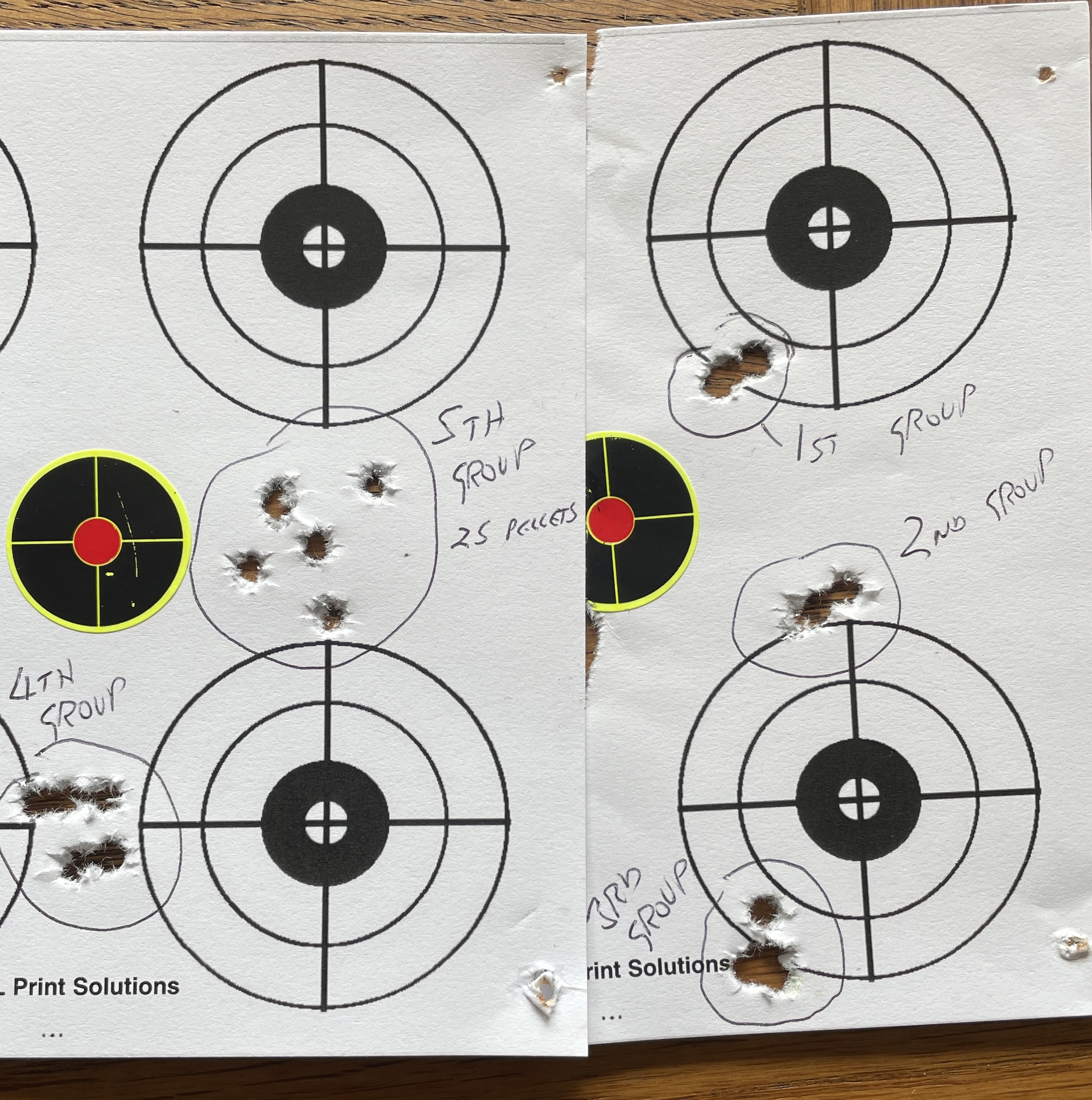

Daystate Delta Wolf terrible groups.
Seriously get a bronze brush and wrap it with a thin layer of 0000 steel wool, use a solvent of choice WD40, Ballistol etc. brush several times, then use some dry patches. Repeat as necessary.
If the barrel is really that terribly machined then your not going to damage it further by aggressive cleaning. The first cleaning improved grouping?

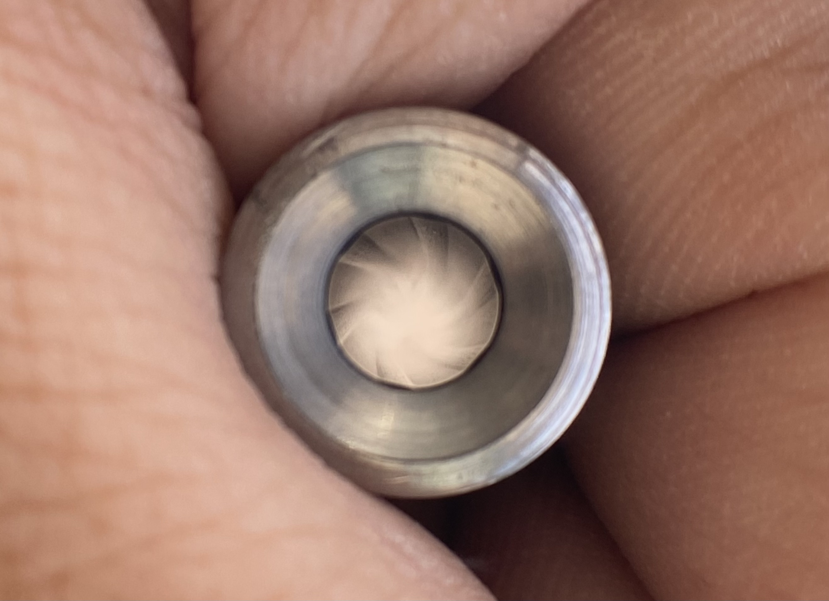

Following a very thorough de-leading and clean. The first 5 shot group, quite acceptable for 30 yds, then 2nd then 3rd..........
O dear.
Leading up again after 30 shots. Exactly the way it behaved straight out the box. So not to be accused of shooting them too fast, they are all about 760 but speed creeping down, also indicating fouling.
Ive given it every chance as I really wanted to keep it. Perhaps new barrel would fix it but that ship has sailed.
That barrel looks like it’s not even remotely finished! Highly likely a bad mistake from barrel manufacture and who ever assembled the gun never checked it. I wouldn’t waste a single minute of frustration on it, send it back!!!
This is how a barrel should look like and it is not even a poly barrel which should be even smoother and mirror like!
