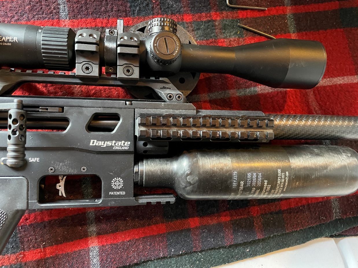

I believe it. I've been playing with my new Delta Wolf for a few days. The barrel is secured in the receiver by one set screw on the right side near the breech. I would think it would be best to have another set screw on the same side but near the front end of the receiver. Instead, there is an o-ring as the main support at the front. I understand the design decision as it makes it very easy to swap barrels by loosening just the one set screw. But that is a compromise when it comes to accuracy. Though it can be very accurate for a group, I have been getting significant POI shifts. Even a light bump or pressure on the shroud and the barrel can rock slightly on the o-ring end, and it does not return to the same center position, at least not right away. Probably from friction at the chronograph interface and hysteresis in the o-ring conspiring to prevent the barrel from self centering in the receiver.
Something that will better lock the barrel to the receiver should help. I was tempted to drill and tap another set screw hole near the front right side of the receiver block. But decided against any permanent mods for now. I saw the barrel band and believe that it could improve things but prefer a closer attachment to the scope rail. So instead of clamping to the bottle, I'm working on a similar stabilizer that clamps the shroud to the left/right side picatinny rails.

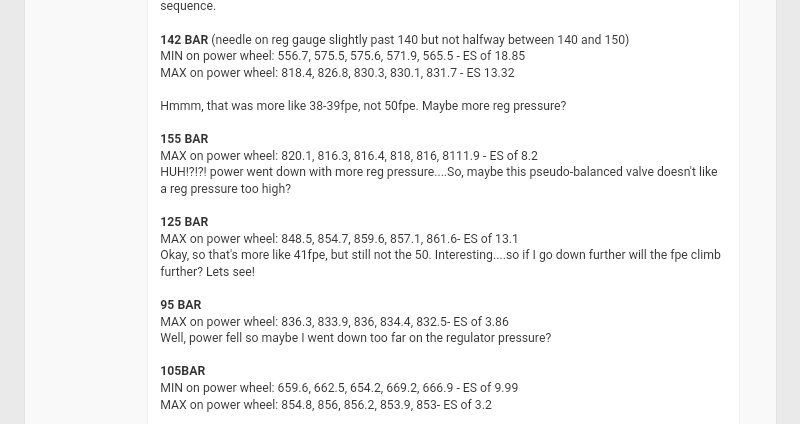

It is amazing that with so many time since regulators are in air rifles people do not understand yet how an air rifle works and still want to play with the regulators.
In a rifle with hammer system there are two forces in fight, the preassure in the cilinder, bottle or plenum, and the force of the hammer to open the valve and release the air to move the pellet.
The higher the preassure in plenum, the less oppening of the valve, onless you increases the tensión of the spring of the hammer.
To be able to know what is the maximum power of your rifle you can remove the regulator, dial in all preassure of the hammer and fill the rifle to 80 bar and shoot and measure fps, then to 90 and measure again, then to 100 and measure again. Eventually you will notice a decreases of fps, that mean that the top fps your rifle can give was the previous bar filling. At that preassure you should set your regulator and then decreases hammer tensión in order that you feel the rifle to shoot smoth. For example my Vulcan 3. 30 Cal gets to the top fps at 140 bar. If I increases preassure. Fps start decreasing.
The only rifles on which more preassure in regulator means more fps are the HUBEN, LCS and Rattler because those rifles do not have a hammer.
In other words once you get to know the adequate preassure your regulator has to be, you should not meses with it.

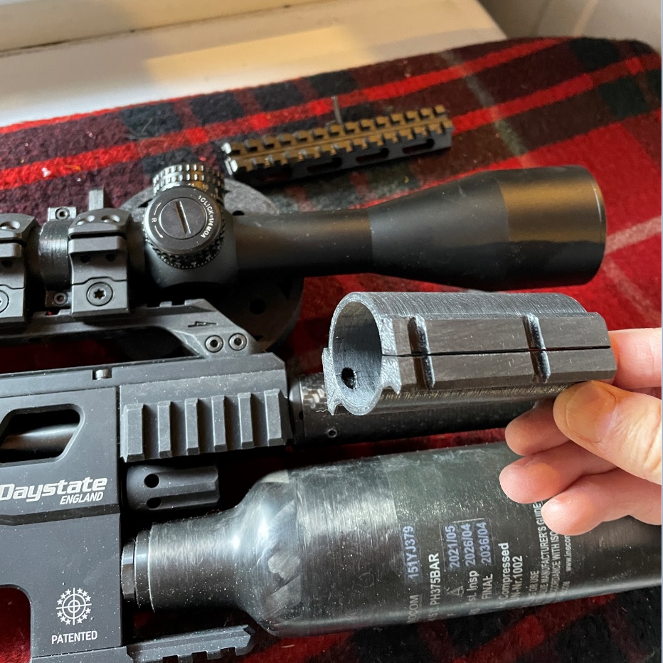

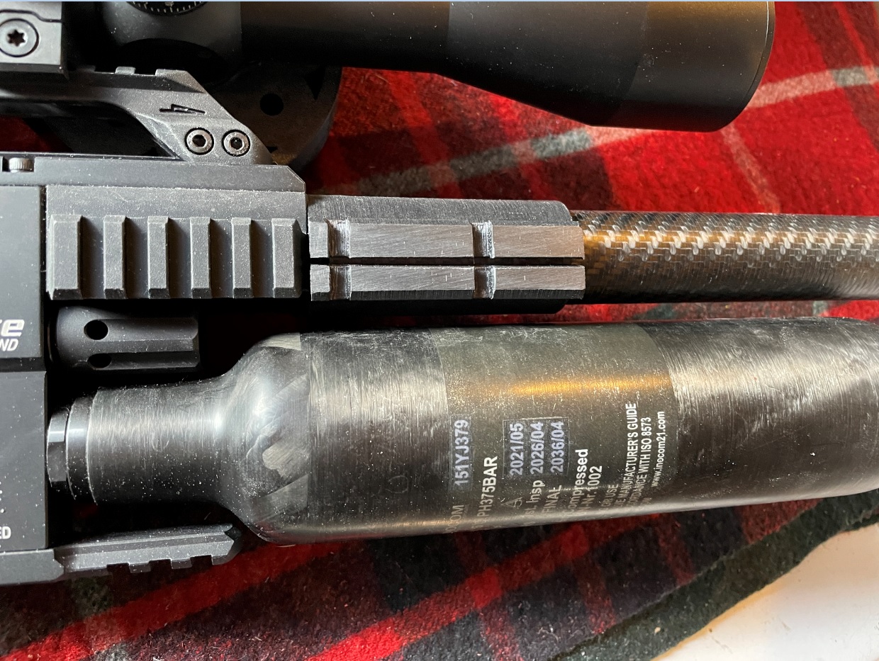

I did some preliminary tests with the barrel clamp. It helps a lot with POI shifts.

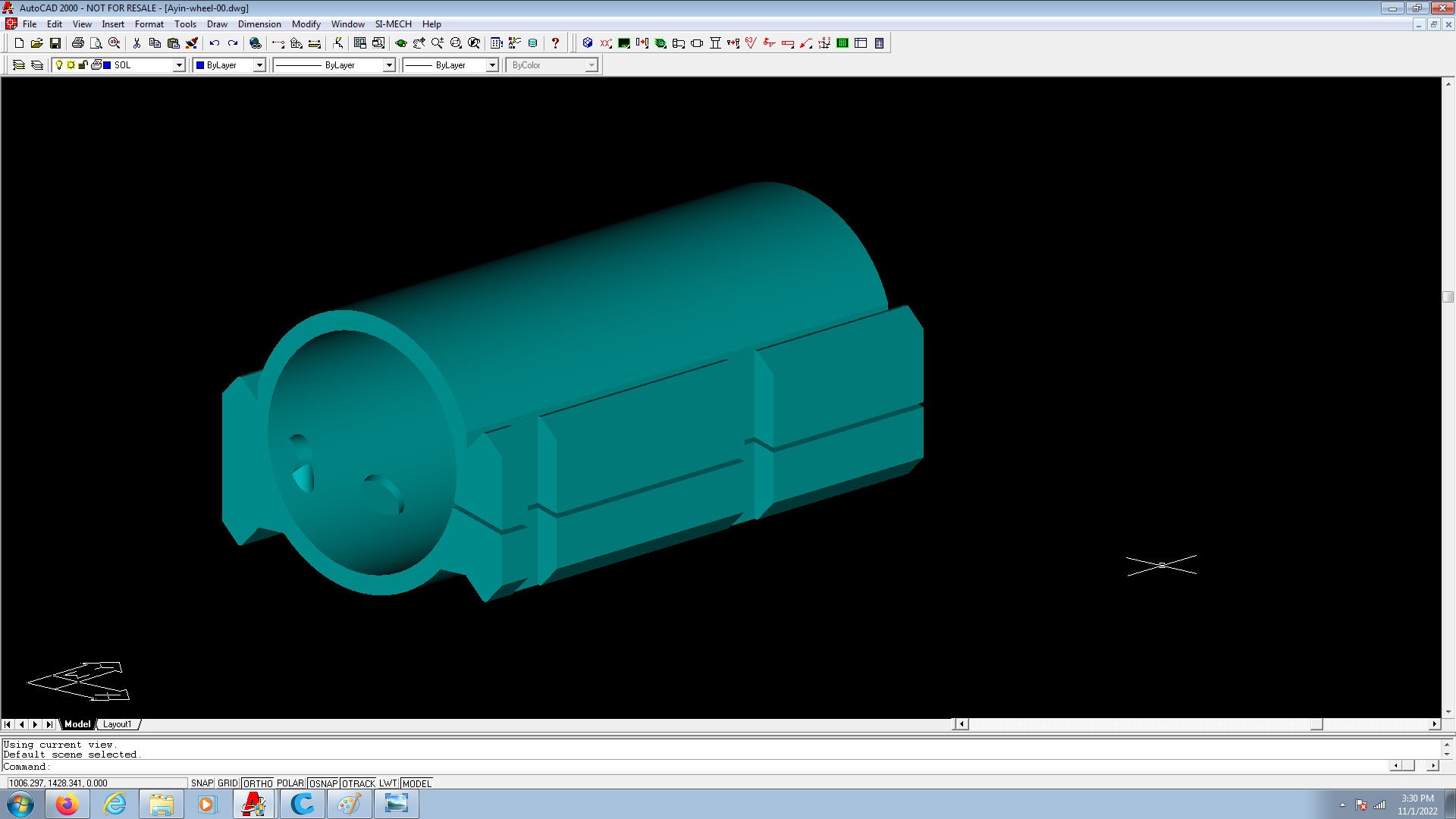

Model of clamp to be used in conjunction with (2) UTG MT-RSX5L:
3D printed ABS clamp slips over shroud:
UTG rails mounted tight on both sides.

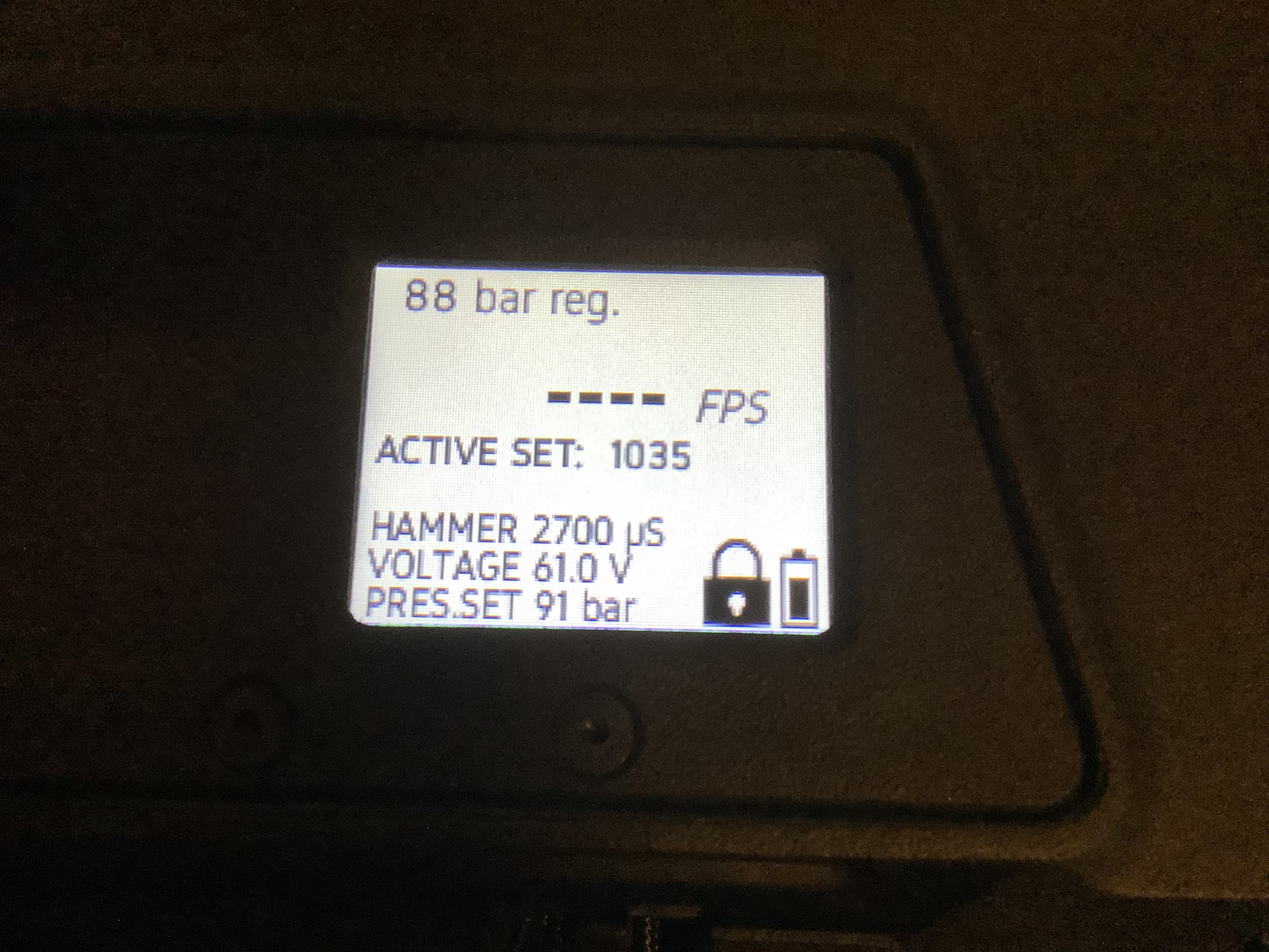

I shoot field target and had a real hard time getting the DW to shoot consistently. I was advised to try 13.4 grain pellets and suddenly the DW turned from a scatter gun to a consistent rifle. Shooting at the same speed as I do my USFT the trajectory is all but identical. I use identical scopes on both…
Here is my program which gets me about 805-810 fps
