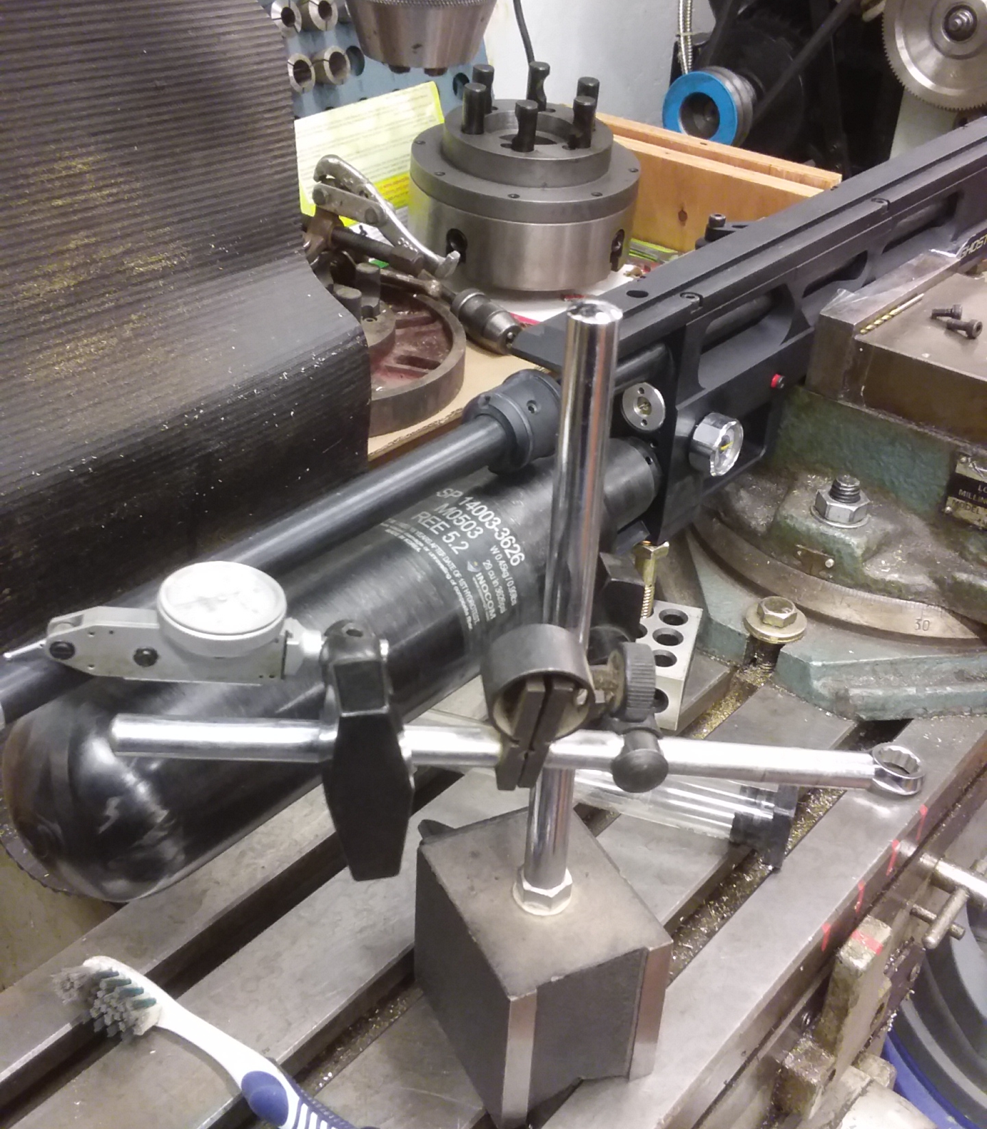

Ok... this is not how I REALLY wanted to spend several hours but Scott's problem and solution has me concerned.
So it took quite a bit of trial and error to achieve a setup that had no error itself. This is what it looks like.
Note the support under the front of the frame... couldn't or wouldn't squeeze it tight enough in the vise to keep deflection and return to zero issues with the FRAME 🤔
So the net result was 0.0005 of rtz error up or down with about 0.010 of deflection in each test. The barrel protrudes 11" from the frame where I was measuring. If my attempt at remembering trig was correct, that yielded 0.15 moa of potential error which is less than a 22 pellet size at 100 yds. That was with the factory oring front support.

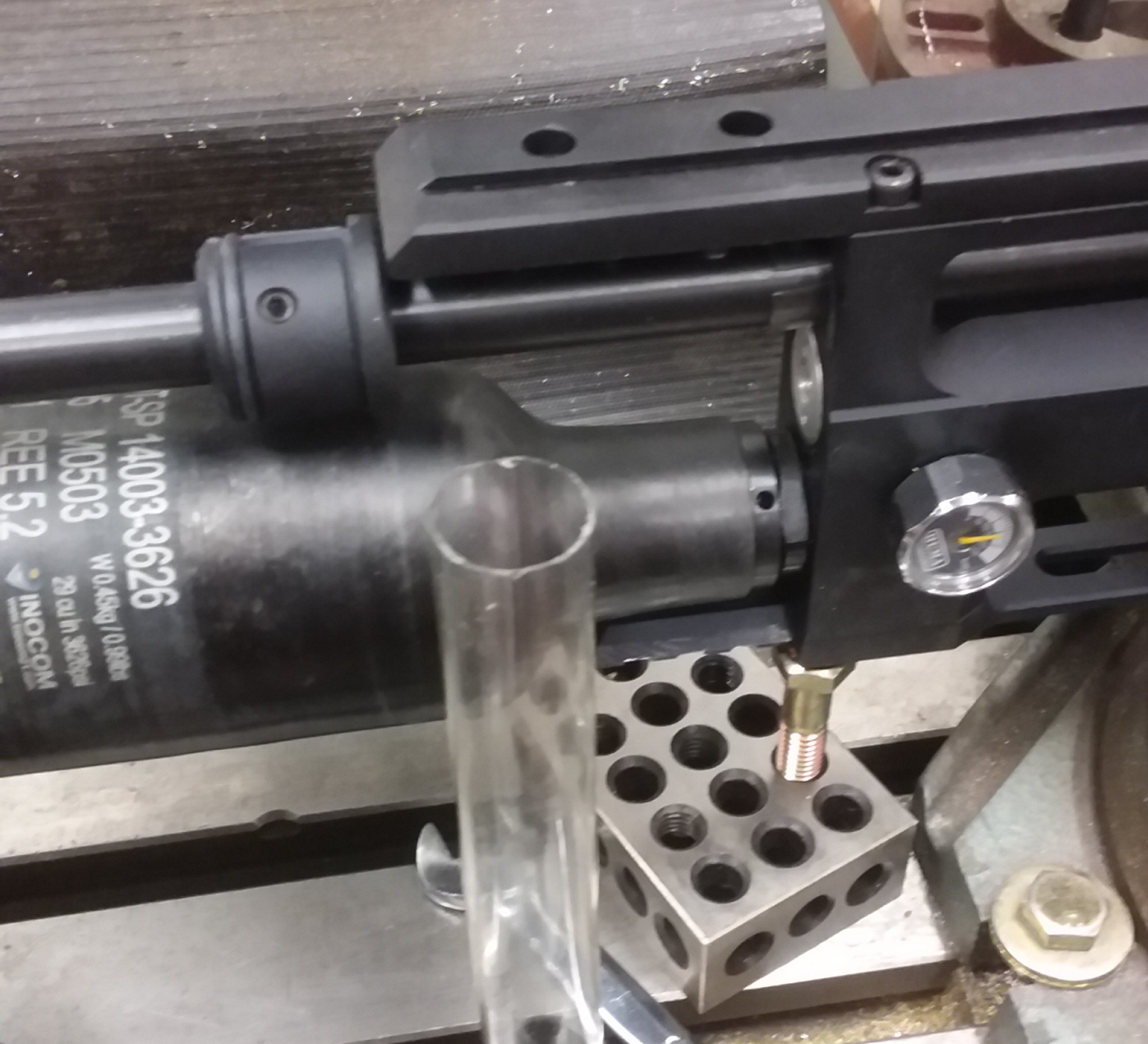

In this second pic, note the plastic shim protruding from the frame where the barrel is. I measured an 0.042" difference in size between the hole in the frame and barrel diameter. I found the tube in the pic to be 0.0205 thick and cut a piece to fit between the barrel and frame. It was tight getting the barrel in.
I tested 3 times with and without the shim and the results were pretty consistent. It was zero rtz error with the shim and 0.0005 without it.

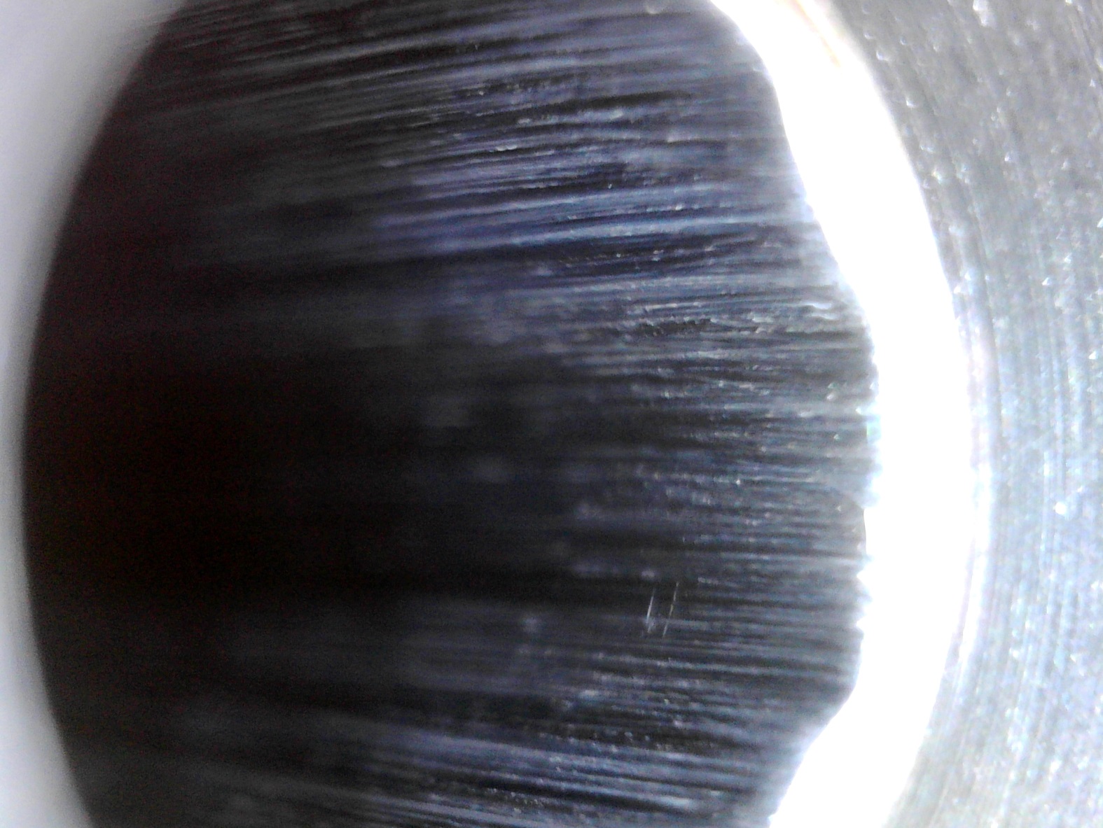

Brand new Daystate Delta Wolf HP. Just had it a week and have been searching for a pellet that it likes. No such thing. Tried 5 pellets and one slug and speeds from 750 to 1050. Best group is about 1" at 30 yards. Clearly there is a big problem . This is just a small sample of the testing. In a word its useless. Got a USB microscope on the barrel and you see the pic below. Match Grade LW, really? Please don't suggest this or that pellet or a different speed. This thing has a problem. Shop ignored my email and Daystate on summer break. Extremely frustrating. I expect the shop will want to send it away for 2 months and come back the same.

i'm betting your shroud is tweaked and some very slight clipping? or?
