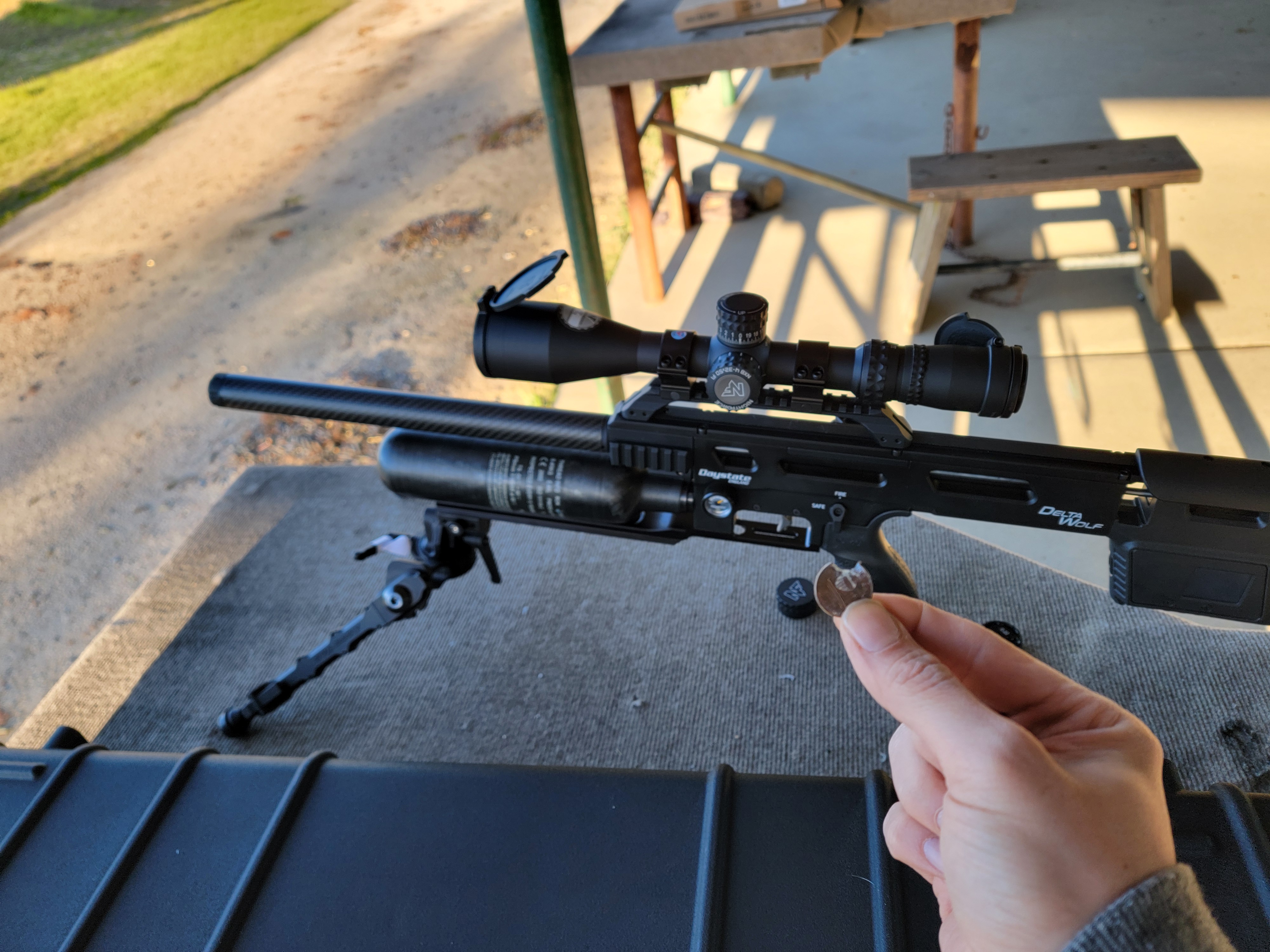

My first day at range with 22Cal Delta wolf with new Ultra valve was amazing I hit a penny at 145 yard! I want use some slug with it too anyone have any suggestion about which slug
should be better?. Today I was using JSB 25,39gr. Compare to my 25 Cal FX m3 was a little loader, but I think more accurate.
