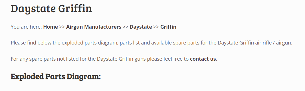

I was hoping for an actual Griffin parts list that may have numbers/ID for parts specific to the Griffin model. Just in case. In the future.
Some areas of the Griffin don't appear to match the Huntsman diagrams above to me. I could be wrong again.
The B & K website has a heading for a Griffin parts diagram, but there is no link there to click on. Just blank page. Tried that last week.

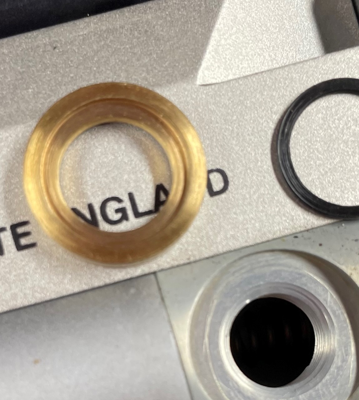

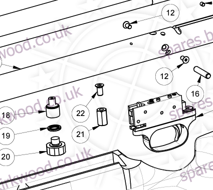

Their (B&K's) Huntsman diagram appears to show the air gauge installing into the bottom of the gun and the spacer between the air gauge and gun body appears totally different than mine in their picture. That is what's confusing me a little right now with my current problem.
My spacer is about as thick as a nickel and has an o-ring seat cut into it and an o-ring on both sides of it. WAY thinner than their part #18,
if that's the Huntsman spacer with what appears to be only one o-ring, part #19. Maybe the dark black circle on top of #18 is an o-ring? Don't know.
