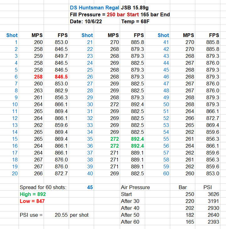

My Huntsman is a Regal with 250 bar fill pressure- its less than a year old. It shoots JSB 15.89 at 885fps very well for 60 shots with a spread of 45fps.

I had a Huma reg installed in a Huntsman several years ago, without an additional plenum. I believe it was tuned to shoot in the velocity range you want, but it's been several years, and I no longer have the rifle. My current Revere has the factory installed Huma reg, and it shoots the 16 grain around 880 I think, and again, no additional plenum. Its set point appears to be 160 on the gauge. The velocities and pressure indicated in your chart also show the production of that velocity at an ending pressure of 165 bar. Again, an indication that the rifle can do what you want without the additional plenum. There could be other advantages in having the larger plenum, but I have no experience with it.

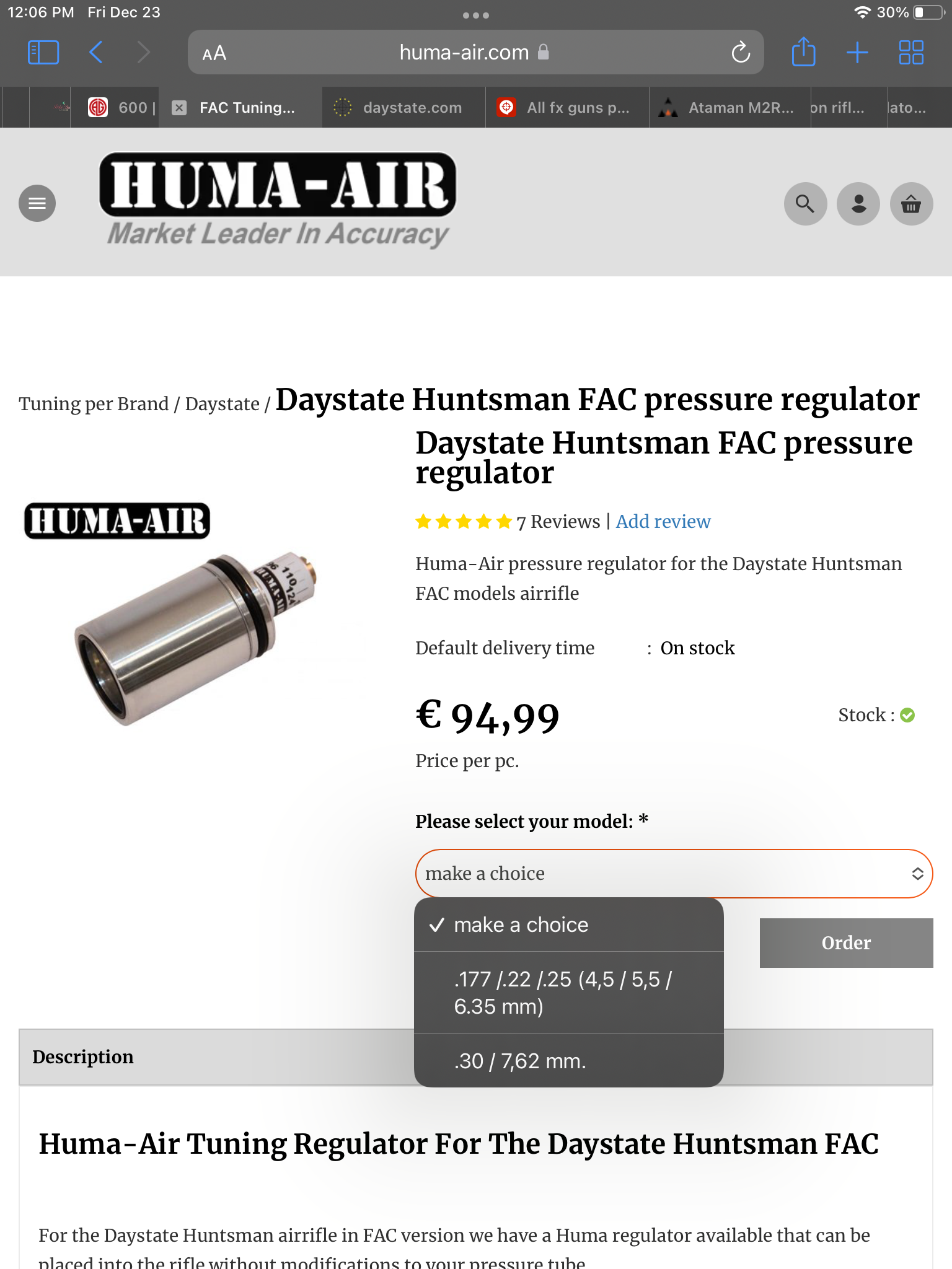

I just noticed, the Huma reg pictured is the short one, not the longer FAC model. Maybe that is causing confusion with reports of different experiences.
I ordered the FAC regulator for my Huntsman.
The picture shows what HUMA sent me - the reg with a plenum. There was an even larger plenum available, but I chose the “standard” FAC version.
-Ed
-Ed
If I'm reading the Huma site correctly, the "standard" reg in your picture is for 12 fpe rifles, not FAC. It's kind of confusing, but it might be worth reviewing. Maybe they are saying that the smaller standard reg, with the additional plenum, is preferable over the longer FAC reg alone?
This is exactly what I ordered and received from HUMA:

It makes sense that based on my chart, I will likely need the reg set to 155-160 bar to achieve 850+ fps - if I change nothing else on the rifle.
If shot count suffers with the reg, I may test how accurate the rifle is with the 15.89s at say 135 bar and hopefully about 800-820 fps. If accuracy stays the same as unregulated accuracy and I get increased shot count, then I may leave the regulator in. If accuracy suffers or shot count decreases, I’ll pull the reg out.
