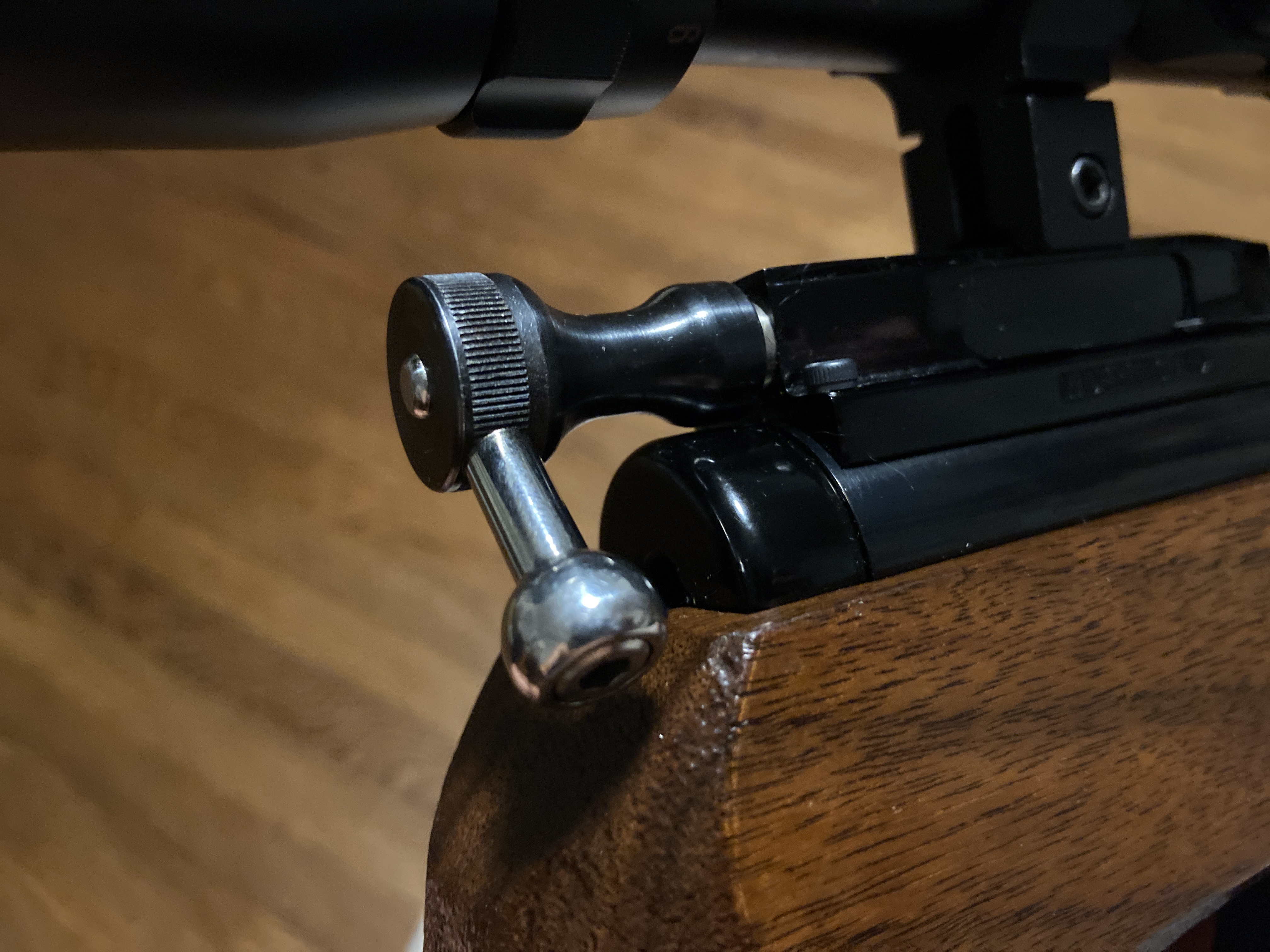

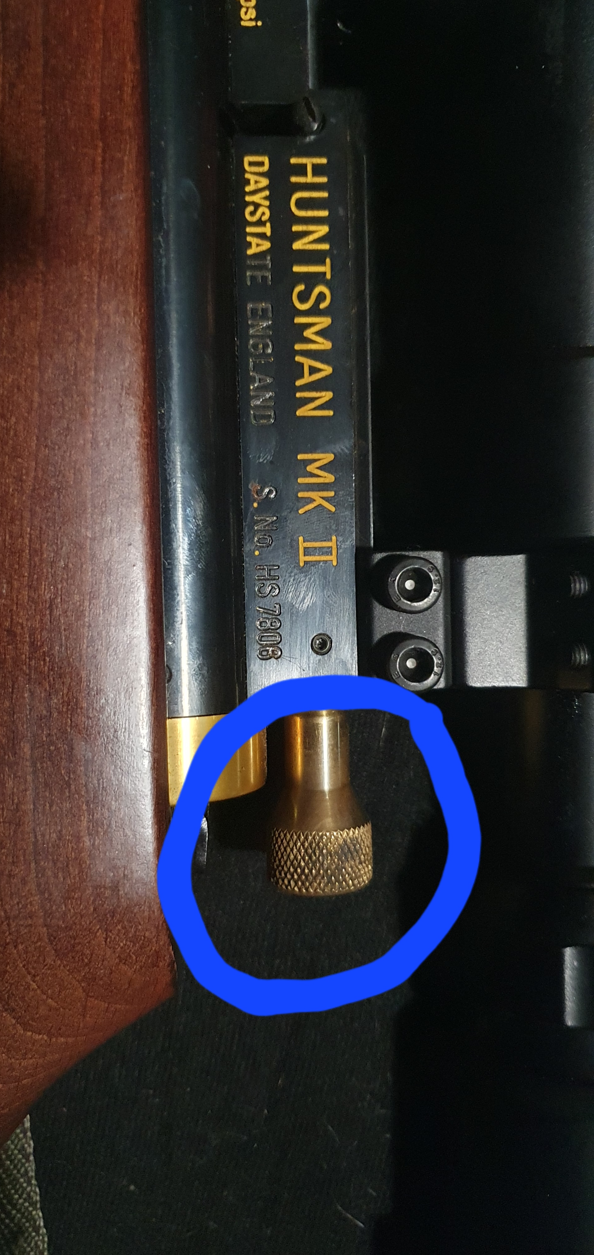

Could anyone help me please I have just got myself a huntsman mk2 and I was wondering if the part I have a ring around can be changed for less finger damage at all
Sorry for the wording I don't know best way of saying it .

Those are similar to the early Mk1 cocking handles. Might have been an aftermarket one or maybe an early MKII, although later MKIs had the swan neck handle.
You might be able to find a BAM51 handle or you could drill and tap it and insert a threaded handle. What’s the rest of the gun look like?
Thank you for the information. I have know idea about this at all would you know where I could get a replacement to at all ??
Can I get a magazine of sort for it ???
Not from Daystate. You could fit a grav mag. How is the cocking knob attached? Is there a grub screw on it?

No grub screw mine is a 1.77 and it's really good on shots to air as well I love mine
Havent seen anyone mention you should have a spring and ball bearing for the detent adjustment. Might well be goopy/worn.
Keep in mind it is similar (very, but!) to the LR90 and a couple of others. All of which came with both version cocking lugs, round (yours) and "swan neck", the parts diagrams will show this.
"I believe" (old memories) one the earlier models the pellet probe was hollow so whe closed air blow into the bottom of pellet probe then 90 dgree turn and behind the pellet. Then a change to a pin style probe (better for Crosman #2) . I am thinking for some reason your must have the correct bolt-not the hollow tube model- for the swan neck (Like on a Bam50 and maybe Mike Melick has one?) to fit. Maybe.
I have used the one you have, way back, wasnt bad cocking at all. Maybe just clean and polish and adjust detent?

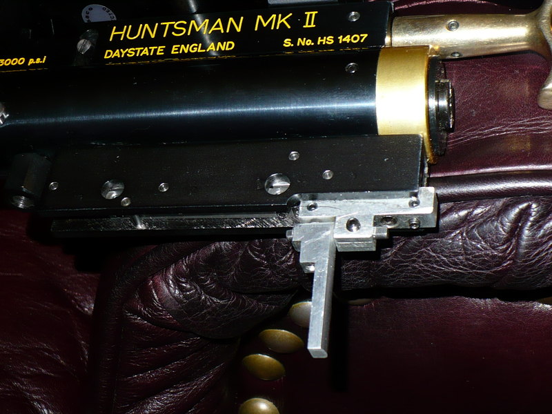

Does yours have this trigger?
John
No mines is a standard trigger I believe
