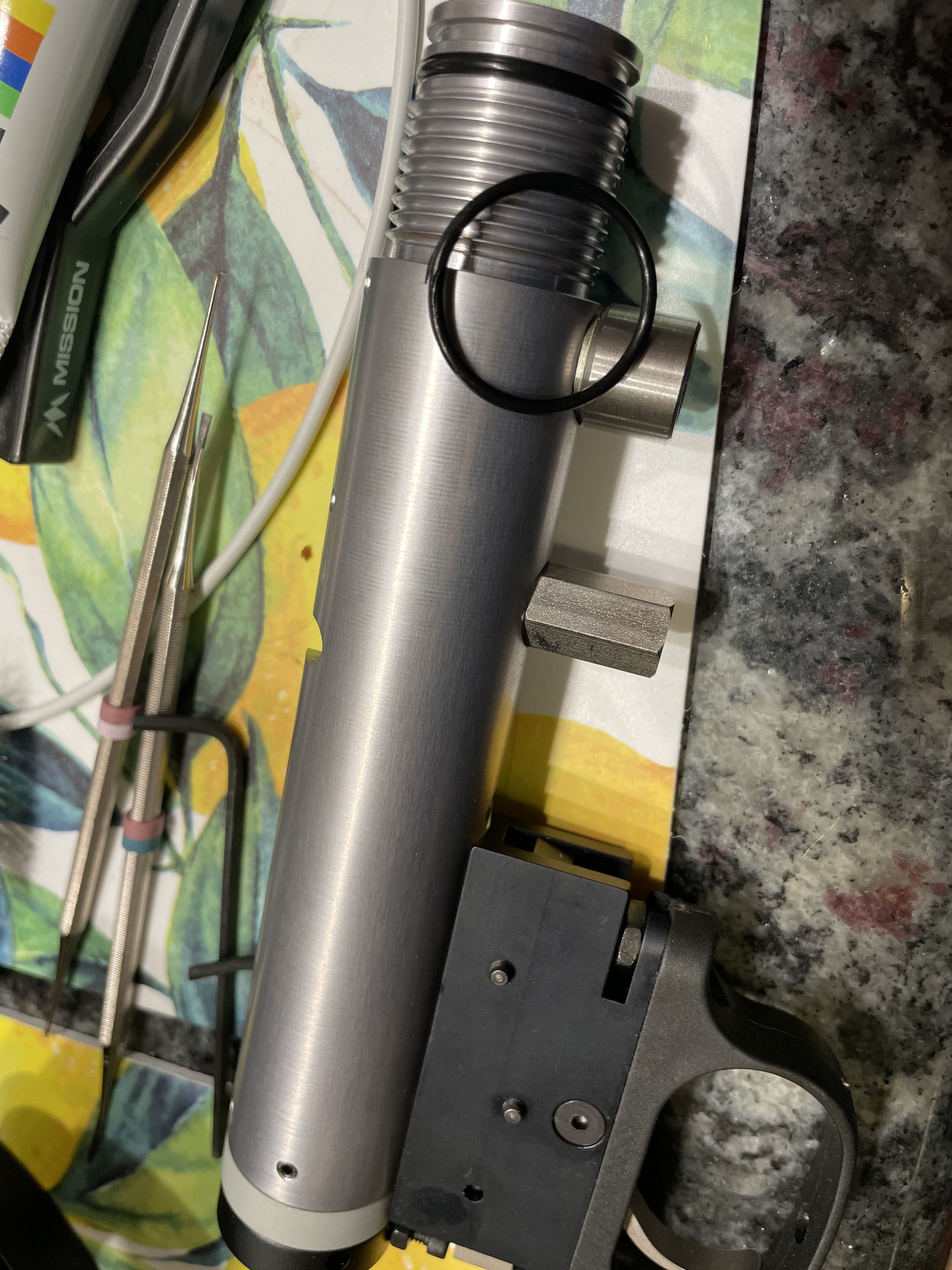

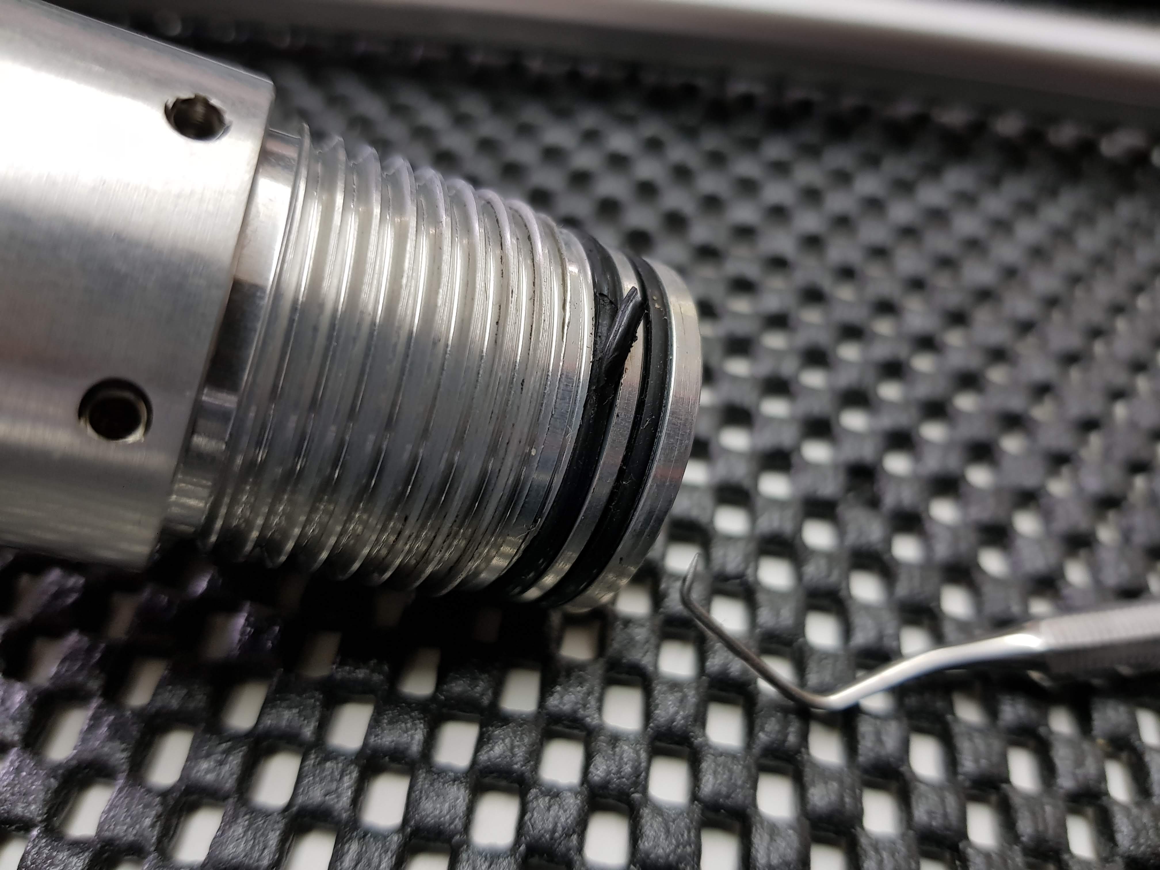

Daystate Huntsman Regal XL - about a year old. Slow leak - found the culprit - its a slice in o-ring (one of two) that seals air cylinder on valve body.
Does anyone know the size of the o-ring and where I can source a few from?
I appreciate your help in advance.
