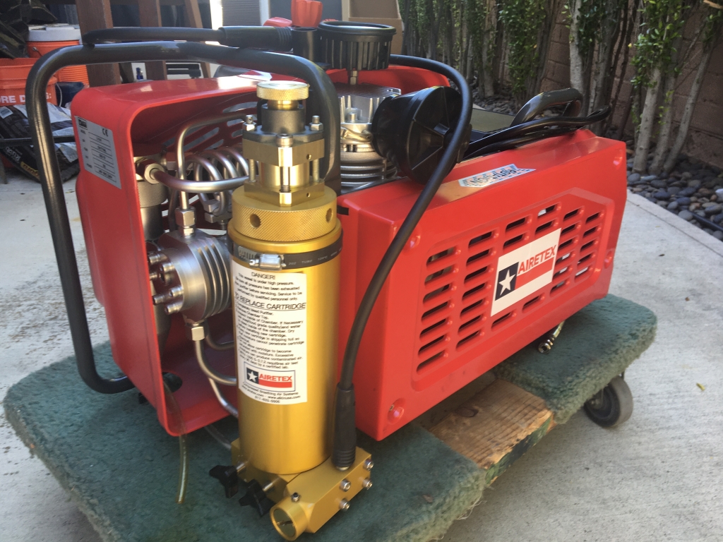

Centercut the reason I asked about Airtex was last week I called and asked if I could come up to their business and check out one of their machines. There only about 2.5 hrs from me. The lady that answered the phone said they had moved out of their commercial building and the owner was working out of his garage and didn’t know if he had anymore units for sale. She gave me a number for him but I have been unable to get a hold of him.

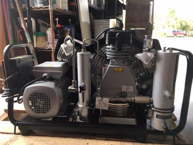

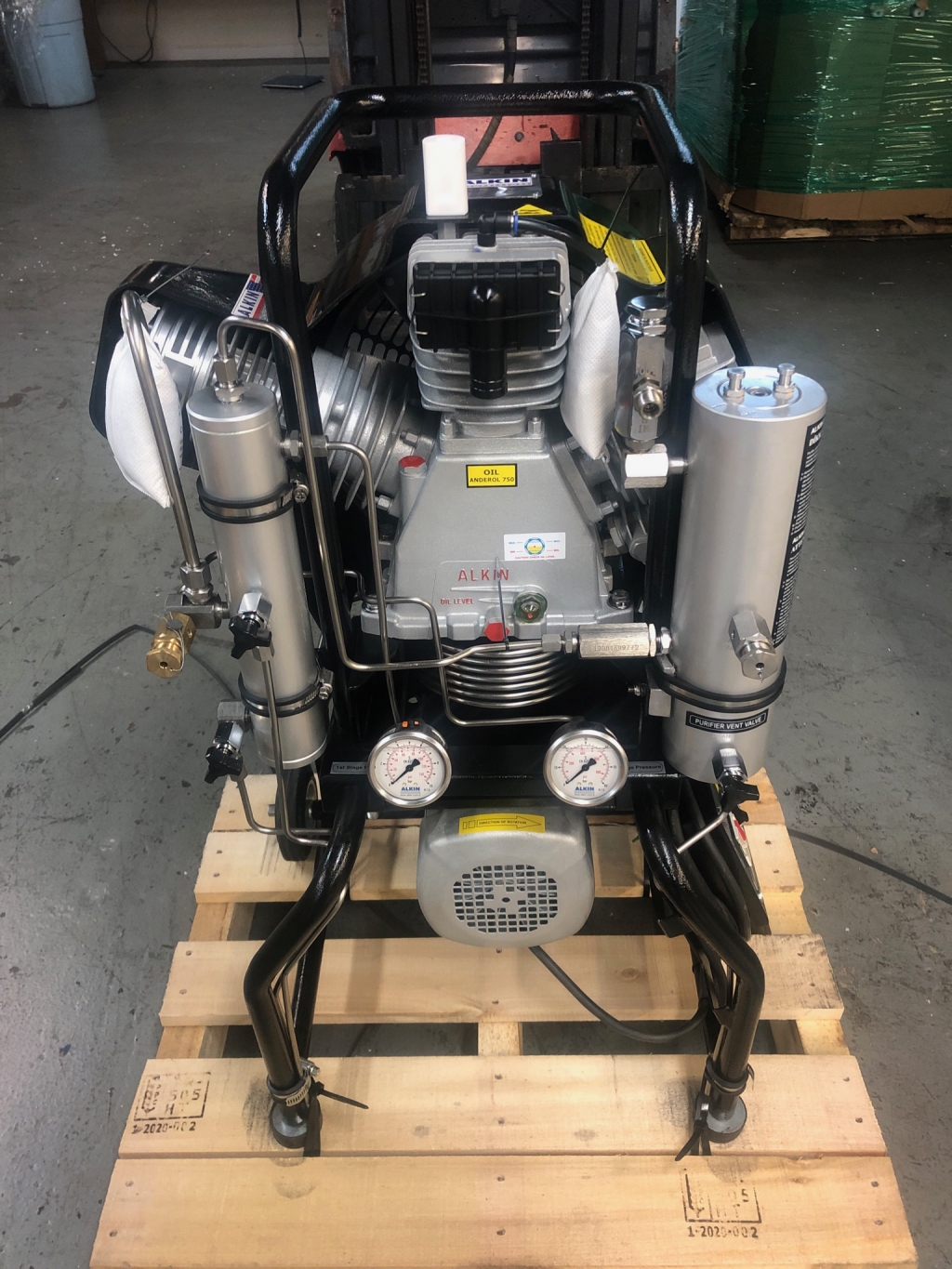

Their website says you can buy the vertical unit in 110. Do you think it's a typo?
Salesman told me no 110 option on the vertical. That’s what I was going to buy. Having and Electrician come out on Monday and put a 220 outlet in my garage.
also shows financing option on the website but that’s only if you spend 5000 or more.
ordered today and will be to my place in AZ on Monday the 1st
Hope this is just temporary. I didn't buy from Airetex but they were always willing to answer questions when I called them last year. Bruce Dodson seems like a straight shooter and I hope he manages to get things running again.
That's funny. I called them like 8 months ago and the guy on the phone said the vertical was available in 110. I have no idea if one has an advantage over the other. I just liked the way it looks and seems to take up less space. Any performance advantages you can think of over the horizontal?
Yea, no performance so to speak but I can roll it to where I need it. Salesman said the Vertical has a different motor than the horizontal now that’s why there’s no option for 110 on the vertical.
If at all possible, I’d go 220vac. Trying to go 30 amps with 110 vac is sketchy at best. Look at your breaker box. They are all 15 and 20 amps. With 220vac it’ll probably only draw 12 to 15 amps. So you can use 12 gage wire if you want to wire up an outlet. Plus since the motor isn’t drawing as many amps it should run cooler. IMHO
Yep, and I been meaning to put 220 outlets in my garage since I bought the house in 2018.. now it’s getting done.
